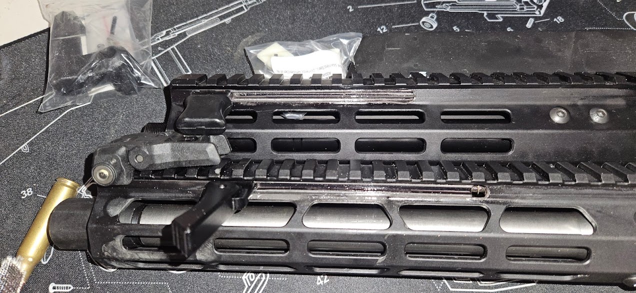

Got the BCA upper today.  my first side charger and its pretty cool. intrested how it will shoot in 556 11.5" barrel before i disassemble its for parts
did try and swap my existing 9mm RDB bolt into the side charge carrier and it does not fit. looks like ill need to open the hole where the gas rings go in order to fit the 9mm bolt

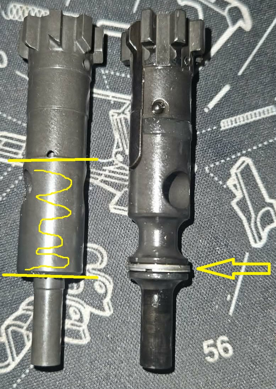

original plan was use the BearCreakArsenal 556 reciprocating upper and swap a CMMG 9mm RDB bolt into the carrier. found out pretty fast the CMMG bolt will not fit a standard carrier. I had to use a lathe to narrow a section of the CMMG bolt to fit inside the carrier. Then i had to use a carbide bit to enlargen the hole larger for the stem of the bolt so the spring the CMMG uses will fit.
https://i.postimg.cc/CLDNt9Zm/85df37bd-3f07-4687-b55e-00ff94fbb8fa.jpg
after that i thought i had it done and went to test cycle the upper to find the BCG basically locked solid. after mortar clearing it to open it, i realized that a fundemental flaw i overlooked was the cam pin track on the CMMG is very different than a standard AR15 BCG. it makes the bolt rotated too much where it cams the angled lugs of the CMMG. the standard AR bolt also extends further out and retracts further in than the CMMG

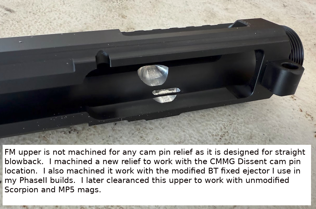

next attempt was using a FoxtrotMike 9mm upper front charger upper and convert it to RDB using the older plunger ejector. Even bought stuff to do a second front charger handguard on second PCC. As Anphibian warned me and had pictures of, the FM front charger handguard needs the charge lever slot extended when used with the RDB. cutting the slot longer didnt come out very pretty but it is functional.
there is a fine line cutting the slot too far and not enough. too far and the rail looses support and makes it have a bump as it realigns and makes it less smooth. too short and the bolt hold open wont activate. the first handguard i modified i went quite abit too far, the second one is right on the line of being perfect

i used a dremel to grind out a cam pin recess in the FM 9mm upper which actually wasnt very hard to do with a carbide bit.
everything was working fine so i took it to range and it was plauged with non stop ejection issues. basicly caould only get off 1-2 shots at a time before it would jam. i dont blame the plunger ejector for this, i blame the ejection port opening for this and i suspenct this is why people want to convert to fixed ejectors. i have never had issues with the ejection on my other 9mm or 45 RDB setups but this use full size ejection ports.
