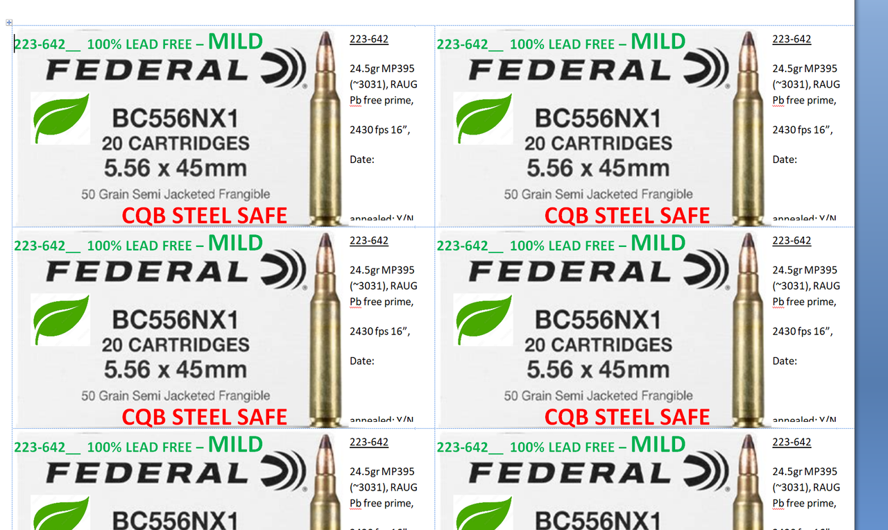

Anyway, love this gun.  Now that I have mastered a good Mk311 load,
(Need to fix that label, its that fps out of the 11.5)
and people can CQB shoot steel, it's now more popular than even the Stribog with the dates.  It's just FUN, with no recoil.  It's loud ,- thank God we have hearing protection.  Keep your supressors, everyone loves it as-is without a bulky supressor, because it's light and lean.
