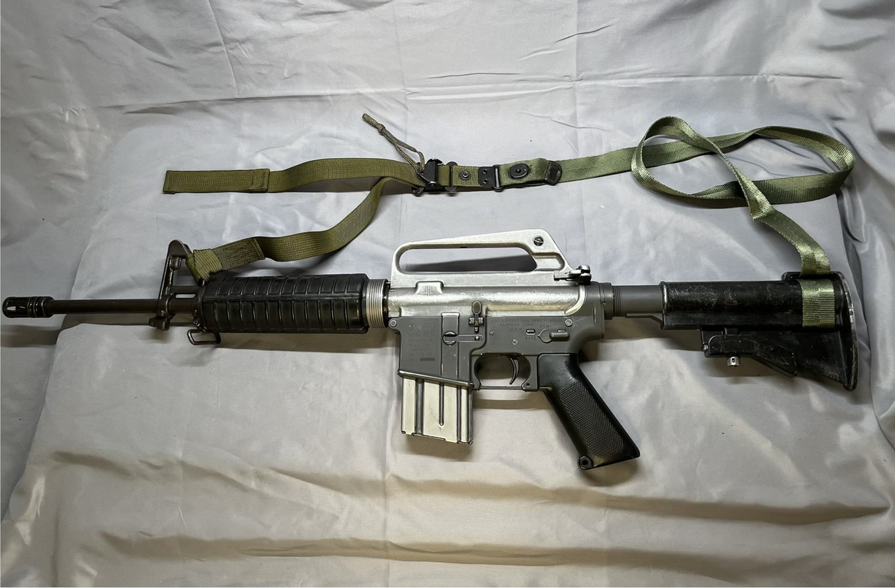

Originally Posted By mlin:
You think too much. Just simple Colt black silent nylon sling directly loop to front sight tower and N1 stock. Some use clip from USGI top sling mount kit at the front.
https://i.imgur.com/uyil41x.png
https://i.imgur.com/UwFRvHu.jpeghttps://i.imgur.com/irIaJY3.pnghttps://i.imgur.com/EPqMlph.jpeg
You’re not the first person to say that
I think what I’ll do since this will be more a shooter than conversation piece is just use a blue force gear sling loop on the FSB and call it a day…paracord on the rear stock as well. I totally forgot those existed until about 20 minutes ago
