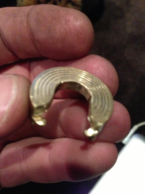

Has anyone tried the Lee FCD for 300 blackout to crimp 7.62x40 wt ?
5/1/2013 9:33:54 AM EDT
I dont think that would work wince the shell holder presses the piston to make the crimp.
5/1/2013 9:45:51 AM EDT
correct the blackout fcd won't work it is 5mm too short. the fcd's are collet type crimpers meaning they press on the shell holder to close the collet and are dependent on a fixed case height so they will only work for a specific
case length.
5/1/2013 9:19:38 PM EDT
Lee will make one for you....IIRC you only have to send them some fired brass.
advntrjnky
5/2/2013 4:28:51 AM EDT
I have been using the Lee 300 FCD, it works much better than the hornady crimp. The case presses up the collet, I have yet to crush a case, unlike the hornady die.
5/2/2013 5:55:46 AM EDT
That is what i was thinking the shell pushed up the collet. thanks
5/2/2013 9:20:53 PM EDT
since you guys were talking about this, I was brainstorming and found that, you could probably use a .338 bullet puller collet from an RCBS bullet puller die to make a crimp. Put the loaded round in the shell holder, push it up into the die far enough for the case mouth to go just inside the collet, tighten the handle, loosen it, retract and check your work....
5/3/2013 4:22:19 AM EDT
The rounds I crimped with the 300 FCD put the crimp about halfway down the neck, I'm not sure if thats a problem, I guess the worst is the case breaks there.  I made a adapter to test tonight, it will work for the single stage, it slips on the shell holder and has two tabs to keep it from rotating. I'm thinking I can make a similar version that attaches to the bottom of the die for the Dillion press.  There is enough room on the collet to put dimples on a collar and snap it on.
https://pbs.twimg.com/media/BJU6uuJCAAALs5K.jpg:small
