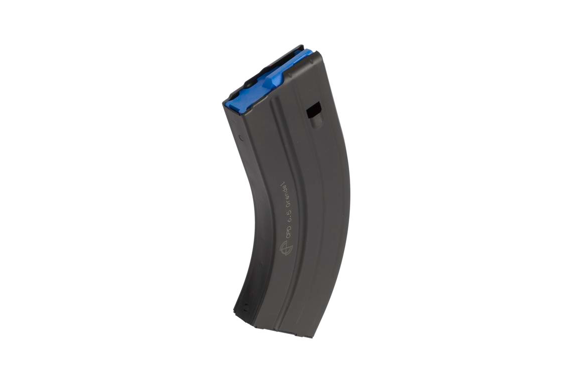

I'm new to 6.5G but started with CPD 28 round and Elander 17 round mags.
Both fed Wolf steel case without issue in a PSA 12" nitride upper. I've been running CPDs in 7.62x39 and Elanders in 5.56/.300bo for years, both have served well with CPDs being the best option for 7.62x39 IMHO. But the Elanders have a much heavier body and if they're working closely with Bill there should be no geometry issues. CPD is supposed to be bringing out a 20 round mag soon that looks to be the same length as my 20 round 7.62x39. I think I'll stick with Elanders from now on. FYI I've heard CPDs may have issues running when fully loaded to 28 rounds, I haven't confirmed that yet but when I bought mine from PSA they were listed as 26 round mags so I didn't go past 25 til they're broken in. |
