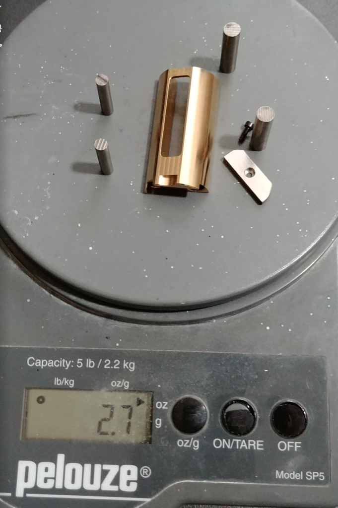

Another Arfcom thread that cost me money.  I ordered up the brass adjustable, along with a few other goodies.  I've been playing the AR15 22 LR conversion game for a ton of years now.  Yikes, maybe 2 decades now.  Looking forward to tinkering with it.  I run a couple of different kits, and way back when, I picked up the sear trip and anti-bounce weight that I have continued to use.  The ceiner weight most definitely helps with bounce, oob detonation and overall function.  Cool having some new manufacturers jump into this game.
I paid the premium for expedited shipping, as I have a week long ranch/shooting trip coming up next week.  Hope the gear makes it in time.  Then maybe I'll get off my duff, and find someone who can chop and thin a Keuhl 20" tack driver full profile barrel.

As on this morning, the adjustable weights are sold out.  Gen 2 adjustable is currently being prototyped, more standard stainless should be available next week.
What changes do you expect for the Gen 2 adjustable version?
6/27/2020 5:08:14 PM EDT
Gen 2 has a redesigned back plate with the wear surface integrated for easy replacement if it wears after x number of thousands of rounds (for the hopeless rimfire addicts out there!) as well as a slightly longer (0.025" longer) internal cavities for a bit internal sliding for bounce damping.  We are also planning at this point to ship with several sets of weights of different materials for nearly infinite tuning while retaining the internal hammer effect.  Before you had to remove some or all weights to lighten the weight to cycle in short barrels or with low-powered ammo.

I wanted to give a range report on the stainless steel bolt weight. I have in installed in my pistol with a 4.5" barrel. The bolt and barrel are both from CMMG and I'm using standard AR parts in the lower. I am using a Kak Micro Sim Flat Can. I shot CCI AR Tactical, CCI Mini Mags, and CCI standard velocity.
I had issues with the bolt weight and shooting the CCI Standard. Either the bolt would go back just far enough to eject the spent case and feed the next but it would not go back far enough to reset the trigger. The other MAJOR problem was that the pistol would sometimes double while using CCI Standard. I know it is due to the bolt weight since I just shot the pistol the other day with CCI standard and it functioned just fine before adding the bolt weight. The stainless steel is definitely too heavy for standard velocity ammo and a 4.5" barrel.
I did notice a difference with the AR Tactical and Mini Mags. They shot/functioned just fine and there was less noticed recoil and the gun felt smoother compared to no buffer weight.
My final thought: I'll stick with running high velocity ammo in this pistol with the bolt weight since it worked fine with that combo. AS far as the trigger not resetting or getting doubles, maybe the stainless steel weight is too much for the 4.5" barrel.

This is similar to a build I just finished.  Its a 4.5 inch barrel with a CMMG bolt/collar in a slick side upper.  I usually run standard velocity ammo through it and I don't have a suppressor yet.  Will this weight benefit me at all?  I do think I am going to get a set of the bolt buffers.
As you can see in my earlier post, the combination of the stainless steel weight and CCI Standard Velocity ammo did NOT work with a 4.5" barrel. High velocity CCI Mini Mags and CCI AT tactical ammo worked great in my 4.5" pistol with the Bore Buddy stainless weight.

Yes....http://www.c3junkie.com/?page_id=712
I think it is the fact that it is designed to have some gap for the internal tungsten weights to slide which allows it to work with various uppers in full auto.

Psst....the stainless steel adjustable weights are in stock.
7/22/2020 6:10:52 PM EDT
One less available
7/22/2020 9:10:17 PM EDT
https://i.imgur.com/41kVXE1.jpg?1
https://i.imgur.com/S5cn79H.jpg
Nice. Will you offer the premium reliability kit with the adjustable bolt as an option?
