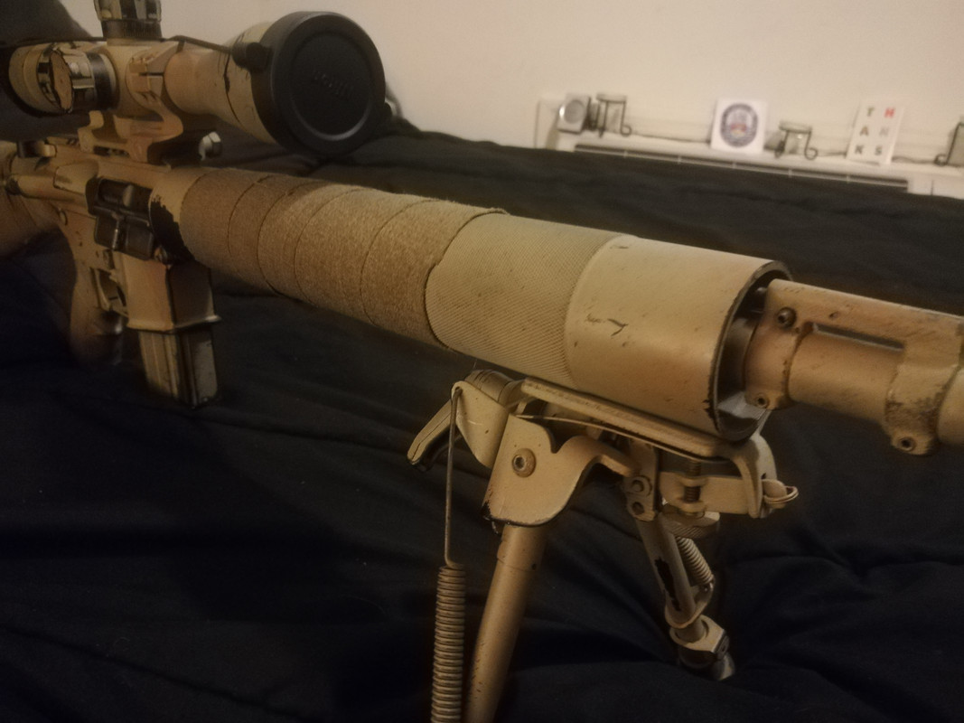

That looks awesome! What float tube did you use?
He lists it. Bushmaster vmatch

Wow i should learn to read better. Thanks.
6/9/2018 12:50:49 PM EDT
Yes, Bushmaster Vmatch. Its the one piece model that is basically a giant barrel nut.
6/9/2018 1:01:48 PM EDT
Do they still make that? I remember looking when I did mine and couldn't find anything new.

No. Couldn't find anything new. So I put a "WTB" ad up and scored one.

The float tube looks identical to Compass Lake Engineering's match rifle float tube. Accuracy Speaks sells a similar model, but his has a larger diameter than CLE's.
If yoy can't find it in CLE's website under "match rifle parts" call Frank White and ask if he still sells them.

The CLE tubes have a ring over the rear that wasn't there on the Bushampster V-Match tubes.  It also has a hand stop slot that would interfere with locating Weaver rail sections for the VFG and PAQ-4.

Too bad the knurling on the YHM is not continous. Otherwise, it might make a decent substitute.

That is the one I used/found.

FWIW. There are several available with a similar appearance to the ones from the 1990's on ebay. I can't vouch for the quality one way or the other. Search for; knurled free float handguard.

I used a real Colt 727/777 type barrel but if I had it to do over again, I wouldn't waste a good 727 barrel on one of these. The Bayo lug has the get chopped to clear.
I would use a SOCOM barrel that never had an FSB and have a new A2 FSB installed.
