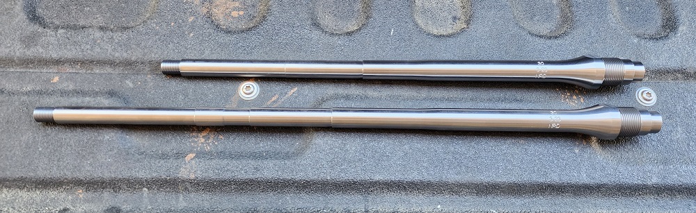

@GTLandser
A member over on Uzitalk that goes by JohnnyBfromAZ has some - he's asking $350 for the 20" ARM barrels.
https://i.postimg.cc/1XCHB5N7/20230429-162636.jpg
+1
I picked up one from him for my .308 build. It's a very, very nice barrel. They're short chambered so keep that in mind. I got it solely to take dimensions off of and keep it as a reference barrel, because as you noticed OP, there's almost no information about it online. The seller said that he used a NOS factory barrel to copy.

Originally Posted By AEnemaBay:
+1
What do we mean by short chambered? Sorry but I am only vaguely familiar with this kind of gun-smithing alchemy.
Does this mean I would need a 7.62 NATO finishing reamer or something, in order to ensure that my bolt (a TortOrt one supplied with the receiver), will close on my GO/NO-GO gauges?
