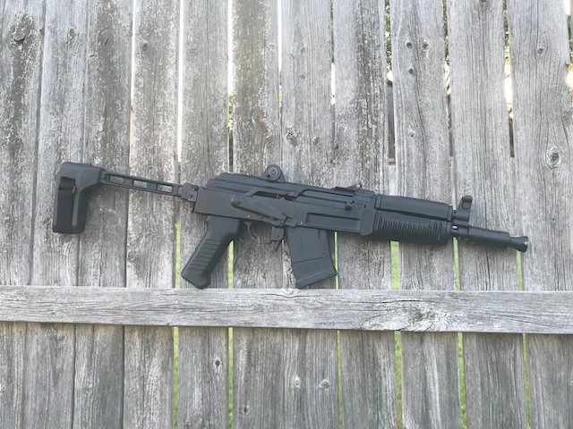

Ok, I know you are supposed to do all your studying BEFORE you buy something - but I just couldn't help it.  I mean I have a Sam7 and this thing came up for sale and it had the nifty SB Tactical folder, and it's milled, and it looks like a Krink that I've never owned, and well it's an Arsenal..and did I say It was milled?  Anyways at $850 I just couldn't help myself.

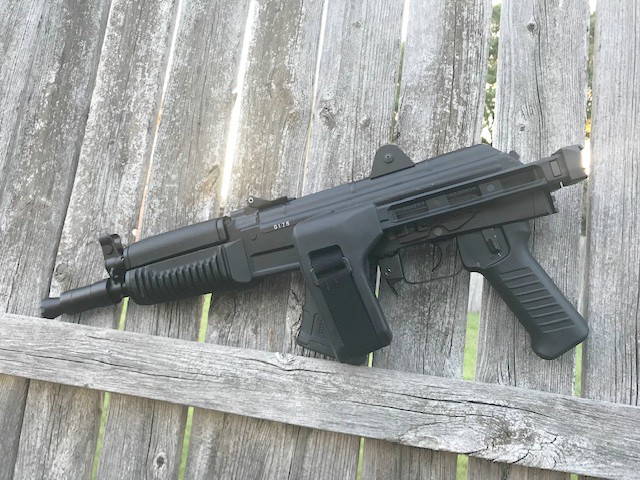

I've since learned of course that it's a SAM7K-04.  It had the rear swivel end plate replaced with a picatinny one and now sports the SB Tactical folder.  I know some people change out the grip, but I'm happy enough with it as well as the safety lever that is similar to the IWI Galil Ace I own.  I do not plan to SBR it as I'm fine with the folding brace.

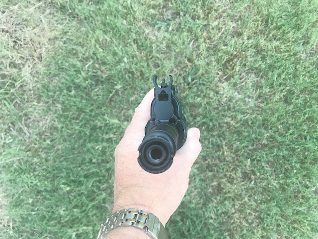

It's not the newer threaded barrel variety but has the Krink type fake hider that ends flush with the barrel.  I know the gas block on it is a Bulgarian one like with the SAM7 so no standard Krink device if I were to remove what's on there now - not to mention I know the barrel is longer than it should be.
What are the options for:
1) shortening and threading the existing barrel to use a device, can I get a flash hider that looks like the Krink?  Any photos would be appreciated.
2) can the existing Gas Block be used with any devices if the barrel is shortened and threaded?  If not, what do most replace theirs with and where do you get it?
3) Oh and not barrel related really but what reasonable priced mount and red dot works well with this thing?  I read somewhere that the placement of the rear sight can interfere with mount/optic on the pistol.  Too bad it doesn't come off like the one on the Galil Ace.
I am probably going to get a Trash Panda for a 300 BO Q Dream Weasel I have so may end up using that on here too if I do.
Thanks,
Earl

Mine started out like yours.  I measured and the barrel by itself is too thin to thread with any sort of standard thread pitch.  Its a bit thicker under the gas block.  So, supposedly, you can machine off the front half of the gas block and then where the barrel is thicker, you can thread it for 5/8-24.
I did my the right (more expensive) way.  Ordered the correct threaded gas block from kvar and had turbothis @ mygunsnorthwest swap it out and chop the barrel back.  Total cost including shipping was $282.  Thats $122 for the gas block from kvar.  The rest was shipping the gun across the country with insurance and paying turbothis for the work.

Buy a Bulgarian threaded FSB, 24mm. Swap FSBs, cut bbl back to be flush with the face of the FSB, and done. The threads that used to be on the FSB were milled off (for no real reason, the Bulgarians just decided to do it, they learned their lesson from slow sales) and as a result there isn't enough meat to add threads to the factory one. Gotta swap it.

That is exactly what I did, just swap it out and chop it.
