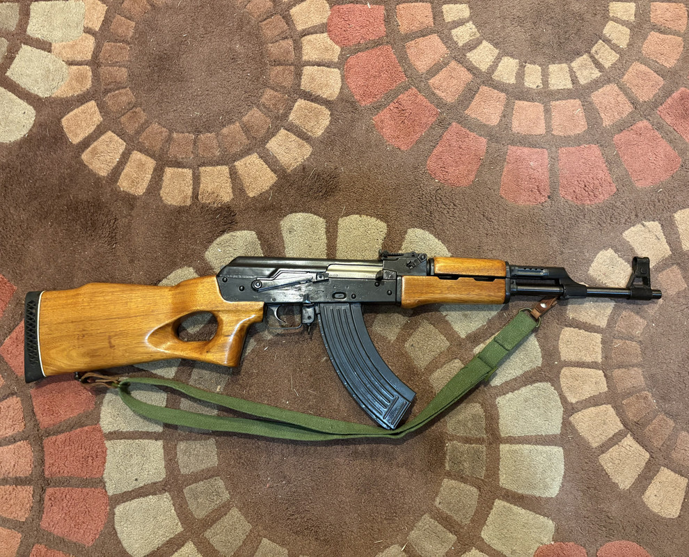

Hey guys I just picked up a square back receiver Mak-90 and I was thinking about replacing the stock with a Bakelite side folding kit. Would like to keep the trigger since it's nice. May also want to install a spiker also. That or maybe replace the front sight base and handguard retainer to mount a bayonet and cleaning rod. Thread barrel for a flash hider. Anything I'm forgetting? To stay 922R compliant what would you all recommend?

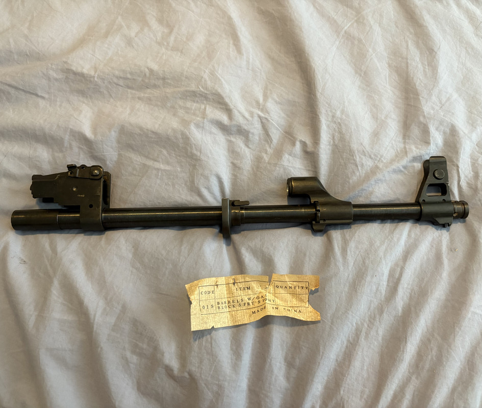

Ended up finding a Polytech barrel front end. So now I'm thinking to thread the Mak-90 barrel and swap out the hand guard retainer, gas block, and front sight. Oddly enough this Polytech front sight has open ears and not an enclosed circle. Must be an early version like the Legend.
That or I could swap out the complete barrel and drill the gas part. I guess if you swap the barrel you'd have to headspace it.

Yes and before anything - check both barrel diameters to make sure they are identical. You need to find a real Ak gunsmith. I think you’re going to spend more than just selling and buying a preban Norinco.

Yeah true it's a fairly costly project. Unfortunately the prices on the pre-bans are crazy high these days. Checked the barrels have an identical diameter so we are good there. Got the Bakelite furniture kit in today. It looks brand new.

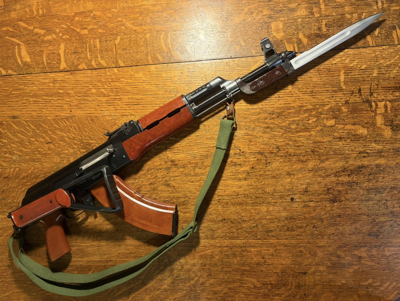

Finally finished this project with help from a fantastic local AK smith Iron Curtain.

Bought a cheap bayonet online, however it wouldn't fit this Chinese gun. I think the thicker Chinese barrel was the cause for this. So a little Dremel action and now it fits!!
