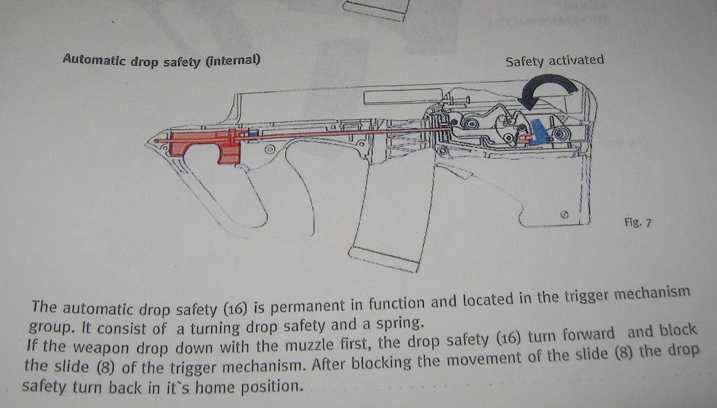

A crude and simplified drawing of what I'm talking about:

I have a factory diagram that explains this feature.
No scanner, deal with the curved page.
mcantu  [Member]
i had this same question a few years ago when i noticed that the hammer would release if the AUG was dropped butt first. it turns out that the 'drop safety' only prevents firing when dropped muzzle first

lazyengineer  [Member]
So let me get this straight, if you drop the rifle nose down, the 8# trigger could still go off without this component (while no one elses trigger design does). But if you drop it with the muzzle pointed to your face, then the hammer could release...? Am I hearing that right?
