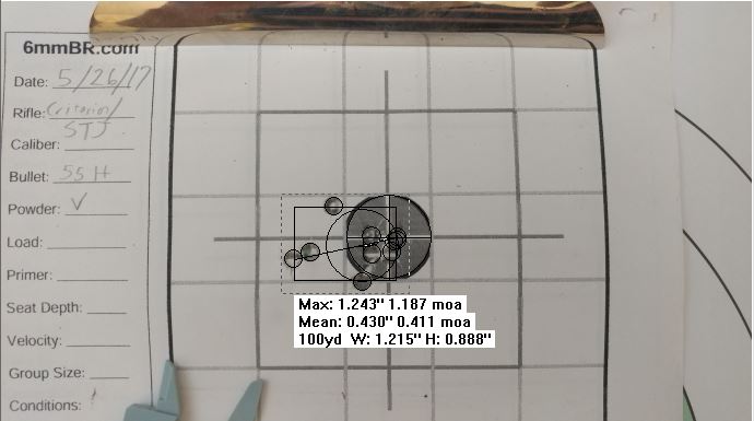

I am currently in possession of a Criterion Hybrid Barrel that has been straight jacketed by teludyne tech.
The product is a very interesting piece of kit. For those unfamiliar with the item:
The Straight Jacket system was applied over a criterion chrome lined hybrid profile barrel. The barrel is turned down to a pencil profile and then a sleeve and media was put between the sleeve and the barrel. This media is claimed to wick heat away from the thin steel barrel and extend barrel life by keeping the steel cooler. A typical test TT asks a shooter to do is to put their finger in the chamber. Indeed I was able to put my pinky finger in the chamber after a 40 round string.
Supposedly, it is 600% IIRC stiffer than a conventional barrel and offers around 7x the life of a conventional barrel IIRC.
I have a grouping which is interesting, but nothing conclusive at the moment. In short, I believe I am the weakest link in the barrels potential performance. Those flyers, If excluded, equate to a 7 round group of .62 MOA. As is necessary I included the data for the full 10 round group.
The load used is my reference load. 55 grain Hornady V Max with 25 grains of varget for 2900 fps and a sd of 9 fps.
The ridle currently sits with a fixed power 10x, but a 15x optic would have been nice for the testing, but I do not have such glass available at the moment. A machine rest would be ideal for additional testing.
The six round group above fits inside of a dime with room to spare. The whole ten round group with my outliers is still 1.1 moa.
The CEO literally said I could turn around and use this as a LMG type rifle, and then shoot it as a SPR without any change to the configuration. The barrel won't burn according to TT. Needless to say this will be the hardest thing to test as I don't have an unlimited supply of XM193 to test the claims of 7x the barrel life.
Cal Zant noted some interesting heat characteristics in Litz' modern advancments vol 2 and under FLIR it did indeed remain the coolest barrel tested. Cold to warm bore drift was also minimal.
Just wanted to share some early info on the kit. I am going to obtain a thermocouple and probe to measure heat in the bore and external to the bore and we will compare to a modern barrel.
Im writing up a full review on it, but i want additional data before publishing.
It truly intrigues me. This barrel is chrome lined with match accuracy and super extended barrel life according to TT.

So in Modern Advancements vol 2 Cal Zant interviewd Alan of Teludyne
What he said in a nutshell is that the bore in the throat and foreward of the throat begins to work harden from the heat, pressure, and friction while the material around the bore begins to slowly heat up and cool down resulting in a softening of the metal surrounding the bore. As the barrel heats up it is basically floating a work hardneden surface on a softer metal.
According to TT this is where accuracy degredation comes from.
I have no way of testing this mind you, because if their claims of 7x barrel life are true i dont have enough ammo to test it.
However, are their any tests you would like to see with the barrel from a precision standpoint?
I have been testing the barrel for a few weeks and now need some ideas about what the precision community wants to see.
I have about 800 rounds of 77 grain reloads, 200 xm193, another 400 rounds of 55 grain ammo vmax reloads (my test bullet) and a 10x optic.
I am going to get with a freind to borrow a higher magnification optic to really see what this product can do.
Of note one of my loads with varget was 30fps faster than when i last chronod it. From 2650 avg 10 shot string up in PA at around 65 degrees to 2680 here in south texas after the barrel was jacketed in 90 degree weather.
Is that a typical velocity swing for Varget? Same load. 24 grains of varget on a 75 grain HPBT cci primer.

I agree the price of entry isnt for everyone. However, if the claims of 7x the barrel life are true, how would that affect your perceived value?
Also note on a cold bore it was, however slight, the most accurate barrel tested.
Weight is also less than a heavy palma, but not quite as light as the carbon barrels.
So that aside... If i were to make a video of this barrel, how many rounds down the bore would you like to see before I then shoot it for groups again? What would you guys consider "torture" on a semi auto precision barrel? Right now its grouping pretty well.
I have no dog in this fight as far as emotional investment. Barrel cost me nothing but shipping. I am reviewing the product and would like some ideas from the precision community for additional testing.
Another company will be bore scoping the barrel at some point in the future. Criterion offered to evaluate it after testing. I am keeping a log of round count.
This should be fun.

Shot this ten rounder the other day.
My question is... What if the flyers are me? 8/10 rounds were one ragged hole.

I would like to see your groups with a 5.56mm match round pushing a 69 grain SMK or 77 grain SMK... My rifle in .308 is doing VERY well with FGMM, FGMM reloaded clones, and 165 grain SGK and SST with same powder charge.
Link Posted: 8/24/2017 8:40:50 AM EDT
Originally Posted By Knife_Sniper:
http://www.thenewrifleman.com/wp-content/uploads/2017/08/STJ-8-21-17-On-Target-Hornady-55-Gr-Vmax-with-cannelure-crimped.jpg
Is this factory ammo, why are they crimped?
What if they are what it shoots? What if they are you?
Doesn't really matter, still good.
Since you are shooting 10 round groups,  I  wouldn't concern myself with those two shots.
It make zero sense to analyze a 10 shot group based on only 20% of the shots. More groups will tell you more.
If 80-90% of your shots are .6moa everytime well that gives you a better idea of want you can expect.
A better way to judge a group if groups is to use average to center, that kind of eliminates a bad pull or bad round.
If I shoot a 1 moa 99 shot group and the 100th round make it 3moa that doesn't mean the system is 3moa, it's still 1moa.
... .Of course for bragging on the internet you have to go by extreme spread.

Its vmax with cannelure. I ordered the wrong component. I reloaded it to magazine length and accuracy was nothing like above. When i loaded it to the crimp, and crimped it... Accuracy was as above. Big improvment suprisingly.
I will do the federal gold medal match for a reference load.
I have shot this barrel lots. I have one more test before i publish my data but it appears to be immune to heat related precision degredation. Round 41-50 was still sub-moa with another round of hornady ELD match. No cooldown between groups.
Accuracy wise i beleive i am getting some POI shift, but i need another range trip to eval that.
