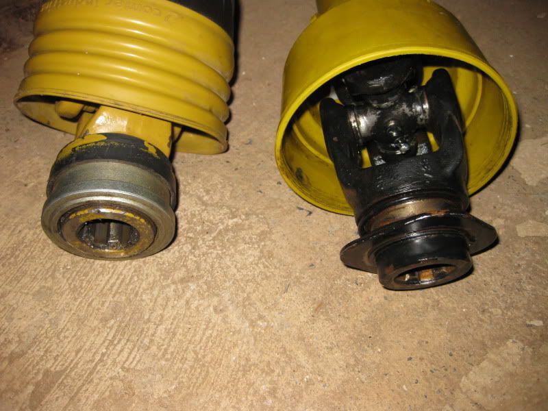

![]() Bought a new 5' Bush Hog. Can't get the God$%&* PTO shaft on. ![]() Cleaned it.....oiled it, greased it. Won't go on. Cleaned it again.......ball bearings in it are a little sticky but move. Won't go on. Separated the two halves of the shaft to deal with just the one side. Won't go on. Pulled the shaft off my tiller.....pops right on. ![]() Any advice? |

Feral, on one of my true "bush hog" brand items, you have to pull an outer ring back, then push the whole assembly forward to make the bearings retract into their little cavity to make the female end go on the shaft. REAL pain in the arse....The brand new stuff may be a little different... My problem is that the bearings aren't retracting when I pull the ring back. I can get the collar on to the shaft up until where the bearings hit. There's no "twist and lock" feature on the ring that you pull back.......you just have to pull the ring back while you slide the whole thing forward.......which I'm not having any luck doing. When I pull the lock collar back and try to manually move the bearings, they move but not far enough to open up the keyway fully. In any case, I'm gonna mess with it more this weekend. Talked to the dealer and he had no helpful advice except "keep trying." He did say "Yeah, I don't think I ever had that one hooked up to a tractor, maybe something's wrong with it." ![]() If I can't get it working properly this weekend, he can come out and fix it or I'll run the shaft into the dealer and see if they can get it working. PITA, but that's the way it goes sometimes. |

Feral, on one of my true "bush hog" brand items, you have to pull an outer ring back, then push the whole assembly forward to make the bearings retract into their little cavity to make the female end go on the shaft. REAL pain in the arse....The brand new stuff may be a little different... My problem is that the bearings aren't retracting when I pull the ring back. I can get the collar on to the shaft up until where the bearings hit. There's no "twist and lock" feature on the ring that you pull back.......you just have to pull the ring back while you slide the whole thing forward.......which I'm not having any luck doing. When I pull the lock collar back and try to manually move the bearings, they move but not far enough to open up the keyway fully. In any case, I'm gonna mess with it more this weekend. Talked to the dealer and he had no helpful advice except "keep trying." He did say "Yeah, I don't think I ever had that one hooked up to a tractor, maybe something's wrong with it." ![]() If I can't get it working properly this weekend, he can come out and fix it or I'll run the shaft into the dealer and see if they can get it working. PITA, but that's the way it goes sometimes. So are you saying the female end will slide onto the shaft until the ball bearings hit the shaft....or the ball bearings will clear the shaft, but it won't go far enough to lock on? Posted Via AR15.Com Mobile |
Feral, you may want to try having your assistant tap the end of the shaft with a wooden mallet while you retract the detents. If that doesn't help, I'd take the shaft back to the dealer and have his guy mount it on another tractor. The coupler may indeed be defective.
