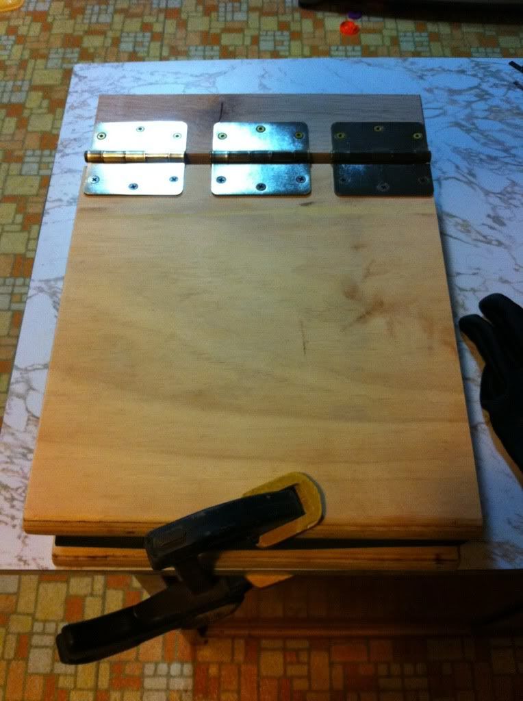

I work in telecommunications/structured cabling systems and I got tired of digging in my pocket for electrical tape, so I made this tonight.... http://i237.photobucket.com/albums/ff210/aberdrew13/2012-09-06191932-1.jpg ETA: there's slots in the back side for it to be put on a belt. lol thats fantastic! |

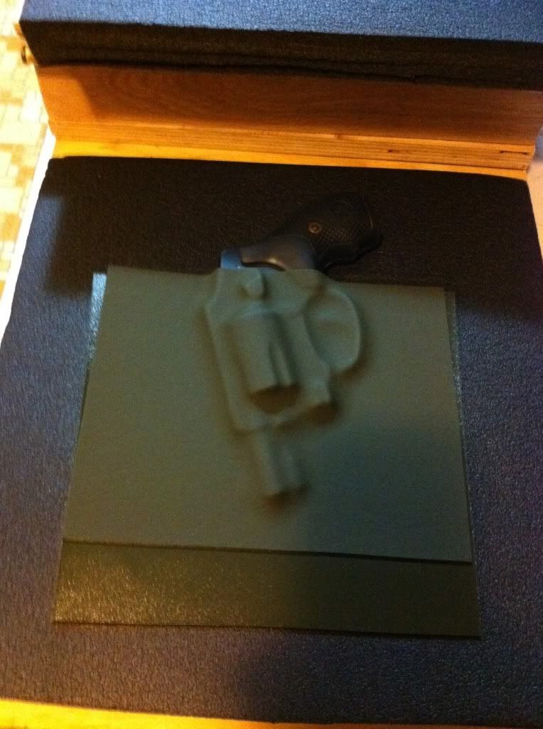

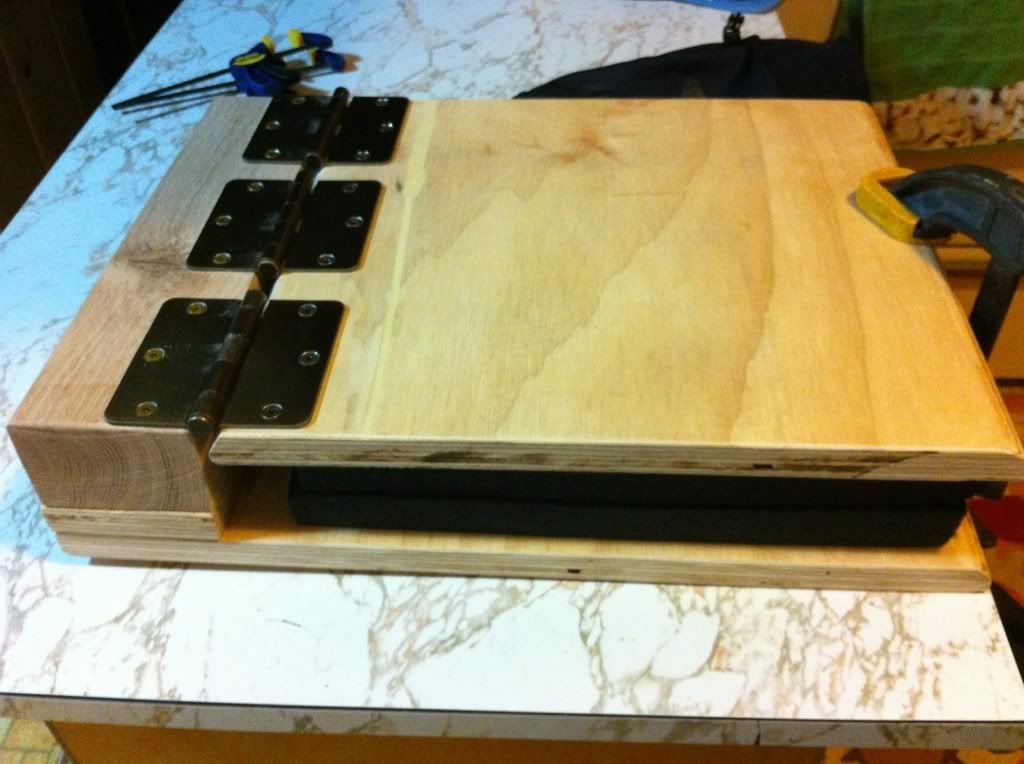

Originally Posted By wintermute76:

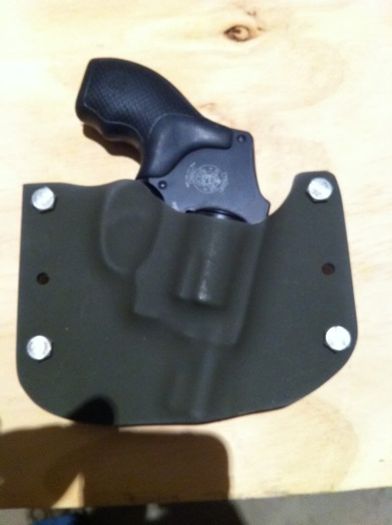

Got my press together tonight and whipped up my first. Any and all criticism and suggestions are welcome ![]() http://i25.photobucket.com/albums/c73/wintermute76/34DA9B80-544D-4E72-B3FA-3D31616E4673-424-0000004B21EE84A6.jpg http://i25.photobucket.com/albums/c73/wintermute76/DFBAD41F-F3D1-4F46-8473-F39DFC2FF216-424-0000004B31B7AEC0.jpg http://i25.photobucket.com/albums/c73/wintermute76/D03B1B30-D2B6-4336-A7B0-5B64E3076F46-424-0000004B391F12FE.jpg Press looks great and your getting perfect definition. |
Indeed, revolvers aren't always the easiest things to mold Kydex on. So good job. Looks perfect so far.
Depending on where you cut, and the intended draw angle, you might find you even have too much retention going on. ![]() |

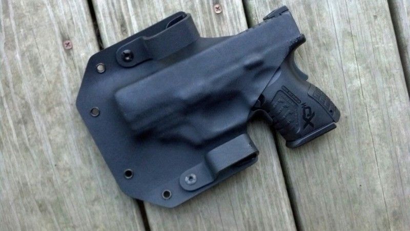

It's been awhile since I contributed to this thread. Glock 30, .08 kydex. http://www.hunt101.com/data/500/medium/image63.jpg http://www.hunt101.com/data/500/medium/image44.jpg that's perfect.....and exactly what I need to do. Well, a left handed version. I have been having trouble getting that kind of definition with the .080 |
You look like the most normal person on the planet, or a serial killer. I can't decide. Either way, rock on.- Dan_Gray

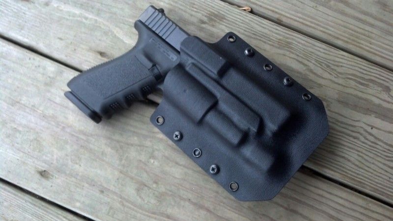

minimalist hoster for glock 22/23/27 for a coworker who teaches some classes on the weekends. hardware was changed out to black phillips head screws http://<a href=http://farm9.staticflickr.com/8332/8077608497_4721790cac_c.jpg</a> image_2 " /> Really dumb question but have you had any retention problems with loaded mags? The pic looks like it was formed on an empty - I think I'm seeing the follower. |
