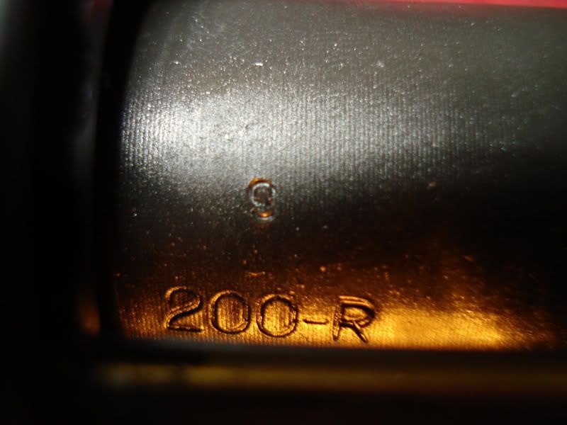

200-R is just an AR0200. The R is an inspector''s code.
The 200s (no CL) are regular chrome moly barrels. Steve/RRA |
