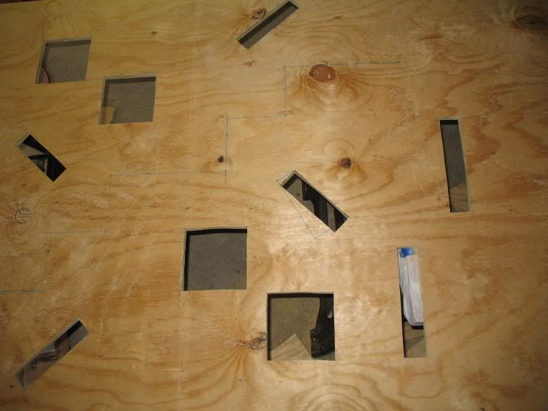

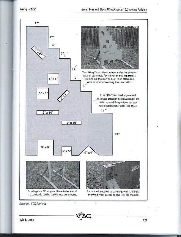

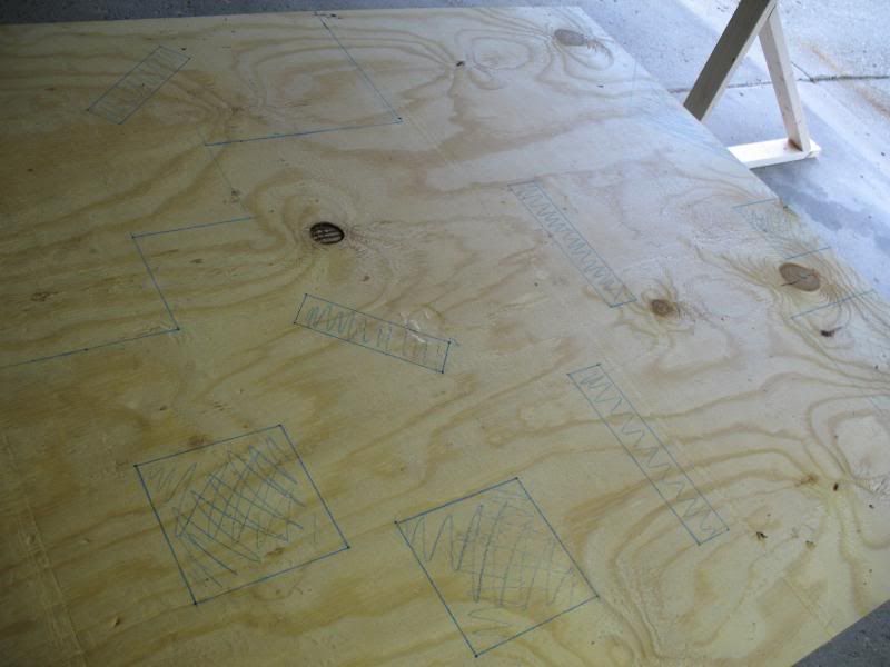

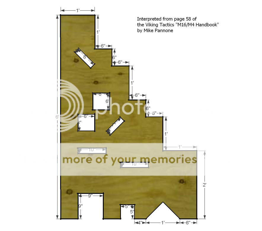

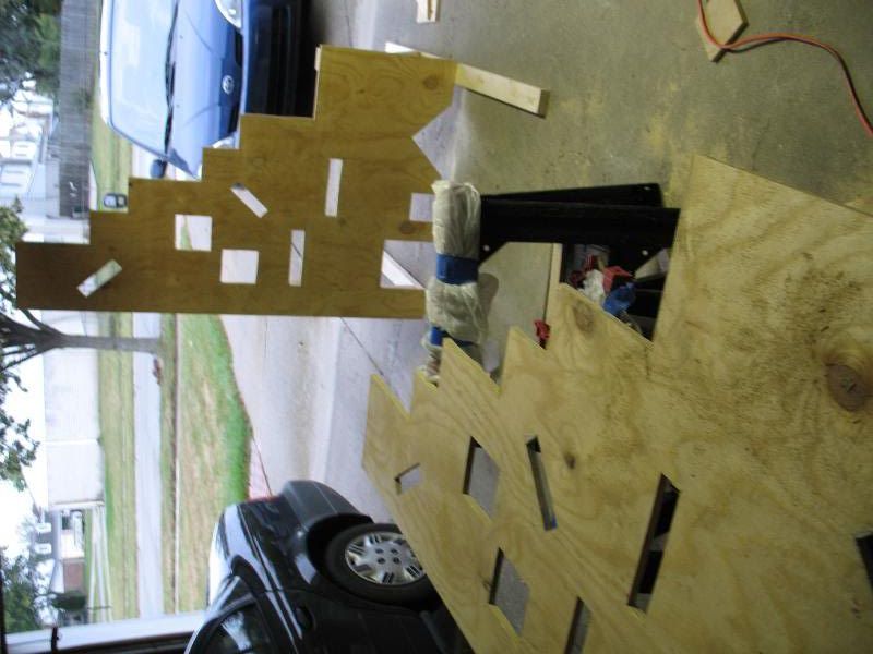

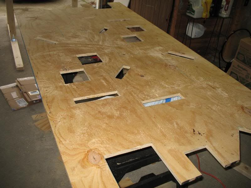

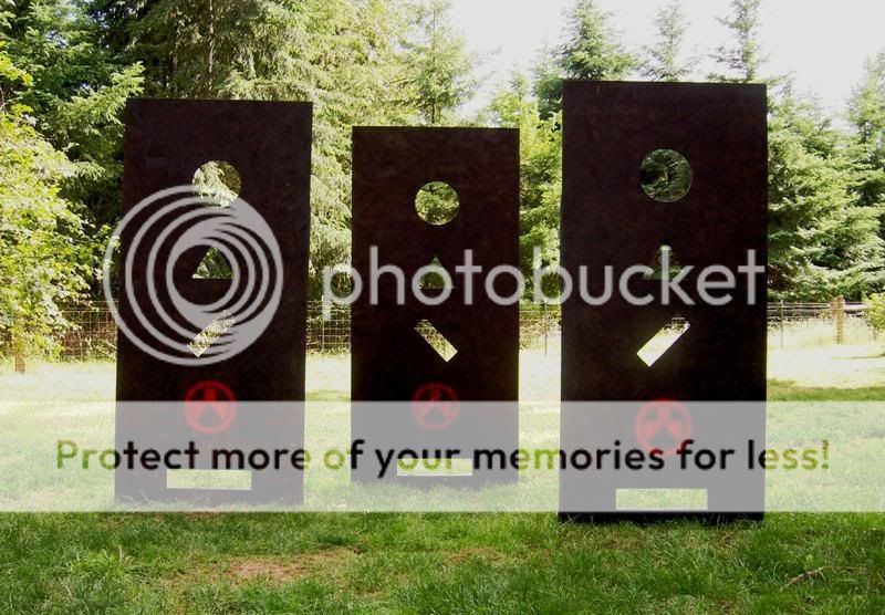

I need a diagram with instructions for building the multiple geometry/shoot through the holes barricades (like used in 3 gun competitions). CAn anyone help? Thanks in advance!
I have a young man working for me this summer and thought this would be a great tiumne to get some of these made. I guess plywood with outdoor enamel is the way to go?
