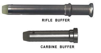

Hmm, my Stealth works fine with a rifle tube/spring/buffer (and the same stock as yours Someone might even answer the phone if you call tomorrow, based on what I've read here at arfcom. |

I am wondering if they set the rifle up for a carbine stock and buffer instead of a rifle stock and buffer. I may try a carbine buffer in it on my next RDO. I will also call Larue up on Monday. I checked the gas key and its staked properly and does not move. Pat do not Do Not DO NOT do that. There is no "setting up" for a particular stock configuration. Every AR15, M16, and M4 bolt carrier group must cycle the same distance no matter what barrel length, gas system, or rail / handguard is bolted to the upper receiver. Swapping out a rifle buffer for a carbine buffer will create a free space in the receiver extension (aka buffer tube) which would allow the gas key to slam into the rear of the charging handle. Repeat as necessary to ruin your upper. Straight from the MAGPUL website Note: The PRS™ requires a Rifle Receiver Extension tube, OEM Rifle Buffer and Spring. |
I did not lube it from the factory but after taking it apart it appeared to be lubed properly. Its way under gassed. The bolt is not going far enough back to strip the next round from the magazine. It just goes back far enough to eject the spent casing.

I am wondering if they set the rifle up for a carbine stock and buffer instead of a rifle stock and buffer. I may try a carbine buffer in it on my next RDO. I will also call Larue up on Monday. I checked the gas key and its staked properly and does not move. Pat do not Do Not DO NOT do that. There is no "setting up" for a particular stock configuration. Every AR15, M16, and M4 bolt carrier group must cycle the same distance no matter what barrel length, gas system, or rail / handguard is bolted to the upper receiver. Swapping out a rifle buffer for a carbine buffer will create a free space in the receiver extension (aka buffer tube) which would allow the gas key to slam into the rear of the charging handle. Repeat as necessary to ruin your upper. Straight from the MAGPUL website Note: The PRS™ requires a Rifle Receiver Extension tube, OEM Rifle Buffer and Spring. Thanks I totally forgot about that. Thanks for saving me some problems. I guess it will have to go back to Larue. pat |

i'm thinking you have drag from the parkerizing of the BCG and the anodizing in the upper meshing, hence the suggestion from the Mfg, to saturate it in oil..but that is a guess, regardless, i would go off of his suggestion and stop pretending i know everything.

i understand, and your problem could be related to many other things, such as...the magazine. I just think trying what they suggest is the first step.

is that lower a new build? check to make sure you have the right size bolt in the end of the tube.

If the gas block is canted at all(I'm having a hard time telling due to the photo angle) I doubt it's enough to reduce the gas flow, most after market gas blocks have considerable larger holes than the gas port to make up for any issues from cant or not being in the proper distance from the shoulder.

is that lower a new build? check to make sure you have the right size bolt in the end of the tube. This, and have you tried shooting that upper on a different lower? |

We test fire every single Stealth Upper leaving leaving our facility. Yours was no different. The gas block does look off center, but I highly doubt it is the problem. Now that the office is open, I suggest you call the shop for further assistance...as your upper shouldn't have gone out the door looking like that to begin with, and I'm guessing your order was tagged and tested for a carbine lower. |

I got some help from Grant at m4 carbine this is what he posted. It should be an example to devldog on how to be professional. POST I see from this post that the LT Stealth is not running so well. http://www.ar15.com/forums/topic.htm...f=219&t=169882 I also see that the stereotypical TOS trouble shooting team is hard at work (you are stupid and just put more oil on it). So let's look at some things. From reading your post, you are using Hornady 556 NATO pressured ammo (T2 I am assuming). This ammo has plenty of pressure so that is not the issue. I am also guessing that you have put one round into the weapon and fired it to see if the bolt locks back? Since LT does not pin the GB on the gun, the first thing I would do is to see if the alignment is off. You can get a good idea by looking at the GB's position inside the rail. Is it leaning to one side? Is the GB pushed all the way back against the shoulder? Next, look at the gas key. Staked properly and not loose? Does it appear that the key is sitting squarely on the carrier? Next, measure the buffer spring and make sure it is too spec. Is the buffer spring SS or CS? Last couple trouble shooting techniques to narrow down the cause. Take the BCG out and run it in another gun. Then take a KNOWN good BCG and run it in the LT upper and see what you get. C4 __________________ www.GRTactical.com Sales@GRTactical.com 330-343-2800 This is what I found. The gas block is canted slightly. Thanks Grant. I http://i59.photobucket.com/albums/g299/355sigfan/IM001177_edited-1.jpg http://i59.photobucket.com/albums/g299/355sigfan/IM001178_edited-1.jpg It does look like its leaning slightly to the right. I really do appreciate this help. You are a true gentleman. Pat The proprietor of that obscure, remote little Ohio gun shop needs to watch who he calls stupid. Reading is fundamental. G-Rant does read all my posts, but had he had read my post correctly, emphasis on correctly, then he would have seen I said oil the bitch first and then let's go from there. Why did I say that ? Because they make oil for a good reason. Other than that, when it comes to mechanics, he is all but clueless. His recent position of insinuating stupidity on my part regarding bolt carrier groups puts an exclamation point to it. His comment that "pinning" the gas block somehow makes it straight is another clue. Never seen a canted sight tower, now have we ? FYI, given the size of the hole in the barrel and the size of the hole in the gasblock, the small amount of visible cant in that gasblock most likely means it ain't cutting the gas off, not even a little. Unless something has gone way wrong ... which I doubt. Other than that, all of his little "everything an armorer would know" hints are tacked in every AR forum coming and going. Oil it first, that makes a lot of stuff run, that's why they make oil. If that doesn't work, your 50 below temps might be gelling the lube, if that turns out to be the case, degrease it completely and them run it again. Alaska has it's own conditions to deal with, conditions the lower 48 doesn't often see. Either way, I'm known to cross-ship replacements. M. LaRue ETA - Viva Sarah Palin.

I just ripped him a new a$$hole. If he's off-center with the set-screw indentations, by just .005" .... then the two gaps (between the top of the block and the handguard) are different by ~.012", meaningless, but easy to detect with the half-naked eye.

If the gas block is canted at all(I'm having a hard time telling due to the photo angle) I doubt it's enough to reduce the gas flow, most after market gas blocks have considerable larger holes than the gas port to make up for any issues from cant or not being in the proper distance from the shoulder. This. All those certificates of having learned stuff from other folks and you won't take the manufacturer's advice of oiling it a lot and breaking it in?

I spoke with Austin at Larue and the situation is under control. Thanks for all the help to those that offered help.
