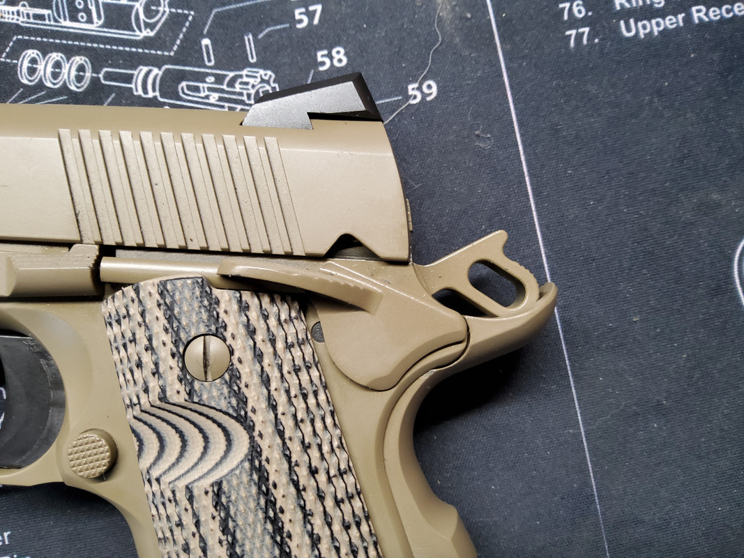

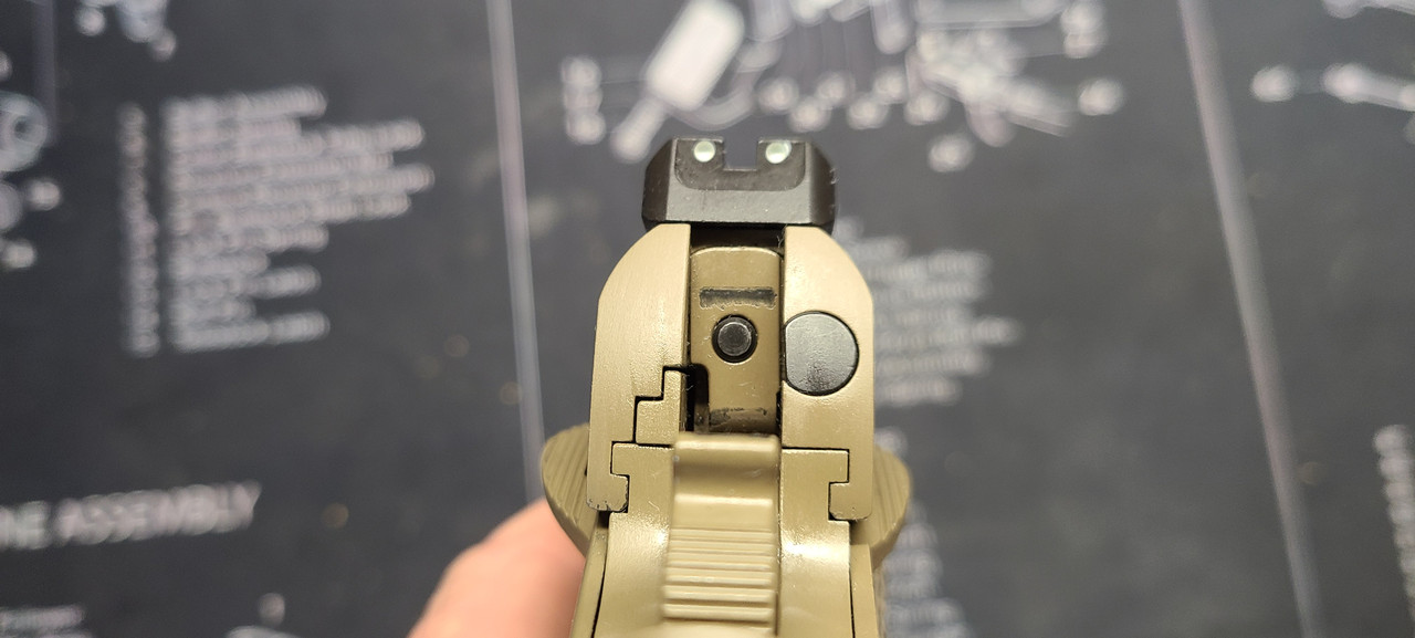

I changed all the springs to Wilson Combat today and gave it a thorough look over.
Everything is wearing in normally. There are two abnormal spots of wear I noticed.
Nothing that affects function.
There is some gouging through the cerakote from actuating the left side safety that's actually cutting into the frame a bit.
The hammer is also hitting the firing pin stop plate pretty hard.
So far, 600 ball and 40 jhp with that one initial failure to feed on the first magazine.
Pretty impressive

Both rubbing spots were normal. You can polish back side of the thumb safety to ensure it will not get worse. The firing pin stop wear you cannot do a thing. Enjoy your fine pistola.
That's good to know.
This is the first 1911 I put that many rounds through and I haven't seen that wear on others I have or seen so I wasn't sure. Looked odd to me.

I would pull that thumb safety and stone the back of it.

Yeah, I'm going to polish it. Probably a burr or something on the back

The two USMC school house Colts don't have any wear there and those have an ungodly amount of rounds on them I'm sure. That's why I thought the wear was definitely unusual.
Link Posted: 3/6/2023 6:07:06 PM EST
Took it apart, no burrs.
Polished it up.
We will see, I'm not worried about it.
Shoots and works flawlessly.
Adds character.

That looks to me like it was done during an assembly. When you drop the safety it does not have enough movement to make that big a scratch does it?

I definitely didn't do it assembling it if that's what your implying.
Link Posted: 3/12/2023 5:19:52 PM EST
The hammer pin is supposed to sit proud to keep the safety lever off the side of the frame so it does not rub the frame and take the finish off. It is supposed to rub against the hammer pin... not the frame.
THIS
oh and the hammer hitting the firing pin stop is normal unless you have changed the face of the hammer to hit flat and I dont recall ever seeing a factory gun built that way.

Picked mine up today.
X300 pic adapter wouldn't lock in. Universal adapter locked on.
Color looks normal tan, small raider font.
I dig it.
