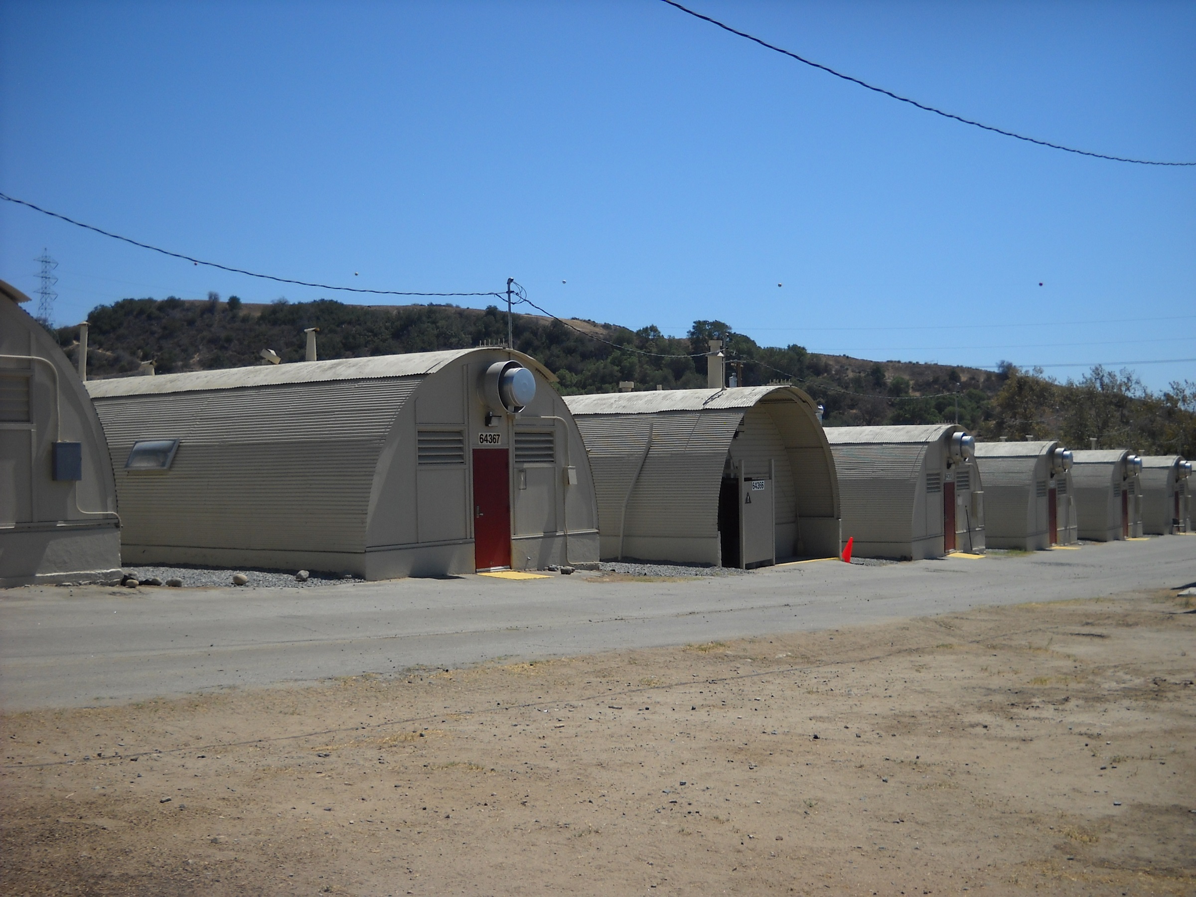

I think the Marine Corps still has them at CamPen.  What I remember most about them were the big floor fans always running at either end.

https://www.pendleton.marines.mil/Portals/98/Docs/Environmental/Cultural%20Resources/Images/Figure%2027.jpg
