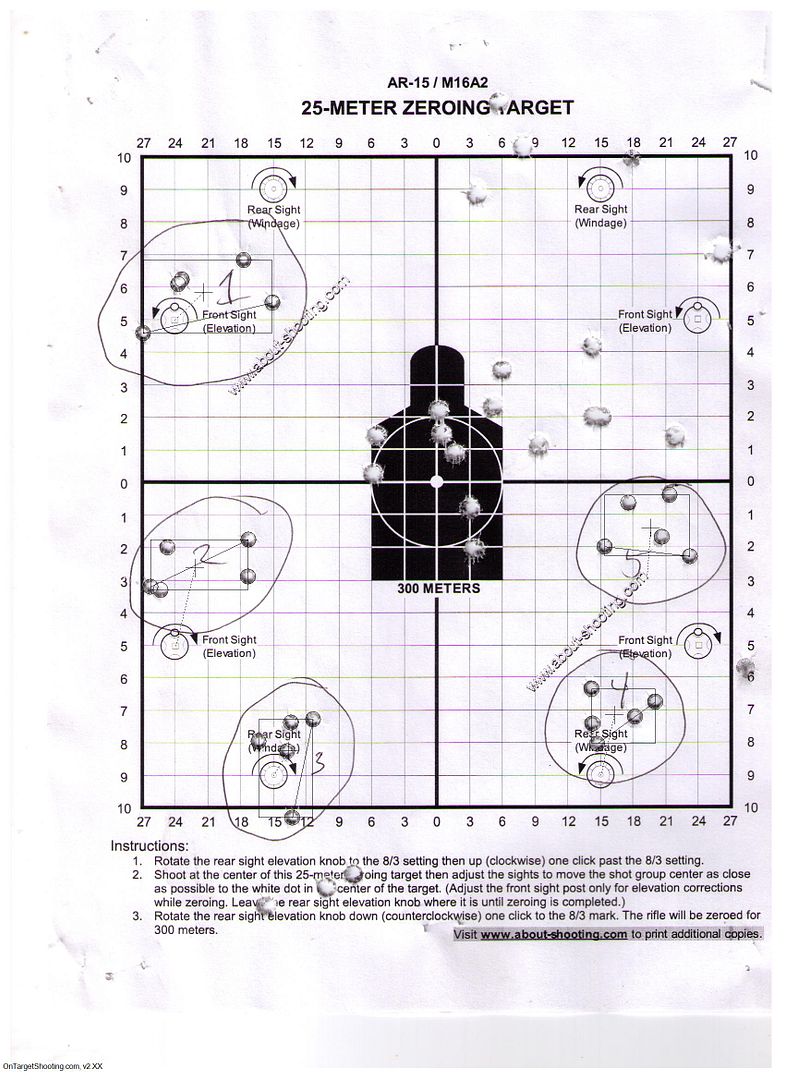

Well, I decided to do this today, printed out targets, got my rifle and ammo together.  Looked up a good spot for 100 yds on Google Earth, loaded up the suburban and headed out to the desert.  Got out there, confirmed the distance with a tape measure, and went to get set up.
FORGOT THE DARN TARGETS ON MY DESK.  DANGIT.
I still had some sight-in targets stapled to the backer from when I was sighting in my AR-15 last week.  So, I picked aiming points and just used them.  I hope that's OK.  If I need to go do it again to qualify, I will.
Shooting position.  Rifle is a Savage 93R-17F with a Centerpoint (CHEAP!) 3-9x32.  I have a Rifle Basix trigger installed, set at about 4oz.
The 'range'.  I was shooting from the top right to the bottom left.
Target.  All the other unmarked holes in the target are .223.  There are only 25 17HMR shots on target.
Ragedracer1977: Savage 93R-17F in .17 HMR - Rifle Basix Trigger- Centerpoint 3-9x32- CCI 17gr TNT. Groups: 1.437" / 1.178" / 1.091" / 0.776" / 0.931" = avg. 1.083" = 1.034 moa
Group calculation was done using OnTarget.
ETA:  Just to confirm that OnTarget was working, I put a caliper on one of the groups.  It's dead on.
I'm going to try this again, I think.  I noticed my groups getting smaller as they went.  And I know why.  I walked out through a bunch of sand to check the prior target and then walked back.  The first group the scope was really 'bouncing' with my heartbeat.  By the last, my heart had settled down a bit.
