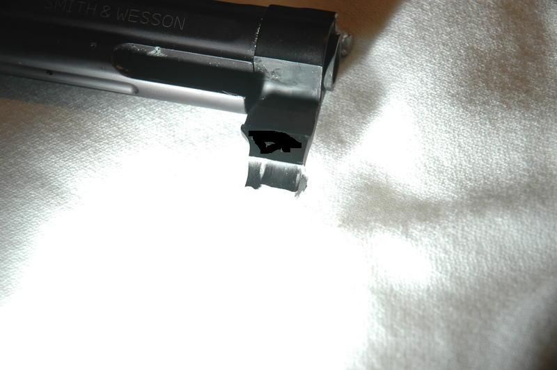

I have a 329PD; I would like to know what happened to that revolver.
I know that the blast shield at the barrel/cylinder gap can fall out; if he kept shooting with it missing I can see it eating through the topstrap and causing this.
My guess.

Link Posted: 4/2/2010 5:46:15 AM EDT
Any idea as to what caused the .44 to KB?
If I had to guess it would be that there was a hairline fracture or something caused previously by who knows what. The shots sounded normal and then one was really loud.
It was not a squib. It also was not a blockage issue.
Given that it was an airweight, I have to wonder if he was able to tell the difference between a KB and a normal discharge
44 mag out of an airweight probably feels like a KB every shot
Probably more common than it seems-non-steel frame+magnum caliber=KB waiting to happen.

Link Posted: 4/2/2010 6:52:06 AM EDT
The front fail off.
Wasn't this one built so the front wouldn't fall off?
Apparently not

Link Posted: 4/2/2010 2:50:47 PM EDT
The front fell off was the first thing that came to mind when I saw the pictures

Link Posted: 5/17/2010 4:11:41 PM EDT
A newer S&W sending its barrel downrange. Like that's never happened before.
Typical S&W quality nowadays.
If you want a good DA revolver, buy vintage or buy Ruger.
You must have a short memory. Here is just one example of modern S&W quality:

Link Posted: 5/18/2010 3:00:57 AM EDT

My personal 44's are now exclusively either Ruger or Dan Wessons. They'll take the full house reloads with todays modern powders all day long without going out of time or blowing off the top strap unlike many other brands that are available.
Link Posted: 5/18/2010 3:29:15 AM EDT
The front fail off.
You fell at spelling.
Link Posted: 5/18/2010 3:31:47 AM EDT
Just a little duct tape and it'll be fine.
Link Posted: 5/18/2010 3:41:33 AM EDT
aluminum.  there is a problem with all aluminum in that it has a finite endurance limit.  what this means is no matter how slight the repetitive stress, all aluminum will fail.  take for example valve springs on a car, these cycle once every two engine revolutions and considering the engine must last at least 100k miles at about 2500 revolutions per mile, that means  125 million cycles.  valve spring failure is very rare because they are designed for a stress well below the infinite limit which most steels have.  but aluminum has no infinite stress limit.
this part of the pistol is not only highly stressed, it is also subject to notching from the cylinder gap.  so most have a hard steel alloy shield.  if that fails, the aluminum will become eroded and this induces a stress concentration area.
I have personally owned two of the Smith 'wonder' Lite revolvers.  Both of them failed beyond repair.  In both instances the frames became worn to the point of being so out of spec that they could not be safely fired, and the cylinders would fall right off the crane.

this airweight 44 mag is about the stoopidest idea i ever saw.  completely absurd waste of money.
Dude, it's an almost perfect pistol for hiking in bear country. My bro lives in Seattle and just got one for just that reason. It's replacing a Ruger Super Blackhawk and he says the weight difference was immediately noticeable on his last hike.
I did advise him to NOT use the Buffalo Bore 340gn hard cast rounds I got him. It's CLEARLY marked on them "For Ruger Pistols Only"

I am going to say Flame Cutting killed that revolver..

Link Posted: 5/18/2010 5:57:28 AM EDT
look at the fracture surface on the top strap
looks to me like a clean break
as a civil engineer with some graduate study in materials, i call brittle fracture on that one
like a fatigue failure or an inclusion or imperfection at the top strap location
Thus the reason you only run aluminum connecting rods for a certain amount of time and then trash them............regardless of what x-ray shows (or doesn't show)
And I dont want a Scandium frame for anything above 38/357 levels of pressure ..........sorry.
Front fell off.
