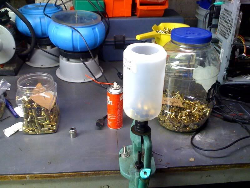

Link Posted: 5/18/2010 5:18:49 AM EDT
G-rx redding base sizing set up . works great !

Link Posted: 5/18/2010 3:42:18 PM EDT
To recap;
Redding makes a G-Xr die that removes 100% of the Glock bulge. It's what I use. It takes considerable force to resize the case, a stout single stage press works best. They come with a little jar of Imperial Sizing Die Wax, it will last around 3500 cases before you need to get more. I used Hornady's case sizing lube instead. It's their reddish/brown sizing wax and it's really too thick for anything other than G-Xr duty with .40 Glocked brass. It cut the work load almost half when compared to the Imperial. That's really saying something, because Imperial is good stuff.
Redding has just come our with a carbide model of the G-Xr. It costs more but is probably worth it. I'm sure much less effort is needed compared to the original G-Xr die.
Lee just announced they are releasing a similar product to Reddings, however, they are making it in 9mm, .40 S&W and .45ACP.  This will allow you to get any off these calibers back to a useable dimension. Lee always costs less.
EGW (Evolution Gun Works) sells special Lee dies that are .001" undersized in various calibers. It's been reported to work as well.
I use the Redding G-Xr followed by the EGW-U undersized Lee resizing die. This virtually guarantees as new case dimensions. I have encountered zero problems using this set up. It probably is overkill, but I don't want any chambering issues with my Glock.

Link Posted: 6/1/2010 12:09:17 PM EDT
Originally Posted By abpt1:
http://i155.photobucket.com/albums/s298/abpt1/Reloading/gpx.jpg
I might need one of those for 9 and 40.
