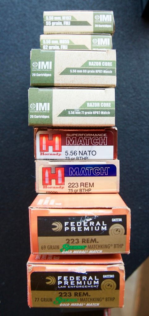

Accuracy: Maybe not quite as bad as my original Tavor but I am still not impressed. Combat effective for sure I guess but it is not an AR15 in the accuracy department.
(some of the ammo shot through the X95)

Now, let's talk about the above groups... sample size of only one for each type of ammo so take it for what it's worth. I was using Vortex Viper PST 4-16 for testing, with a Range Systems "sight-bloc" front rest and a sand bag rear. It was fairly steady but not rock solid; crosshair wobble was consistently the width of the interior white dot, which is 0.5". To be fair / generous, deduct that 0.5" hold error for the true potential of the gun / ammo. I felt slightly more steady with the BCM just because it sat in the rest nicer and is easier to hold / manipulate (to me). My conclusion is the X95 is a 2 - 4 MOA rifle depending on ammo, and the AR15 platform will handily beat it even with a lightweight fluted barrel. Yes the BCM also has a Geissele G2S trigger but I really do not think it gave it much of an advantage. The X95 trigger is quite nice and a DRAMATIC improvement over my old Tavor.
<a href="http://s33.photobucket.com/user/OR_05Taco/media/AB1_6116_zpslqilozss.jpg.html" target="_blank">http://i33.photobucket.com/albums/d99/OR_05Taco/AB1_6116_zpslqilozss.jpg</a>

Wow, that's disappointing on the accuracy front. I realize that these are combat rifles, but coming from AR's and bolt guns that have free floated barrels to help give us the best possible accuracy, my concern has been the fact that these bullpup's barrels are anything but. I think a bullpup is the perfect predator hunting rifle to use with a suppressor while saving that stamp money for cans, but for the kind of money these rifles command I'd like less than 2 MOA.  Are my expectations too high for accuracy and is what you experienced common? You certainly used a wide variety of ammo and none of them really seemed to hit the sweet spot.

I made it back to the range yesterday for some more accuracy testing. My goals were to get a more solid rest, and shoot multiple groups for a few different kinds of match ammo. The results were about the same, maybe a little better with some.
The bipod and sandbag combo was SOLID, absolutely no reticle movement when on target so the results are good hard data as far as I'm concerned. Nice weather again with virtually no wind and I was really focusing on good clean trigger squeeze, etc. I also waited at least 5 minutes between each group.
The ammo for the followup test was 20 rounds of Nosler match 77 grain, 20 rounds of Fiocchi match 69 grain, and 20 rounds of Federal Match 69 grain. I also shot one group each of IMI 69 grain, IMI 77 grain, and Federal XM193. The results:
The Nosler averaged right at 3 MOA and the FGMM averaged right at 2.5 MOA. Interestingly (or frustratingly?) it appears to like Federal XM193 as much as any match ammo; 2.48" group yesterday and a 2.55" group on Monday. The others... meh.
A couple observations I made at the range:
- The point of impact varies wildly with different types of ammo. I always expect some shift but I have never experienced as much shift as with the X95. I did a quick zero with Remington UMC 55gr at 100 yards, then shot the first group of Nosler 77. I was aiming at the upper left dot on that target and hit way to the right, almost to the right dot. I maintained my point of aim for that group which centered over 6 inches to the right. I dropped down to the second left dot and shot another group below the first, again over 6 inches to the right. I adjusted the scope left and then didn't mess with it for the rest of the test. The Federal XM193 printed almost 6 inches the other way when I got to that one. Moral of the story is test whatever different types of ammo you have put away through your X95 and adjust accordingly. Yes it is wise to do that with any rifle but my AR's do not vary by that much... I actually shot a few different types of ammo through my BCM 11.5" while I was there and all of the groups printed within 3 inches of each other. The groups were also considerably better, about 1.5" for both the Federal 69 and IMI 69 (from a 11.5" lightweight / fluted BCM barrel).
- On the groups with dramatic "fliers" (IMI 69 and Fiocchi), the first shot was always the one furthest out (left on the Fiocchi and low on the IMI). Refer back to my last targets and you will see the same dramatic low flier on the group of IMI 69 from Monday. I mistakenly assumed I must have been aiming at the wrong dot and adjusted it for measuring purposes... apparently I should not have! The trigger breaks were clean and I believe there is something going on with pressure on the barrel and how it reacts to warming up. It seems that some loads trigger this more than others. It reminds me of trying to do load development on a hunting rifle which isn't free floated...
So in the end it is a 2.5 MOA gun with a rock solid rest and ammo that doesn't exacerbate the non free floated barrel. While that does not excite me and I wish it was better, I just have to wrap my head around its intended purpose and stop chasing groups on paper. I was pretty frustrated with it when I left the main range... I went down to one of the shorter bays and did some 25 yard blasting with wolf at clay pigeons and had a blast. So I am done with buying match ammo for it. The only test I have left in mind is get a good solid zero with some M193 and then shoot 10 groups in a row without letting it cool down. I am interested to see if it shifts much as it heats up with an ammo that it apparently likes. We will see...
