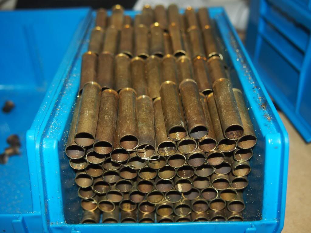

Thought I would share some pictures of my process.
starting with once fired brass...
I use a Harbor Freight mini chop saw
Cut the cases right at the start of the shoulder
size, decap, trim
dont have pics of swaging or reaming but you get the idea
finally stainless tumbling
The reason for using the chop saw is because Dillon will not warranty the trimmer if you use it to cut the full amount in one pass.

Ok, so I'm posting this here because anytime I even mention "300 blackout" someone directs me to this thread... I just started reloading for the first time. It was probably a dumb idea on my part, but I decided to start with some 300 blackout since my upper will be here this week. I picked up my chop saw from Harbor Freight and cut down about 50 or so .223 brass. I set up my Lee Anniversary press and loaded the resizing die into it as I've seen in all the videos I've watched. Now, here's where I'm stuck; when I try to raise the case into the die it just doesn't feel right. On all the videos the person easily pulls down on the lever and reforms the neck of the cut .223 brass. Whenever I go to resize it it is pretty difficult to pull the lever. It feels like something will break if I pull it much more than I have been. Granted, I haven't done this before, so I'm sure I must be doing something wrong.. I even tried adding some case lube on them to see if that would be it any easier, but nothing changed.
Any advice?
Link Posted: 1/13/2013 10:21:20 PM EST
[Last Edit: 1/13/2013 10:38:15 PM EST by aviserated1]
You need more lube for forming. What lube are you using? You may need imperial sizing/case forming lube. Also apply it to inside neck and neck sizer button.
http://www.midwayusa.com/product/519525/imperial-case-sizing-wax-2-oz
Link Posted: 1/13/2013 10:48:39 PM EST
I put some of the Lee case lube that came with the kit. I put quite a bit on it. Guess I'l try adding more, and if that doesn't work I'll get some of that wax.
Link Posted: 1/13/2013 11:43:50 PM EST
[Last Edit: 1/13/2013 11:46:59 PM EST by AnthonyL]
After chopping the brass and before putting it through your resizing die did you first debur and chamfer the cases?  If not I bet that is your problem, the die is getting snagged and likely damaged by the rough edge on the case mouth left by the chop saw.
I have the exact same mini chop saw, and each case gets touched by the debur/chamfer tool then into the full length sizing die.  I've used Hornady Unique wax case lube with great results.  However for the sake of time with larger batches I switched to Hornady One-Shot case lube and had zero issues, most cases resize with little to no effort.
