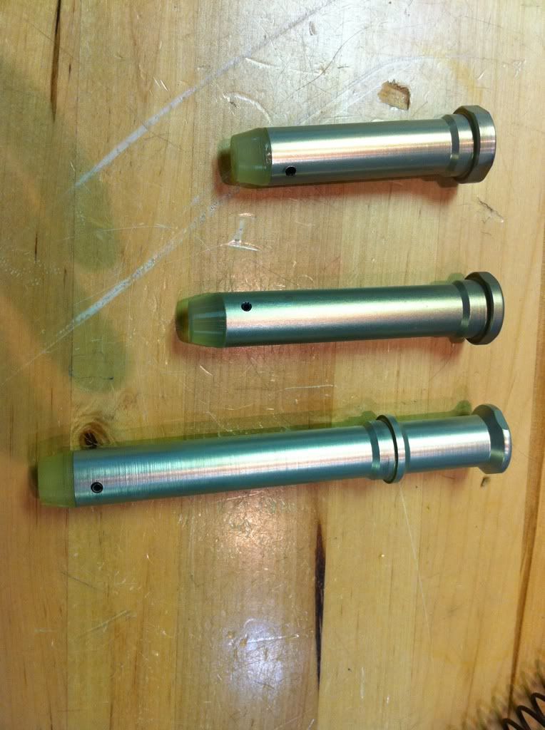

I got my A5 tube in the other day and put it on my RR.  I also took some pics of the buffer up against a carbine and rifle length buffer.  I haven't shot the lower yet but I plan on doing a review when I get everything together.  I have a 7.5" upper, a 10.5", a 20" upper all in .556.  I also have a 11.5" in 5.45x39 I am going to try out, and when I am done Ill try out the 5" 9mm upper.  I need to get my shot timer together and get to the range it has just been kinda busy with work.  I'll get it up soon.  For now I have a couple of pics of the buffers.
