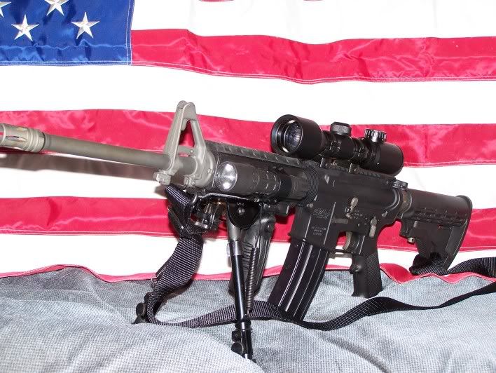

Link Posted: 8/23/2006 9:52:09 PM EDT
This is the rifle
Link Posted: 8/23/2006 9:53:46 PM EDT
How do you see through the front sight???
Link Posted: 8/23/2006 9:56:59 PM EDT
I can't. This gun did have a fixed upper carry handle. I wanted a flattop reciever. I turned the gun into more of a tactical gun.

You could get new rings, risers, or something like the swan sleeve.
At high magnification the fsb is nothing but a smudge on the edge of the scope (if noticeable at all).
Link Posted: 8/23/2006 9:58:45 PM EDT
With the pic you have provided you could just buy higher rings, or get a riser as was said.

Link Posted: 8/23/2006 10:11:39 PM EDT
What do you mean by bars?  Are these bars part of the scope or the rings?  Looking at your first photo I don’t see any bars.  You’re not referring to the rods in the scope rings that prevent forward / rearward movement, are you?

Link Posted: 8/23/2006 10:21:22 PM EDT
Those bars are part of the scope rings, not the scope itself.  You can purchase higher scope rings and replace the ones you currently have.  Just be sure of whether you have 1” or 30mm diameter scope.
Or you could get risers (such as these).
Or you could get something to raise the flat-top (like the Swan Sleeve).
Link Posted: 8/23/2006 10:45:29 PM EDT
You're right! I just looked at the scope. The rings were already mounted to the scope. I think they are 1" high. I need to elevated it up to at least 2" or 3" to use the scope. Do they sell rings that are 2" or 3" high?
Link Posted: 8/23/2006 11:25:20 PM EDT
Those rings are not 1” high (as measured from the base of the scope to the top of the flat-top.
Scope rings are typically referred to as low, medium, and high.  Looking at the picture, you have low rings.
Just look for medium or high rings (be sure of whether you have a 1” or 30mm diameter tube) -- remember you don’t have to raise the scope above the front sight.
