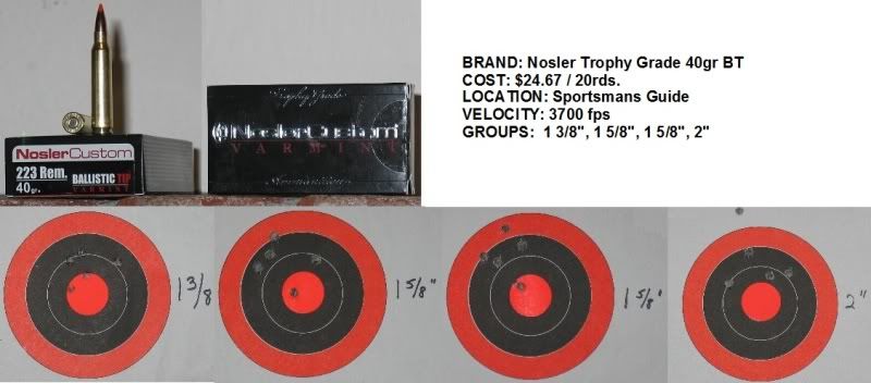

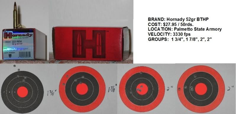

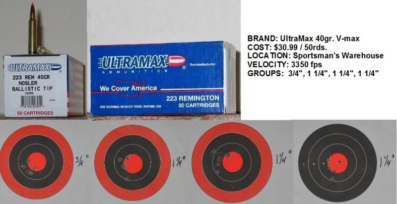

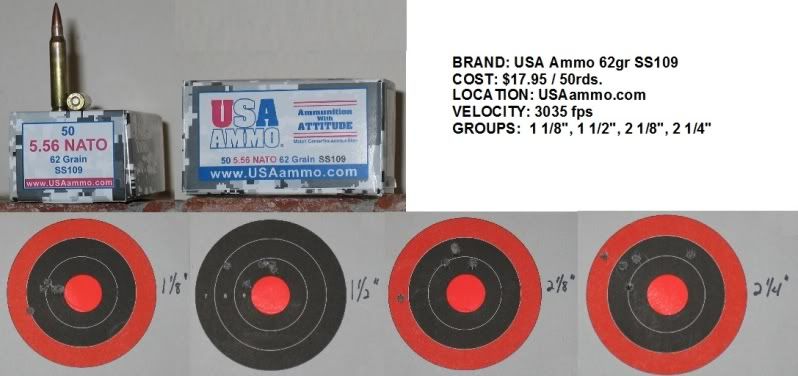

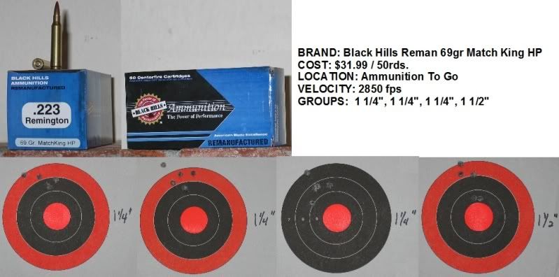

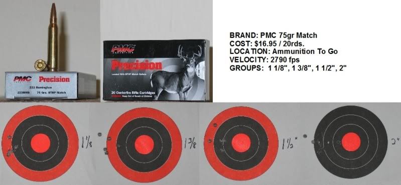

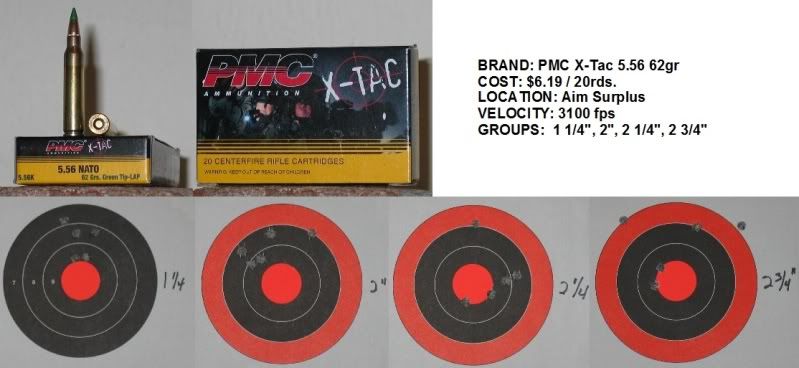

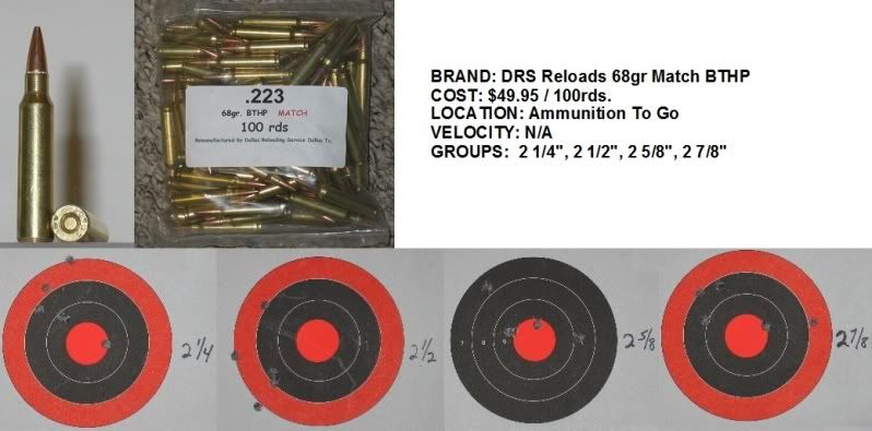

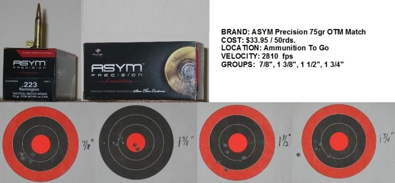

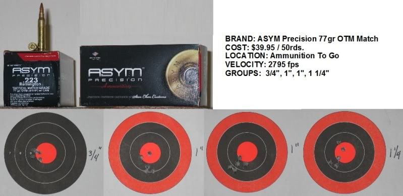

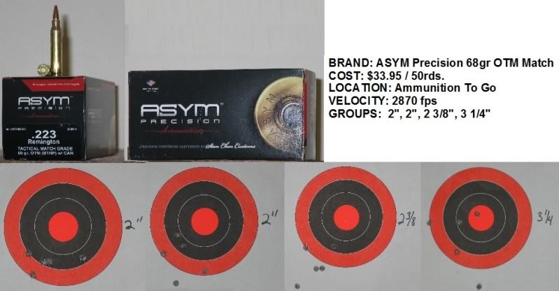

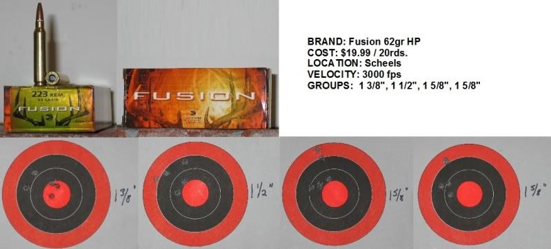

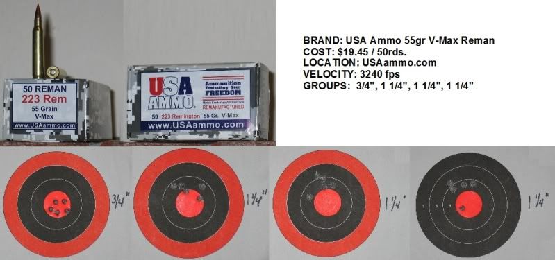

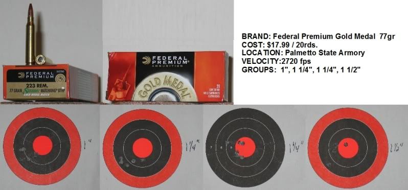

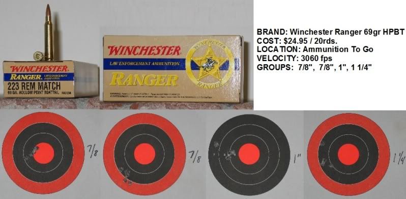

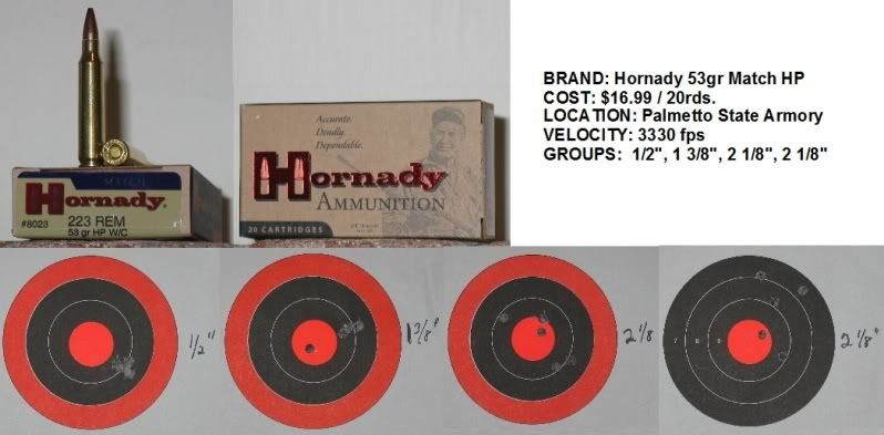

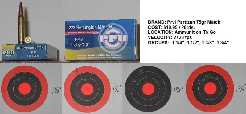

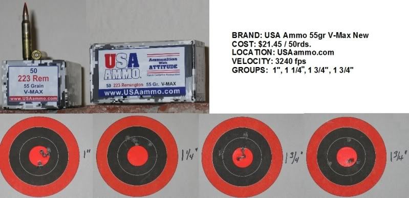

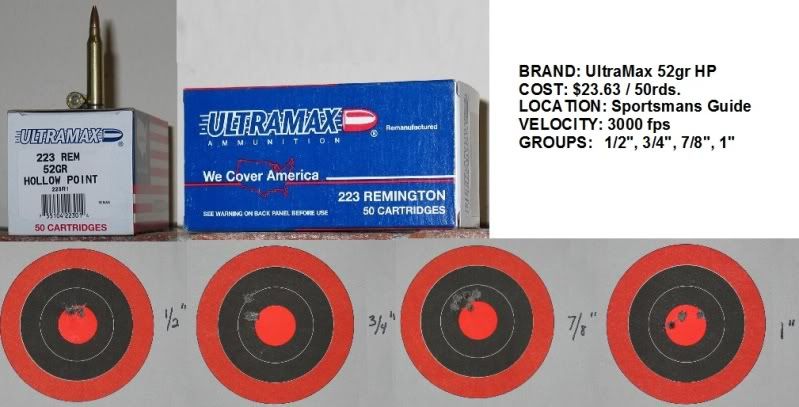

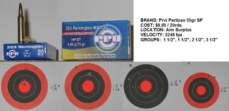

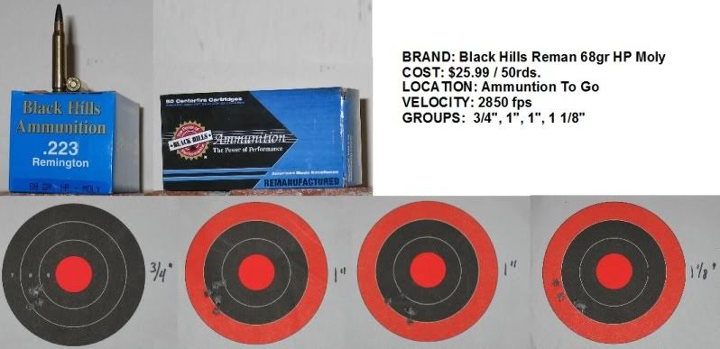

Part 3 of my latest batch of .223/5.56 ammo tested.
Here are 27 more different types of 2.23/5.56 ammo.
If you missed my original test of 60 different types of .223 / 5.56 ammo go here: .223 / 5.56 Ammo Test Part 1 My second test of 16 different types of .223/5.56 ammo go here: .223 / 5.56 Ammo Test Part 2 The targets I used are the Hoppes S-12 50-Yard Small Bore Rifle targets that come 5 to a page. Each target measures 4 inches across. I placed 1" orange dot stickers in the middle of the targets for easier target centering while aiming.
All shots were fired from 100 yards. Five shot groups were fired from each bullet type and repeated 4 times for consistency checking. The groups are displayed from smallest to largest and not in order of firing. Wind was less than 10mph each day of shooting. The rifle used is as follows: Rock River Arms Upper 24 inch stainless Bull barrel in .223 Wylde chamber with 1:8 twist Spike’s Tactical Lower Rock River Arms 2-stage trigger. Vortex 6-24X50mm scope
I apologize as I don't have a chronograph so the velocities listed are stated and not actual.
-Cody |
Awesome man,thanks for posting this!!! That usa 55 gr vmax shoots really well out of my sps tact 223.
PMC Match
does it use the bullets from hornady? |

PMC Match does it use the bullets from hornady? Yes they do. -Cody |

Nicely done as always, Cody. I'm surprised at how well the Ultramax stuff did.

Ever since your first test, I've been using the Fiocchi 77 gr. Match King with excellent results at 200 yards, on several different platforms. It also works perfectly on Zombies at 400. Contagion 2012 I'll definitely give the remanufactured UltraMax 52 gr. HP a try. Thanks again. Ammunition Review - UltraMax |
Thanks for the comparision test.
I had some Ultramax, and other than shooting dirty as all get out it shot good in my gun also. However I did not do a grouping on it. |

PMC Match does it use the bullets from hornady? Yes they do. -Cody Thank you! looks like ranger did well |
