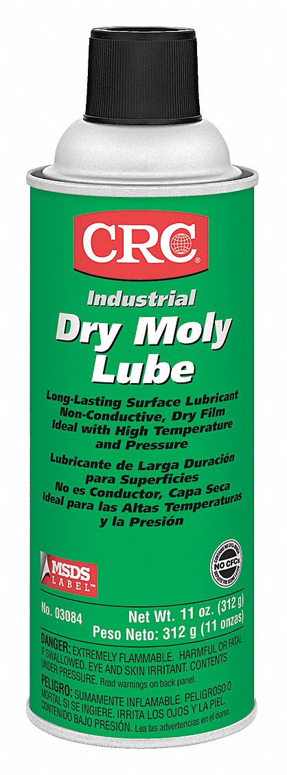

I used CRC Dry Moly Lube.  It makes prebans look a lot better, even almost new in some cases if done with (too much) care.
One $12 can from Granger will easily coat 50 mags, inside and out if you want.  The dry moly coat does rub off slowly on hands and gloves/gear, but it takes a while.  It'll stay on the ag for a good while, but of course, its not anywhre nearas permanent as the bake-on coatings, and I like it far better than Krylon.
