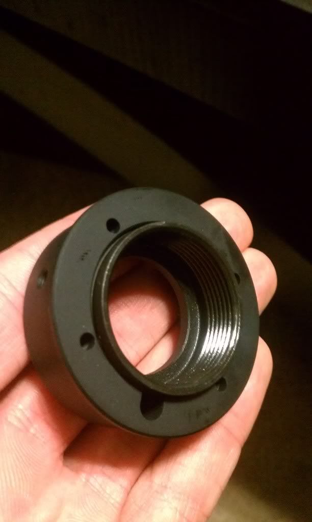

One piece of the clamp that interfaces with the barrel nut, barrel nut goes through this and screws on
Other piece of clamp
All together so you can get the idea of the clamping system

ETA: Can it be installed on a rifle without removing the barrel nut? I have a rifle with a perm attached muzzle brake and a factory barrel nut. I suppose I could just loosen the nut and slide that clamp behind it?

I can't wait to get the rifle finished, so far it feels great just holding the rifle.  As far as the barrel nut is concerned, it has to be removed because you have to put it inside the one piece, once I get home I will take a pic of it all together.  Thats probable the only downfall of this handguard for the guys with permanent muzzle devices already on their guns.
Link Posted: 10/28/2011 5:13:14 PM EDT
Alright, here are the pics of how the barrel nut interfaces with the mount.
