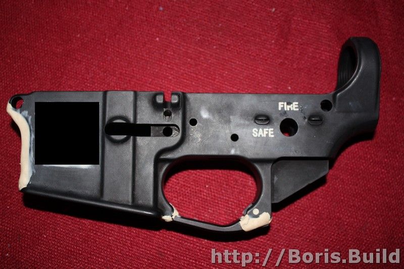

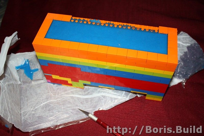

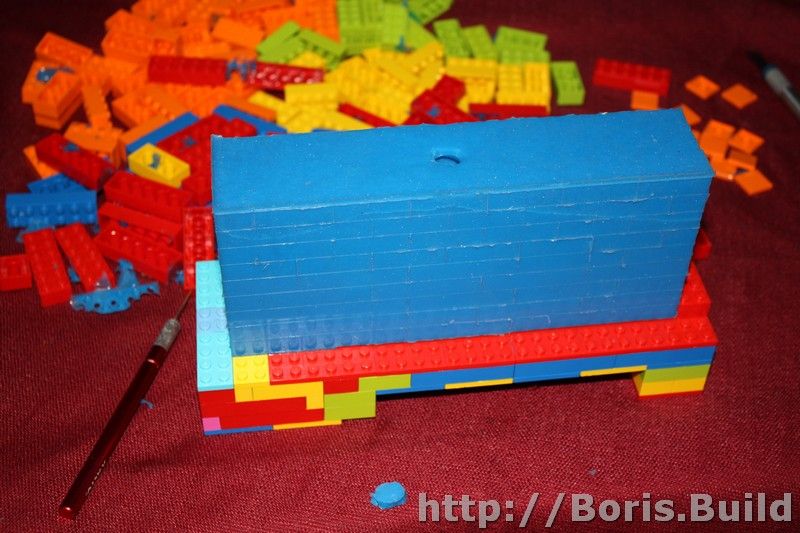

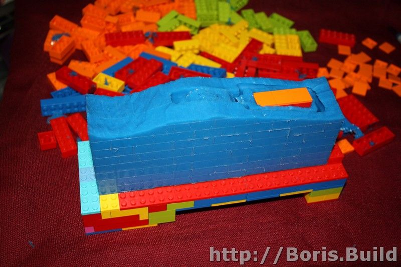

Start with an actual AR 100% receiver. It can be aluminum (#likealawnchair) or printed plastic. You may want to add your special touches like cover up the fire selector markings with clay (use non-sulfur clay) I would also highly suggest to put the trigger guard in place.

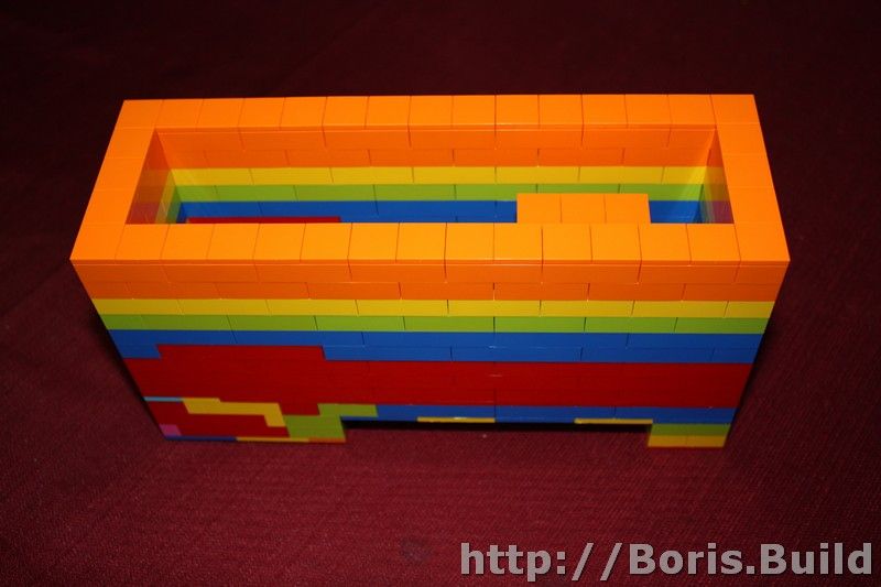

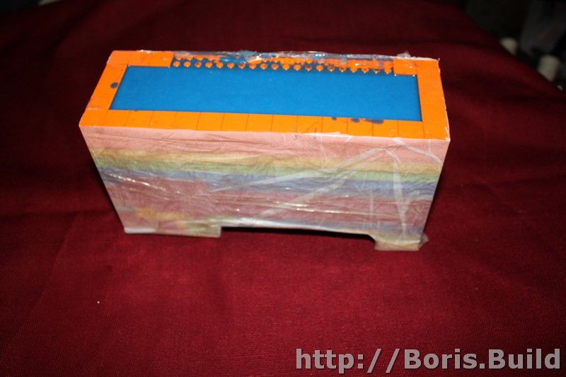

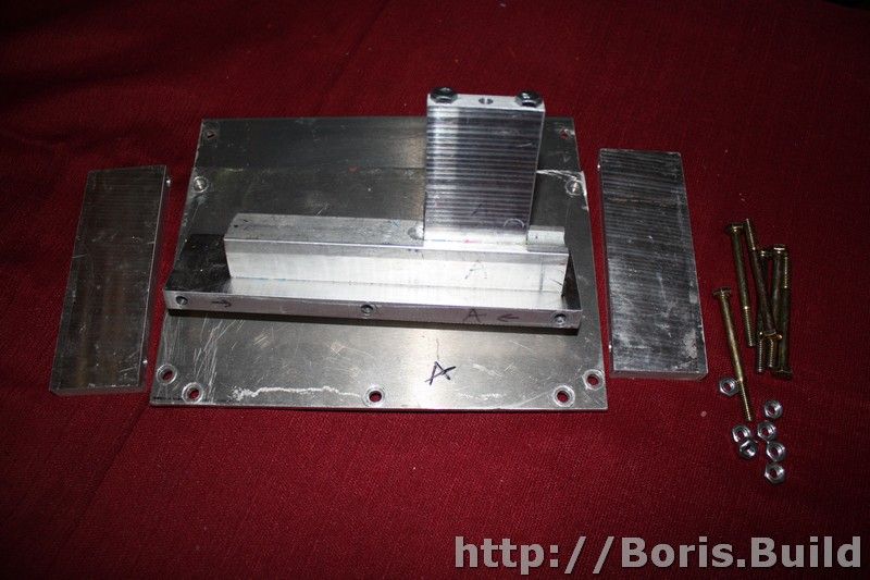

You need a box, something that can hold its dimensions and could be taken apart. I usually use  aluminum (#likeabeercan) box.
But any enclosure can work, even one made from capitalist lego.
Its benefit, once mold is created it may be assembled anywhere in the world.
Dva.

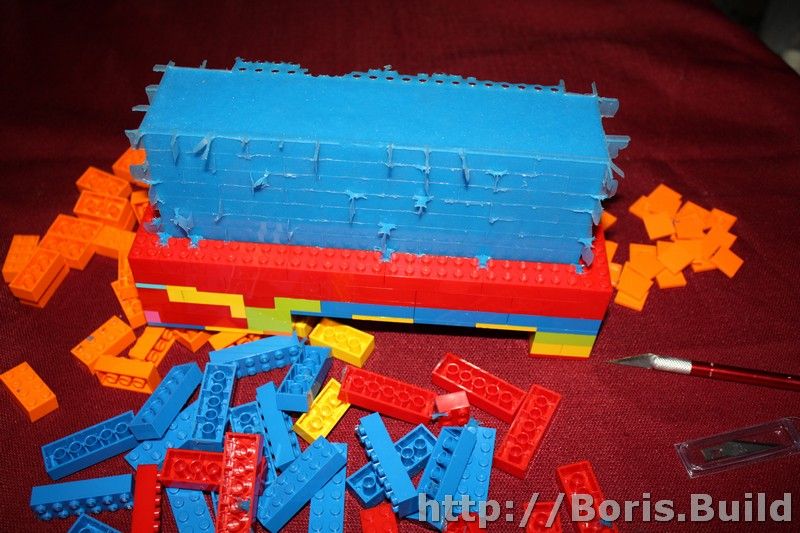

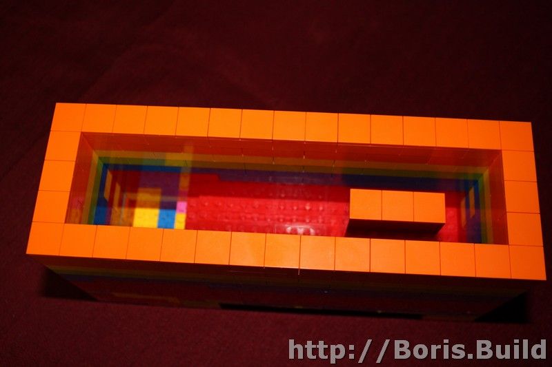

With your box assembled, put receiver in the box and pour silicone mold rubber. Depending on how well box fits around your receiver, it may take around 1.5-2 lbs of rubber that can set you back $20-$30. You want to get something that cures to ShoreA 30-40 hardness.
I wrapped the mold box in grocery bag and tape to prevent accidental leakage. The rubber typically cures over night.

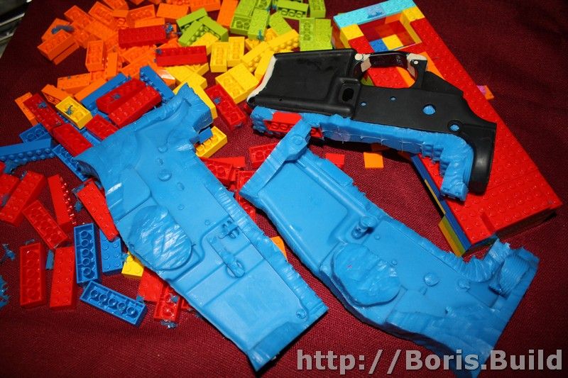

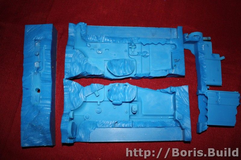

Now we take mold from mold box.

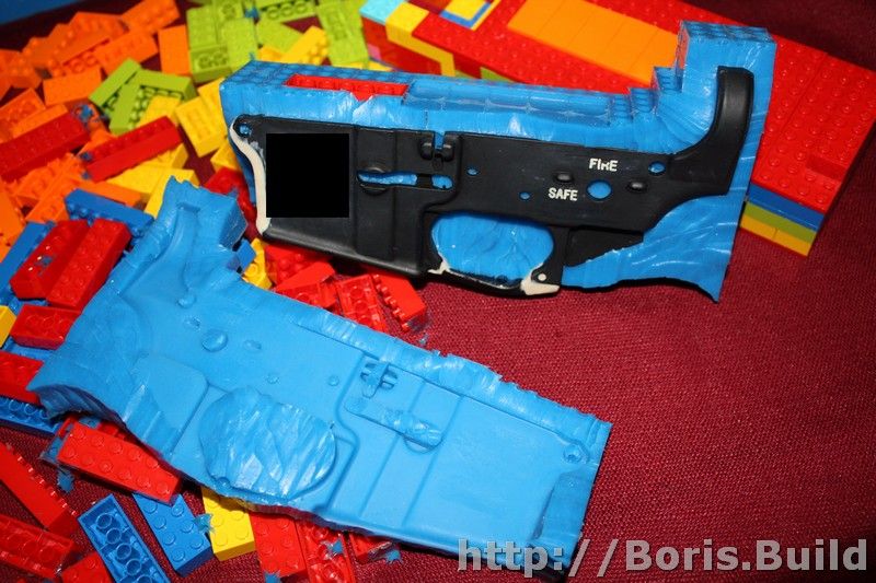

Somewhere inside, there is a receiver trapped in rubber.

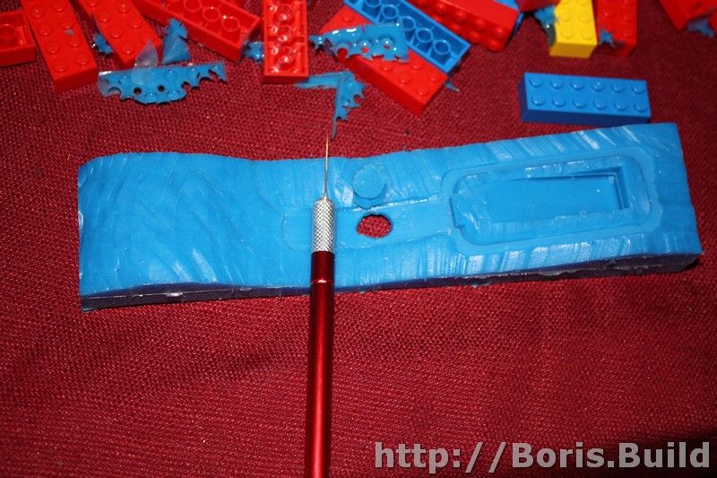

Pull rubber and touch it with sharp blade. There is no pressure required to cut.
Now top is removed.
and a side
and another side
… leaving the middle piece

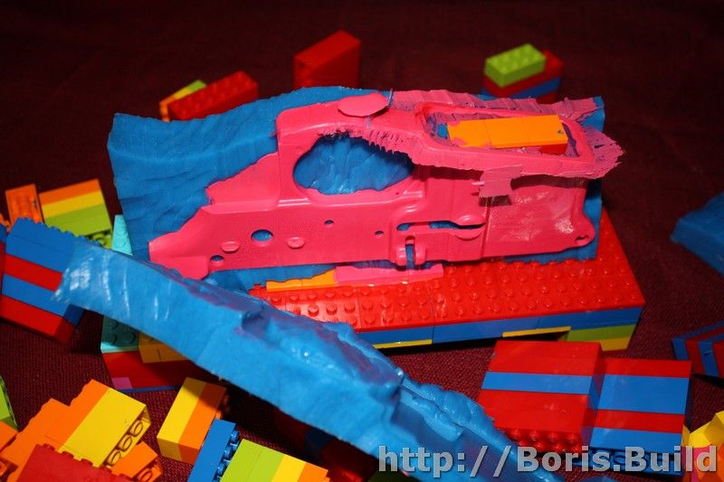

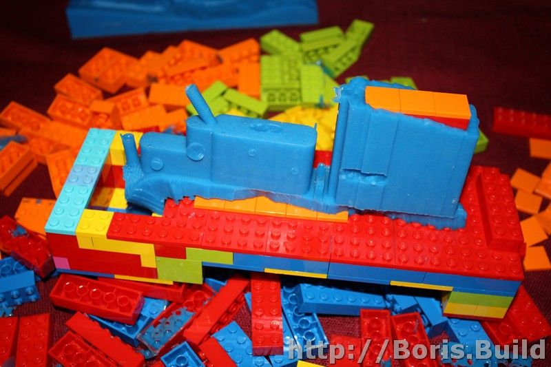

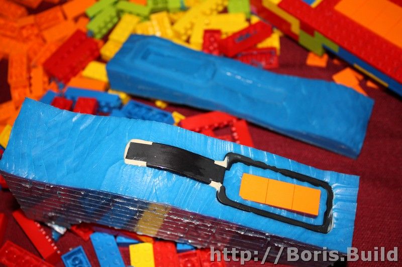

Now the magic begins as we put rubber pieces back
one
... at time
And the top piece get ripped another one … or actually the only one

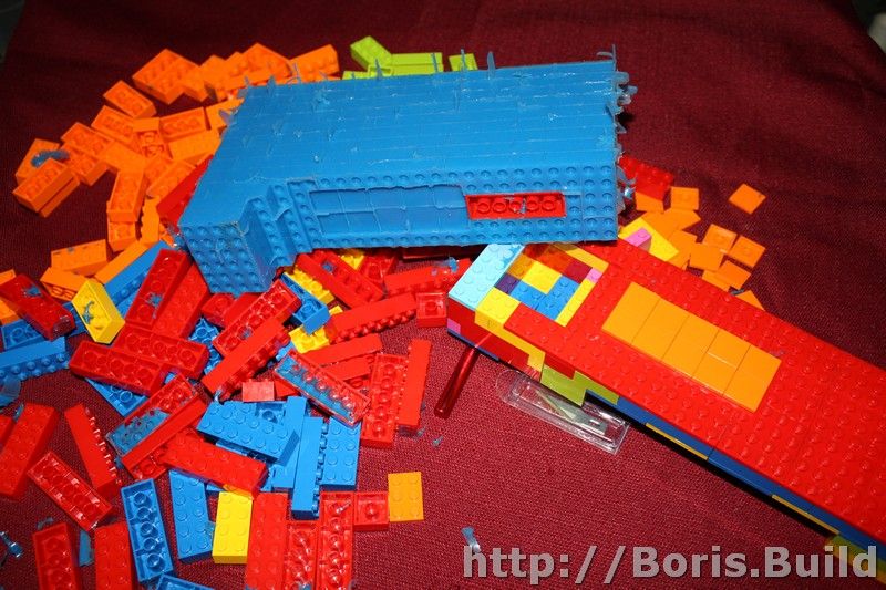

Now, the piece is like it was never cut. But aluminum (#likebeercan) receiver is not inside. What is inside? … Fruity Ghost!

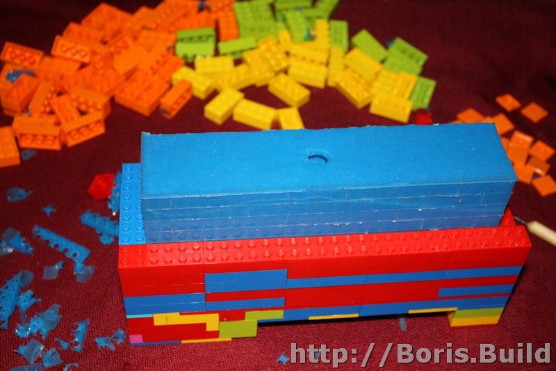

The box is rebuilt back again. It adds stiffabilty and prevent leakage.
Tree.

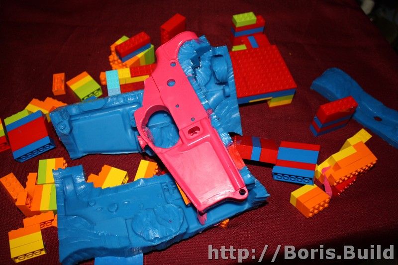

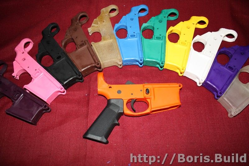

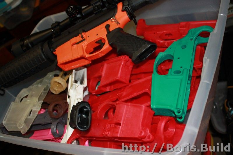

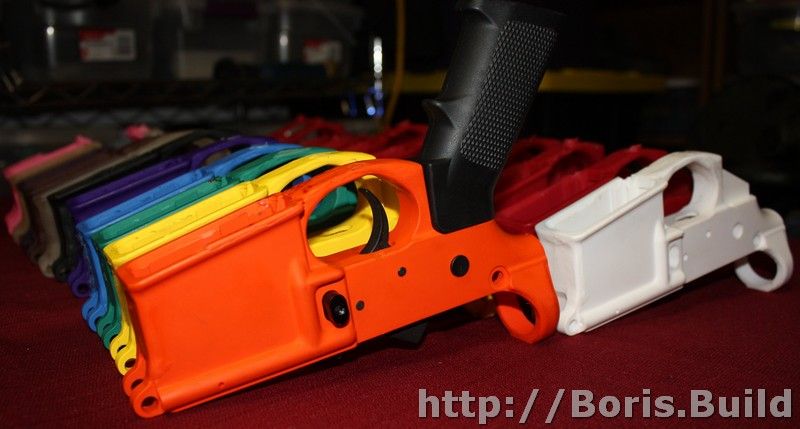

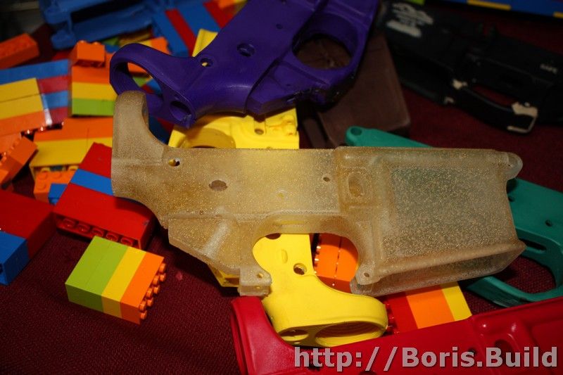

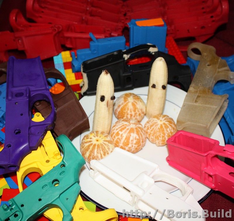

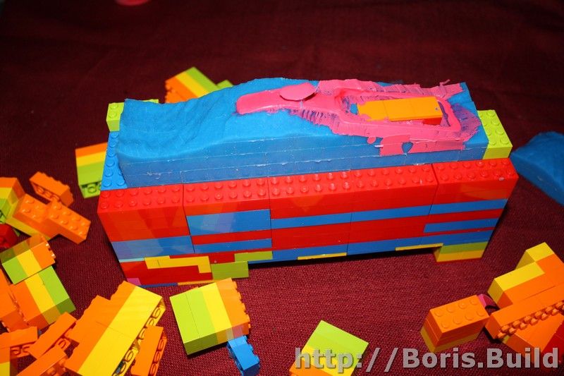

You now take two part urethane plastic and White House Pink pigment to match your range dress. Mix and pour and go eat celery flavored tofu for 10 min.
I tried different plastics. The plastic will set you back anywhere $2-$3 (is tiny receiver!) Wait for plastic to cure. The receiver can be extradited in 5-15 min for most plastics, longer for others. Some plastics will take another week to hardened completely.
When plastic hardens, take apart mold.
You may see flashing. Is no trouble, it's very thin.
Extract your receiver. Is complete.
If mold was made good, all the threads will be perfect with 0 clean up. Pop that FCG in and go shooting bullets, almost like scale copy of the real rifle of most glorious Mosin.
You may say “Dies ist nicht eine waffe des krieges!” … no, actually I'd say that, you would say something more like “tre bon! Magnifique! Garçon m'a apporter un autre bagguette et plus de fromage!
If you think that plastic receivers are waste of time consider that worm hearts organizing gun buy backs pay $50-$200 for any firearm. Since we got a fully bonified receiver (regulated by ATF and everything) you could be making a grand / hour easy. Starving artists will starve no more!
In fact, using just one mold, you can easily crank out 5 receivers/hour without breaking sweat or fingernail. That's over 100 receivers in 24h. Having a couple of molds help. The toughest choice are the colors and shades to use.

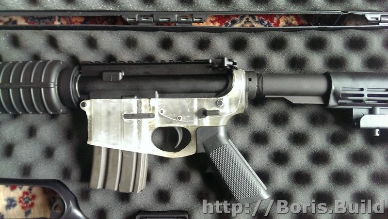

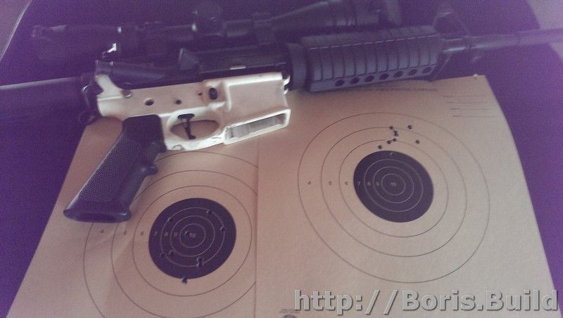

Is this receiver is the strongerest of all, will it stand up to torture tests? Who cares, f-it, just pull another one out the bucket. Aluminum (#likealawnchair) is stronger and steel stronger still, but all part of gun will wear off some time.
Here is the rifle that shot 300 rounds of 556. This is just plain, cheap plastic, no reinforcement of any kind. I use drop-in FCG module. The receiver failed on 308th round by Michael The AR Slayer shooting it with one hand (#tacticalsniper)
The softer receivers do have a problem of hole egging. Hammer and trigger holes will drift apart and after 100-150 rounds your rifle may fire more than a round … if you get my drift. To keep the holes together, you can reinforce them with steel or just get a drop-in trigger that comes with it's own little steel box … or just junk the receiver and make a dozen more.

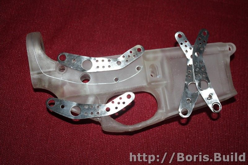

One big advantage of cast over printed receivers is that mold can easily be used to include any type of reinforcement of any type. Steel or kevlar or gold sparkles (#notworkingwell)

Seems like it would be easy to reinforce the buffer tube area -- just build up the actual lower with more clay before making the mold.  Maybe make an integrated stock, something without a pistol grip for the ban states.
