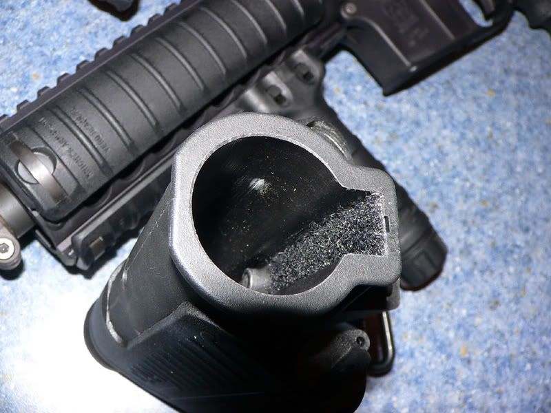

Take the stock off, get some industrial strength Velcro, put a strip of the 'fuzzy' side about 1/4" wide and about 2" long inside the stock along the middle of the tube just inside of the opening. Cures the rattle.

Link Posted: 5/16/2007 9:29:18 AM EDT
Here's what the Velco fix looks like:
It works great.
