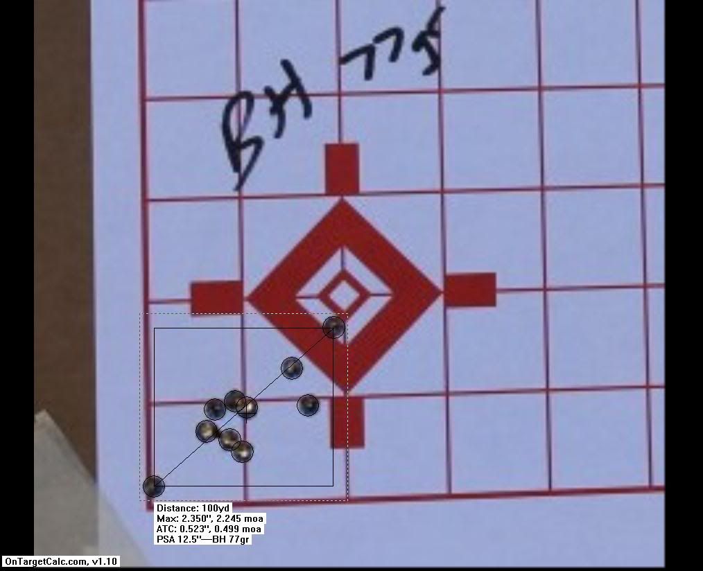

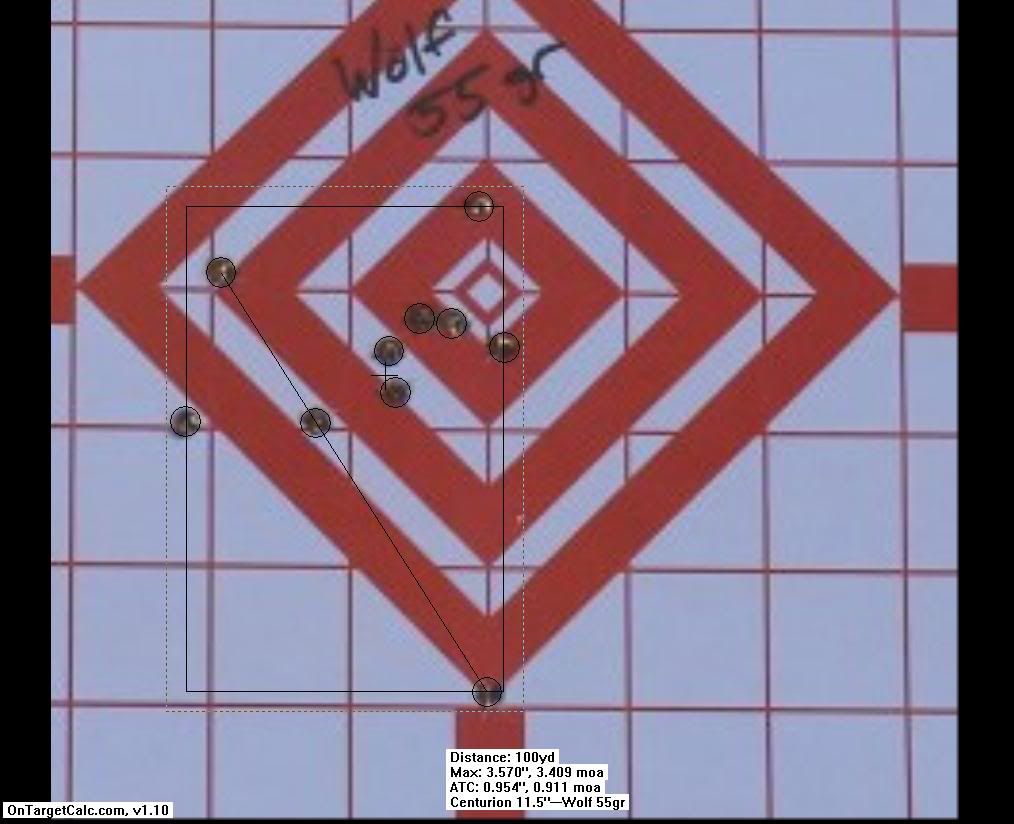

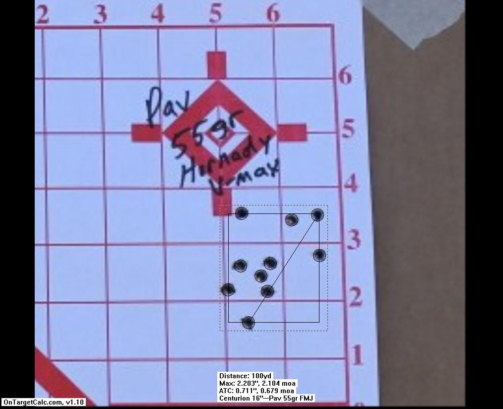

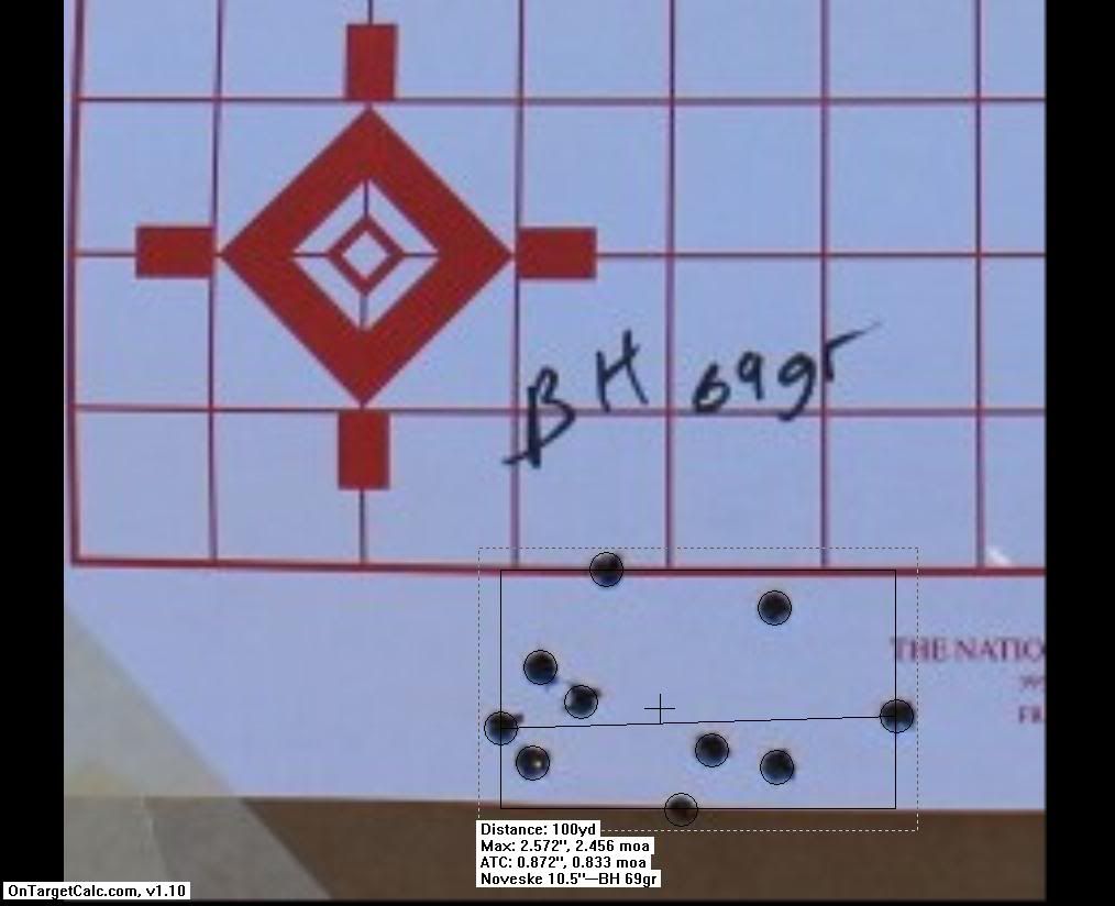

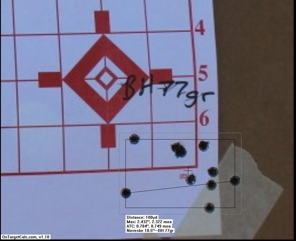

I'm over this. Any reasonable and intelligent person can see that none of these barrels are "night and day" better than the others. I am confident that they are all from the same blanks, forged around the same mandrels on the same machine, and capable of shooting reasonably similar. I'm done here. If there are those of you who do not like that statement, do your own test with integrity, or just buy what you like and run along. I had three souces tell me they were internally and compositionally the same. I had ZERO sources tell me how they were internally or compositionally different. They all had their chance here and didn't speak up and tell us what is unique about their barrels, if anything at all. I'm done here. I urge the mods to do as they wish with the thread. Lock, delete, let it roll on.... I'm over it. If anyone wants me to delete the charts from the OP, let me know and I will pull them. I don't believe that any reasonable person would have thought that there would be a night and day difference as it relates to accuracy (which is what you tested). You have gathered a lot of information and were kind enough to take the time to share it with everyone on the site. But that doesn't mean that everyone is going to look at that information and draw the same conclusions. And if they don't reach the same conclusions, you shouldn't get worked up and take it as though your time, effort, and money are not appreciated. I like what you are doing and would like to you or others build upon it so that we can get closer to a conclusive answer. I wish FN could just come forth and tell us whether they are built to the exact same specs, but that is not going to happen. |

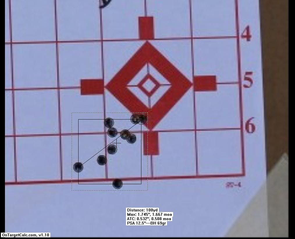

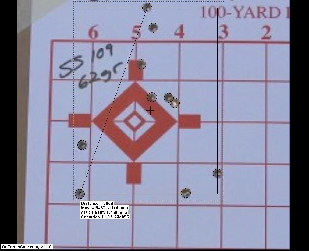

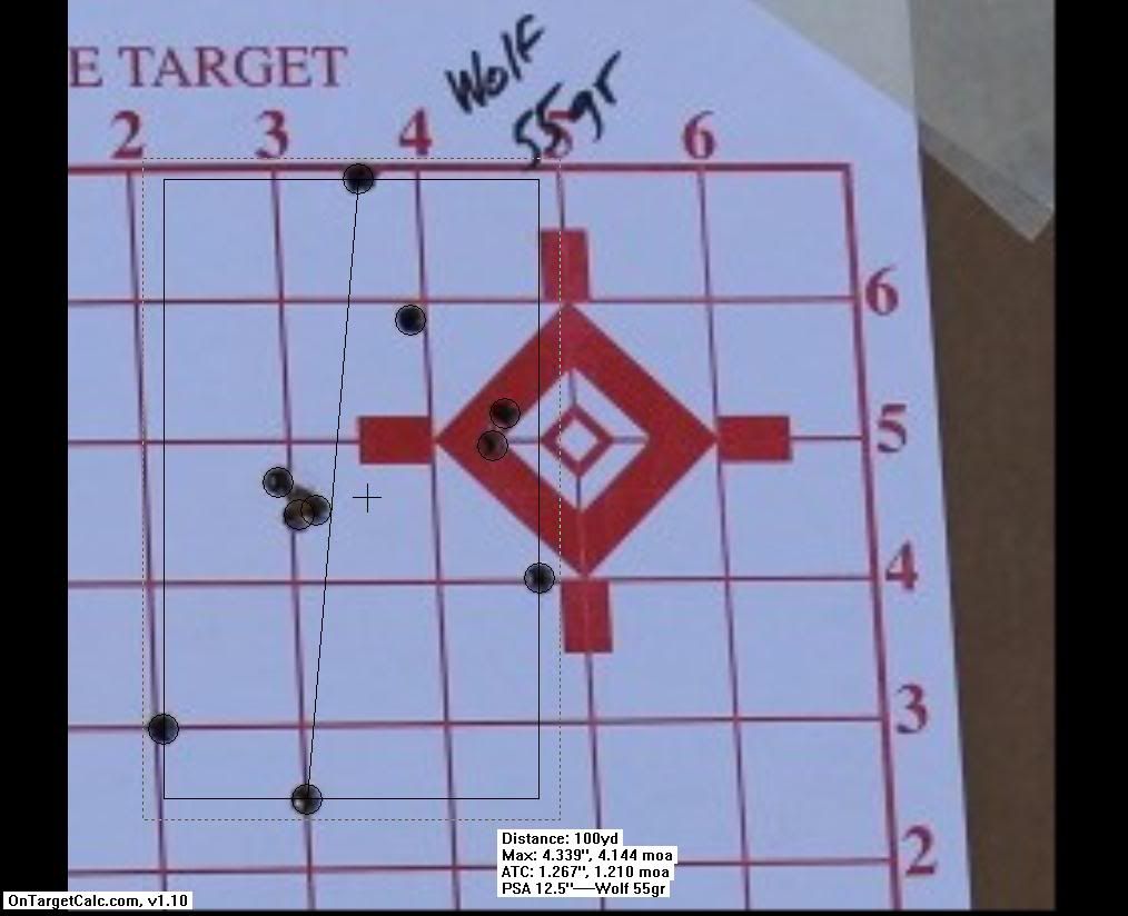

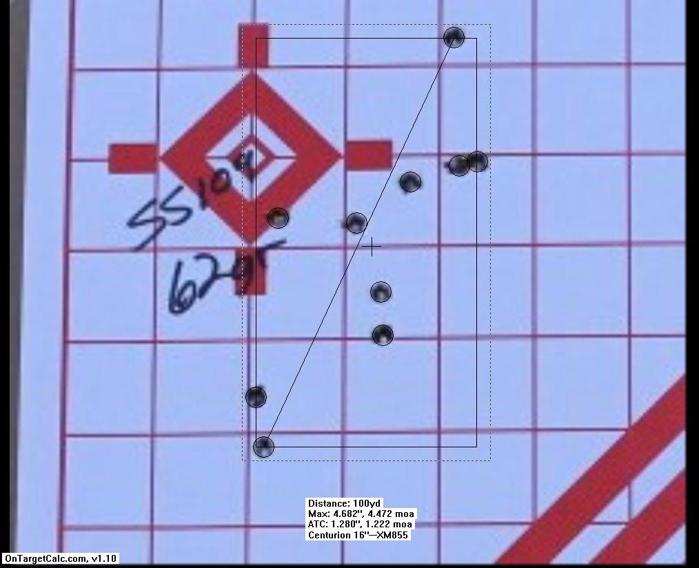

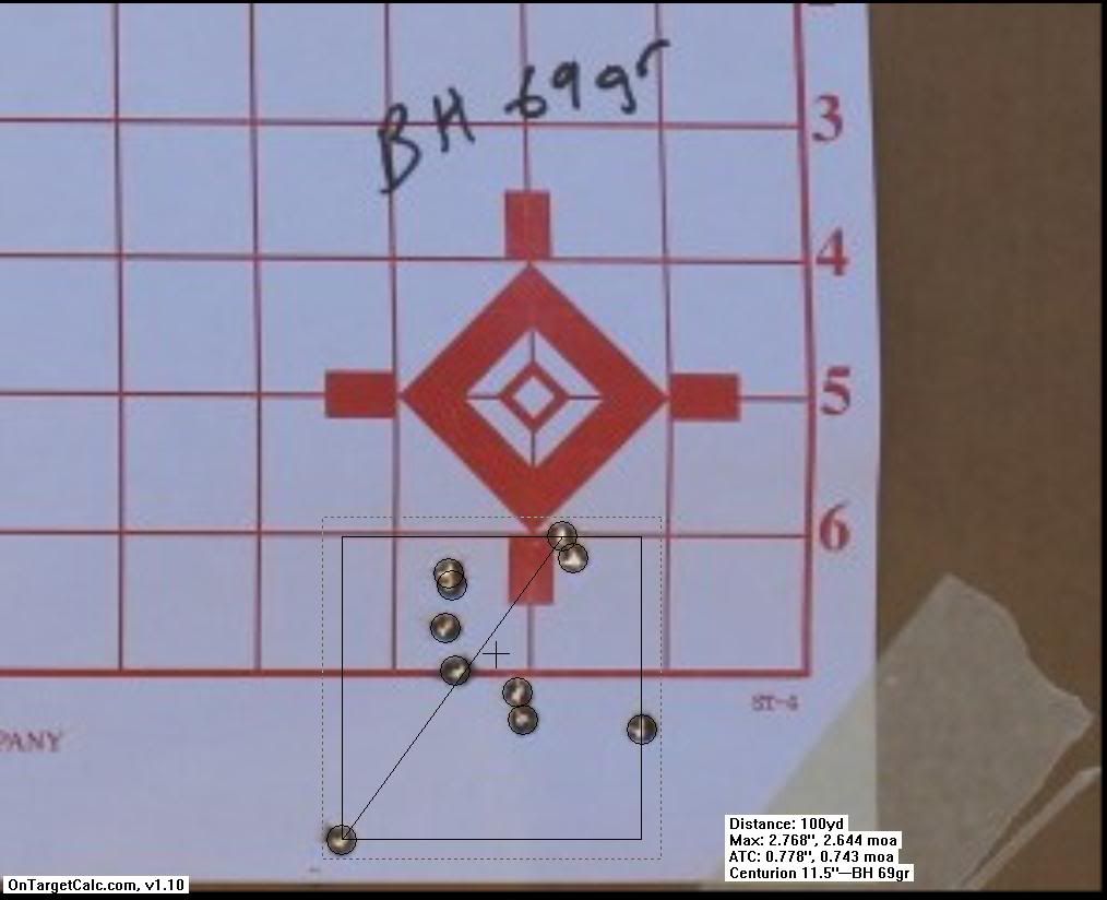

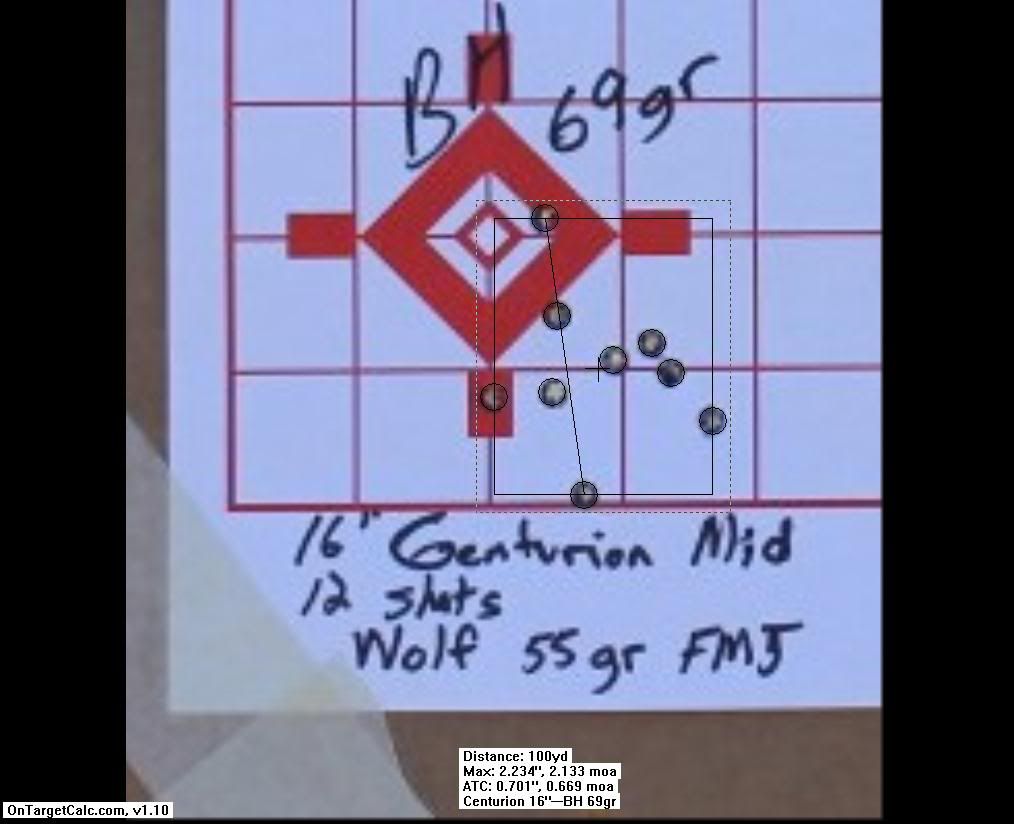

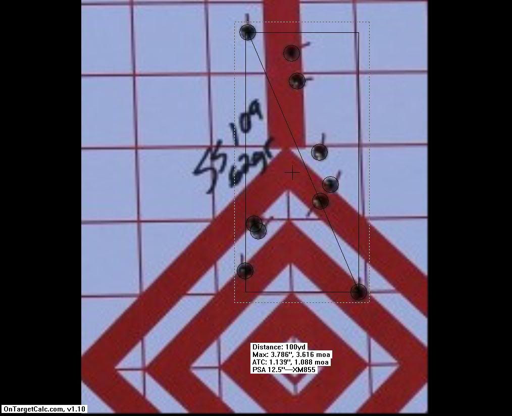

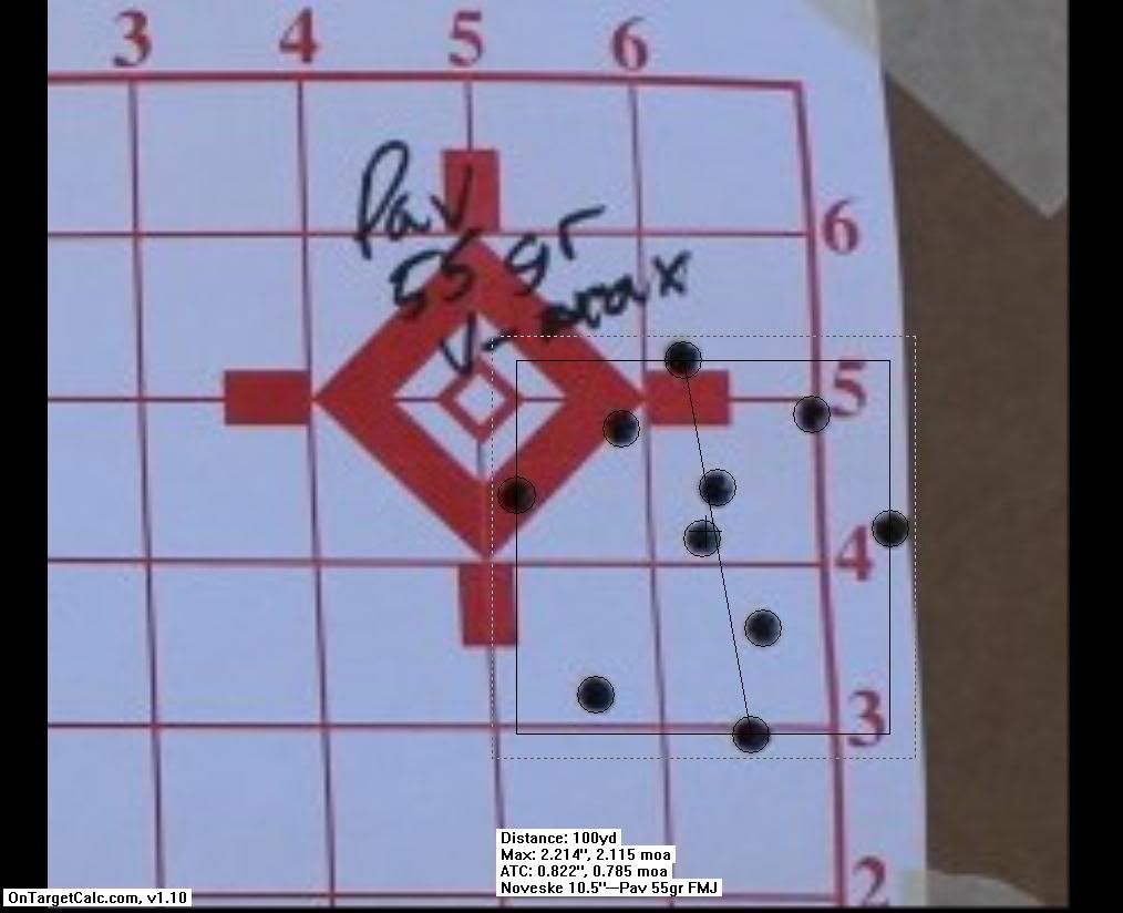

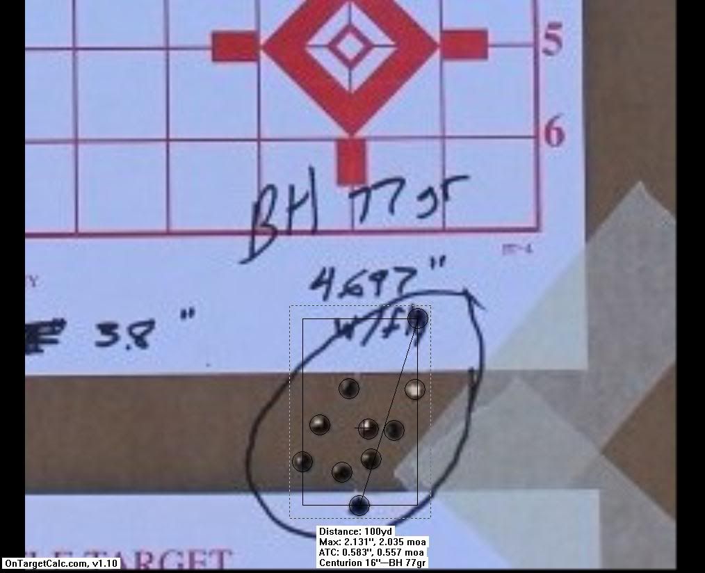

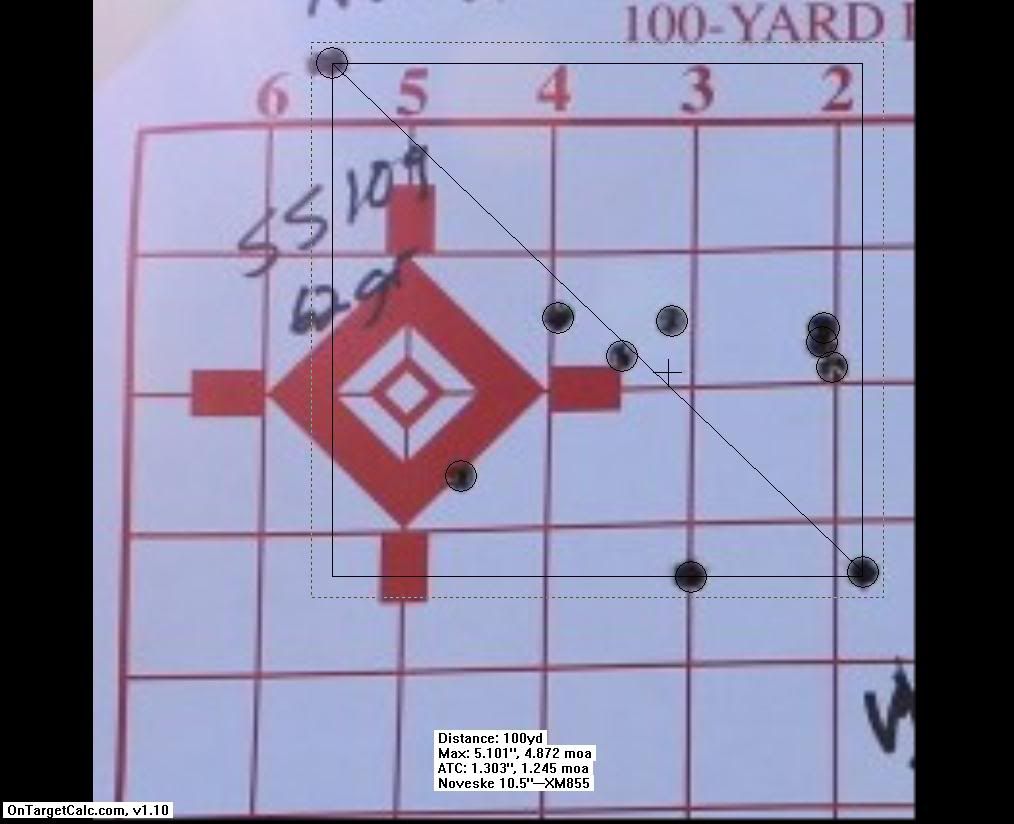

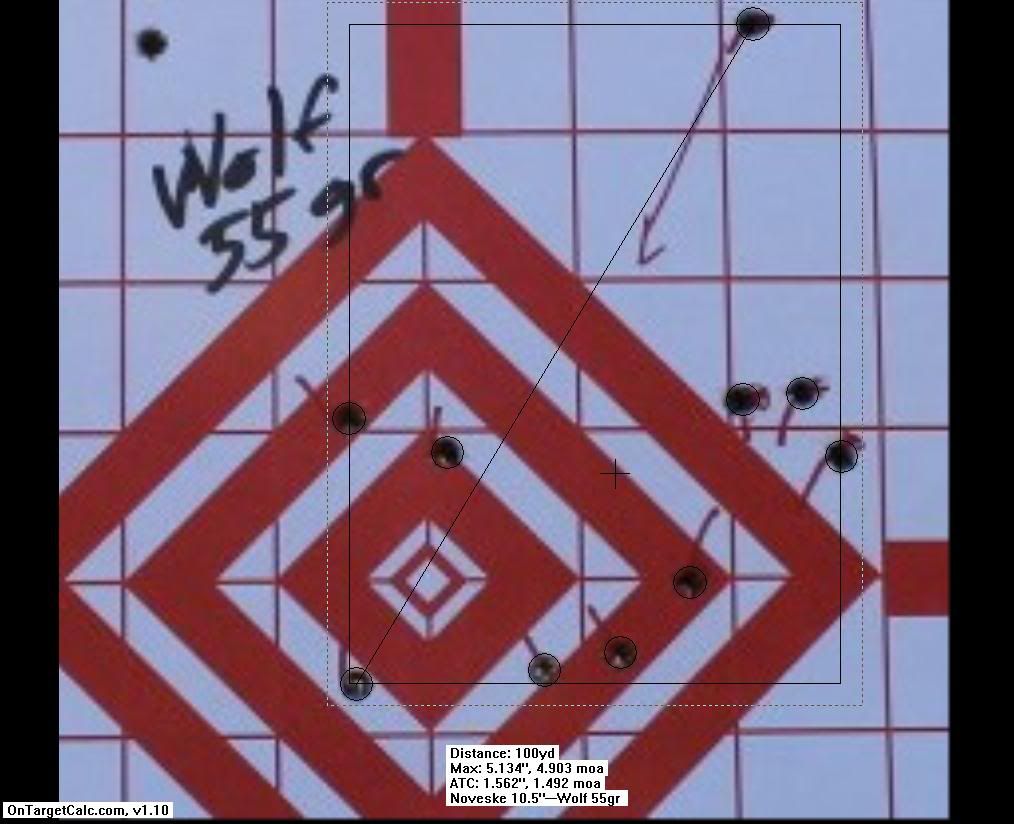

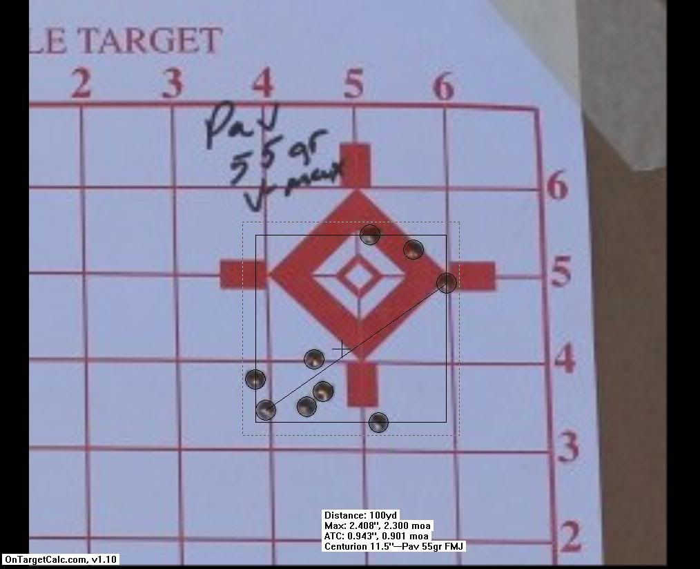

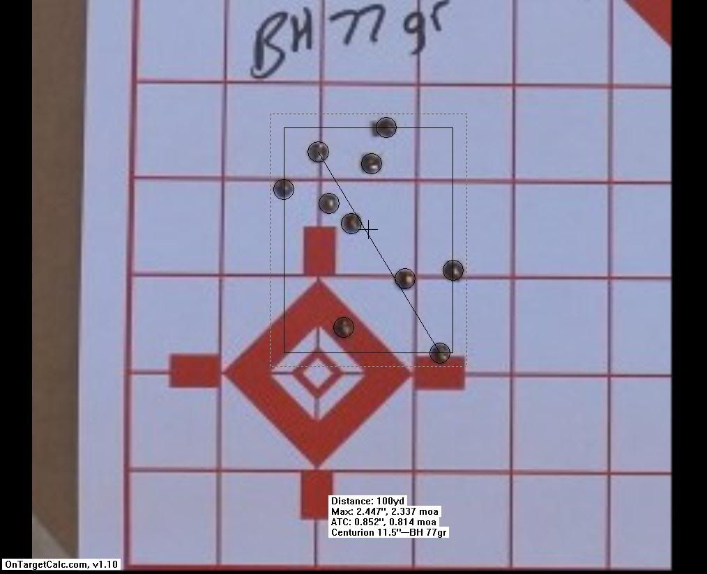

PLEASE NOTE THAT THERE ARE ONLY 9 SHOTS IN THE FOLLOWING GROUPS IN THE ABOVE PICTURES....
Centurion 11.5"/ Pav's 55gr, Centurion 16"/Black Hills 69gr, and Centurion 16" Black hills 77gr Originally Posted By InfiniteGrim:

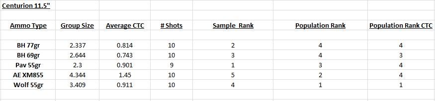

Hey OP do you have the fullsize pictures? I can split the pictures up by group and then use ON Target to calculate each group size. Its just that the resized versions on photobucket will make them look crappy. Peengwin has the pics. I don't have them, but can take some if you will email me. I will not be able to get a pic of the full Noveske 10.5"/Black Hills 77gr group as one shot was off paper. Neither will I be able to get a pic of the Centurion Arms 16"/ Black Hills 77gr group as all but one shot was off paper. I saved these pics from photobucket last night, opened them with Paint, enlarged them until the grids on the targets were 1" on my screen, then measured the groups with a micrometer. The grids measured 1" on my mic at the time of measuring the groups. If you can process the pics with "OnTarget", I will gladly post them in the OP if you email them to me or put them on imageshack. The groups are going to have the be calculated in 9 shot groups for Pav's handloads, Black Hills 69gr, and Black Hills 77gr. I'm not sure how it happened, but there are only 9 shots in 3 of the groups (Noveske 10.5"/Black Hills 77gr, Centruion Arms 11.5"/Pav's handloads, Centurion Arms 16"/Black Hills 69gr, and Centurion Arms 16"/Black hills 77gr). I assume that excluding the farthest shot from the 10 shot groups would be the way to do it. I would absolutely appreciate your help. |
I am a slave to my creations.... my image cannot be seen in them, but they bear my heart and soul - evl....

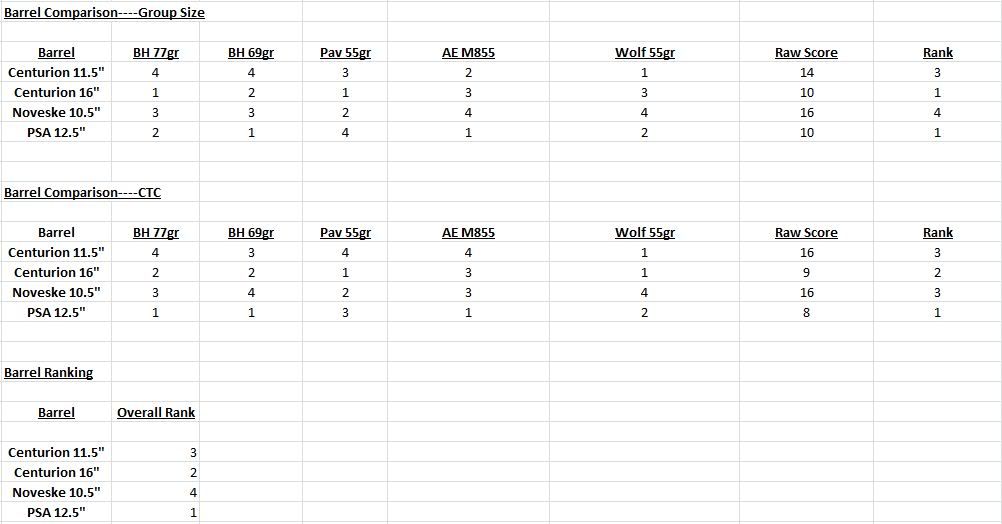

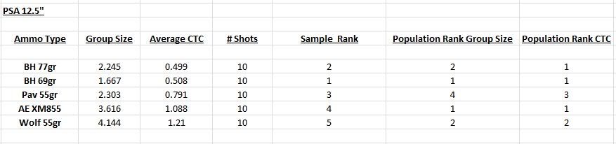

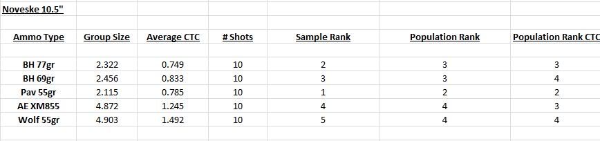

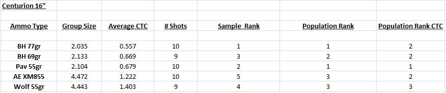

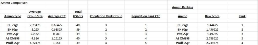

Too late already did them all, I just crunched a TON of numbers. Barrel Rank from best to worst : PSA 12.5">Centurion 16">Centurion11.5">Noveske10.5" I will get some pictures soon

Too late already did them all, I just crunched a TON of numbers. Barrel Rank from best to worst : PSA 12.5">Centurion 16">Centurion11.5">Noveske10.5" I will get some pictures soon PLEASE NOTE THAT THERE ARE ONLY 9 SHOTS IN THE FOLLOWING GROUPS IN THE ABOVE PICTURES.... Centurion 11.5"/ Pav's 55gr, Centurion 16"/Black Hills 69gr, and Centurion 16" Black hills 77gr What blew me away is that I thought the Noveske 10.5" would do better because of the thicker profile and less flex due to the shorter length. I was actually somewhat disappointed in how it stacked up against the others. It is still probably my favorite barrel. 10.5" ARs are certainly a good time |

Originally Posted By InfiniteGrim: ETA: HOLY SHIT! I just looked at the clock, that took me nearly 3 hours Thanks |
