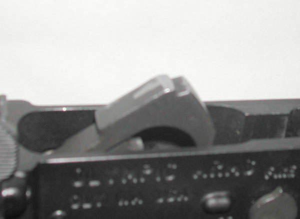

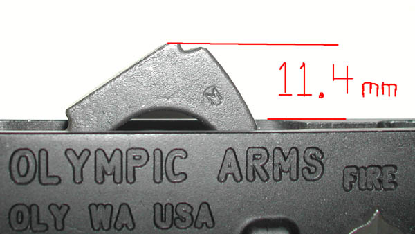

When used with slotted bolt carriers, hooked hammers can catch the underside of the firing pin, especially if the firing pin has a larger spool on it like those intended for the M16. The hammer will force the pin rearward against the firing pin retaining pin during the battery stroke. With repetition, this will bend the firing pin retaining pin. Sometimes the firing pin retaining pin is a simple, non-hardened, cotter pin. Some of these bend rather quickly. If you hold the trigger to the rear while working the bolt back and forth with the charging handle and the catch disappears you probably have an issue between the hammer and the firing pin. The best fix is to use a shrouded bolt carrier. You can also round the hook on the hammer to prevent it from snagging on the firing pin spool. A short trigger can also cause this by allowing the hammer to sit up too high when cocked.
Link Posted: 1/17/2006 10:38:03 PM EST
Link Posted: 1/19/2006 5:01:26 PM EST
You can try the fix that Randall has posted or just replace the hammer and spring... Either one should correct the problem...
