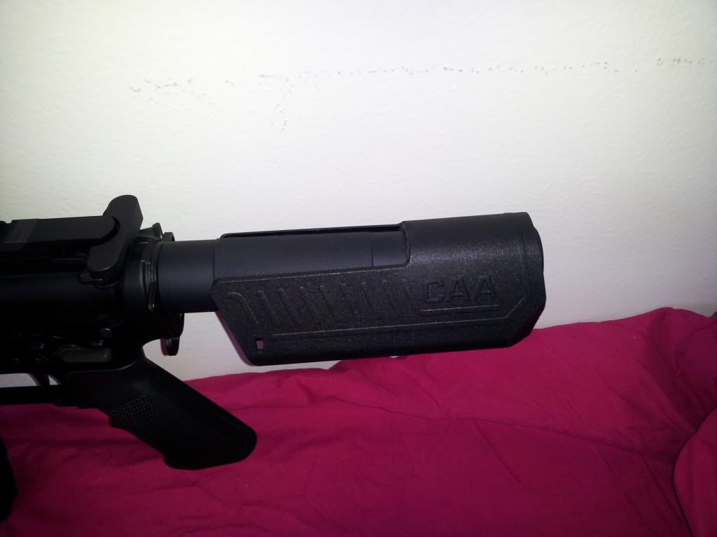

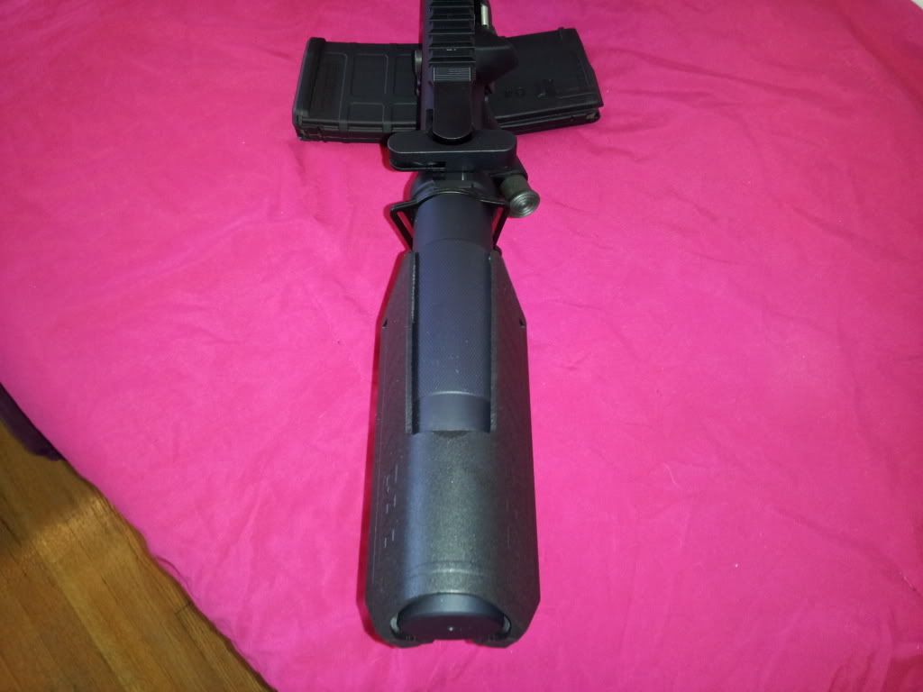

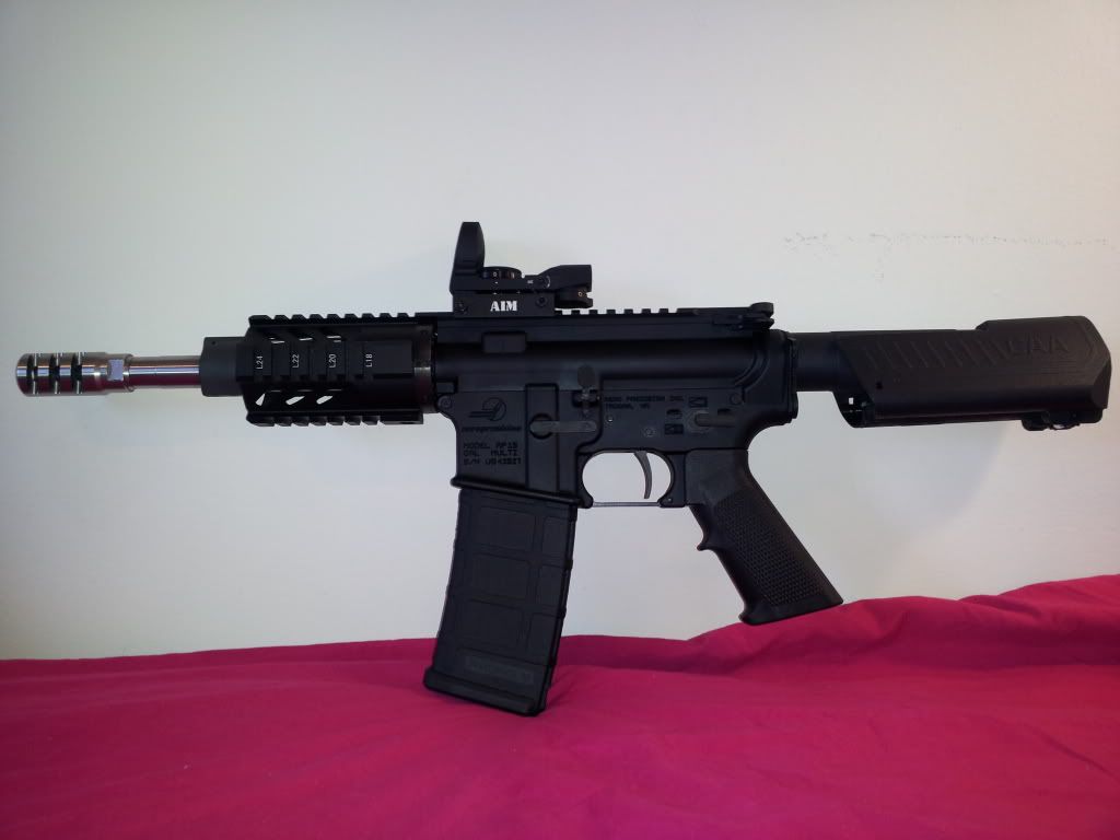

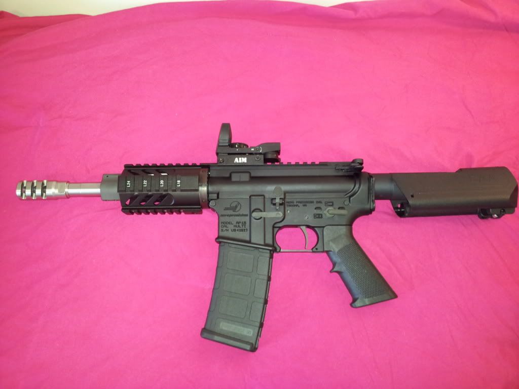

This is by no means professional, but here is what I used:
1) AP/Armaflex insulation tape. The dimensions are: 1/8" thick x 2" wide. One side has adhesive. I used two layers of this.
2) 1 "large" black zip tie to bring the rear ears together.
3) 1 "small" black zip tie. I drilled small holes in the storage compartments near the front (see link below for closeup pics) to keep the look "clean." haha or at least as clean as possible for a hack job.
4) A 5/16" x 1/4" aluminum sleeve. You can see in the closeup pics in the link how I used this. Again, it cleaned the look up slightly.
Closeup pics: http://s1054.photobucket.com/albums/s484/SilverLamp/Thunder/. Make sure to read the descriptions.
The gun is a John Evichin built 7.5" pistol with a stainless barrel and stainless flash enhancer. It's definitely the best looking and best quality gun in my collection. You can look him up on Gunbroker under "vanderjack."
http://i1054.photobucket.com/albums/s484/SilverLamp/Thunder/Thunder.jpg
http://i1054.photobucket.com/albums/s484/SilverLamp/Thunder/Topview.jpg
http://i1054.photobucket.com/albums/s484/SilverLamp/Thunder/Sideprofile.jpg
http://i1054.photobucket.com/albums/s484/SilverLamp/Thunder/Thunder3.jpg

Liked your idea SilverLamp on the bushing, I went with what I had available and cut down an old M9 hammer spring.
I put some black RTV on the buffer tube and slid the short foam pad over, cleaning off the excess.  Then I put more RTV on the underside of the saddle where it would rest on the foam.  Cinched it down tight overnight then next morning (today)  Wrapped the saddle with blue painters tape to keep it from wanting to spread out and clipped off the temporary wire ties.  I cut the hammer spring in the lengths that I wanted and fed the small wire tie thru each following SilverLamp's pics and tightened it down and PRESTO!
No wobble at all, actually feels like it's part of the tube.  I won't force it to see how much it can take but it's very firm.
Thanks SilverLamp, and I hope someone gets good use out of these tips ;-)
