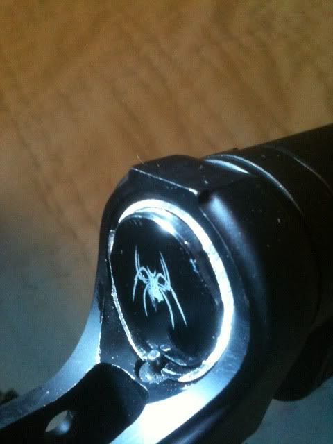

I posted a while back that I was having some fitment issues with my buffer tube.  If I threaded it in all the way to meet the retainer pin flushly, I could not seat the upper reciever into the lower. Short term solution was to back the tube out one turn, but then I encountered some stock wobble due to some slop in the groove with the pin.  This was all regardless of how much I torqued the castle nut.
So. . . I was drinking a beer and decided to investigate the situation further.  My final conclusion was that the buffer tube was just too long.  Now what?  Well I'll tell you. I decided to have another beer and use a bench grinder for some "custom fitting".  I ground off approximately 1 thread on the tube, but didn't grind on the lip where the retainer pin fits in.
From what I can tell, everything appears to be working normally.  I have not fired the gun yet though.
Was this a dumb ass move?

If you know what needed fitting and you feel confidant about it, go for it. I have to make different parts fit all the time. The market is flooded with AR parts and sometimes they are a little out of spec.
The only thing I would leave alone would be the trigger group. Fo safetys sake.

There was enough for a correct job. I used a small file to round off the edges and clean everything up.  Had it been a part that was much more expensive than a buffer tube, I probably would not have done it.  I figured that if I messed it up, I would just get another one and hope it was better.

Are you sure you didn't thread it on too far? Can you post some pics?

With the way that the retainer pin seats into the tube, I didn't think that "in too far" was a possiblity. . .  Am I wrong?

Yes. I'll say you went a bit too far.
Notching the bottom for the detent is not necessary, the tube only screws in enough to retain it on the edge.
Had you not cut that, the tube would not have extended past the receiver and the lower would have closed normally.
Thankfully, it's only a buffer tube you molested.

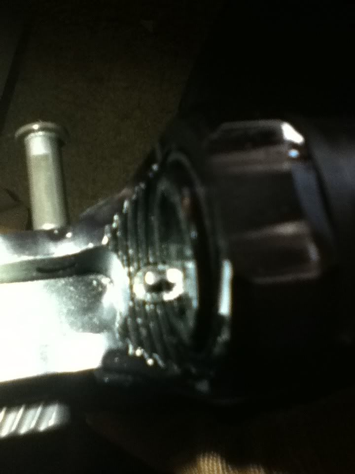

Hate to say it but it looks like your lower is out of spec. The buffer retainer detent was drilled to close to the fcg pocket. You can tell that by the way the buffer is sticking into the action by an 1/8th inch or so.

What lower is that?Nevermind saw that it was Spike's. I can't recall ever seeing a lower where the buffer retainer area was smooth like that. Plus, a tight castle nut should negate any wobble. Where is your takedown pin? I highly suspect there is something wrong with your lower.

Iv seen other tubes with the notch too, I think its a comm. tube
The tube is actually longer on the bottom edge too, then notched.

I have 1 rifle that has a comm buffer tube and it is not longer or notched!

Yes, commercial tube. It came notched like that.
And my takedown pin is right where it's supposed to be I would think. It lines up perfect with the upper receiver.

your receiver extension looks like it would have fit perfectly. the wobble you described is fairly normal until you tighten down the castle nut properly, you are using a castle nut wrench, correct?
all you've really done is used the buffer retaining pin to keep the receiver extension from moving. since you didn't fix the source of the problem, too much play in the receiver extension/endplate or not enough torque on the castle nut, eventually the soft bare aluminum is going to be wallowed out by the steel pin and you'll be back to square one.

Good point abou the aluminum on steel, I hadn't thought of that.  Yes, I used a castle nut wrench.  The big problem was that whenever I would get it tight enough to eleminate wobble, then the stock would have torqed a little bit too and the stock was no longer vertically in line with the gun.  It ended up sloping from right to left.

Did you install your end plate?
And if you did, why didn't you install the takedown pin?

Yep, got the endplate on there. Take down pin is present too, just not in the picture.

you have to hold it straight while tightening it if there is that much play in the receiver extension kit...
you can't just torque something down and "wish it" to line up.
Link Posted: 3/15/2011 9:11:33 AM EST
Biggest thing that stands out to me is that the OP was expecting the extension tube to butt all the way up to the retaining pin when it only needs to screw in just deep enough to "retain" the pin which means simply enough to overlap the ede of of your retaining pin.  Had you done that your extension would not have protruded so far as to make it hard to seat the upper receiver.

This pretty much sums it up.  When I did it this way (as stated above) everything fit properly, but I was having stock wobble issues––which meant I should've focused more on the castle nut than the tube.  Oh well, looks like I'll be buying a PWS Enhanced Buffer Tube now. Darn.
On the other hand, does anybody else have any input on the lower receiver being out of spec?!?!?  The thought never crossed my mind until people started talking about it.
But the gun functions fine, so even if it were out of spec, apparently it doesn't matter?

You should NOT have to do this to a receiver extension (a.k.a. buffer tube).  Those that think this is a good "solution", or whatever, shouldn't be working on these guns.
Link Posted: 3/15/2011 3:15:32 PM EST
Agreed.

Link Posted: 3/15/2011 3:51:23 PM EST
You did good.
Remember the rules of home gunsmithing:
Measure it with a micrometer,
mark it with chalk,
cut it with a torch/dremel,
grind it to fit,
paint it to match!

only worry about 'in too far' is if the stock doesn't latch on it's most collapsed position.

From what I can see in the OP pictures I don't see anything "wrong" with the solution.  The buffer tube came from the factory with the notch and the tube is threaded in far enough so the protruding pin is in and at the back of the notch.  If the castle nut is torqued correctly it will work.   It appears that the tube had excess  front lip material and would not let the upper fit correctly.
One should not have to trim any parts and a call to the supplier probably would have gotten a replacement on the way for free, but I don't know and my luck with getting bad parts replaced may be different than the OPs.

Looks to me like you screwed that buffer tube too far in; if you would've done it correctly, no dremeling would've been necessary.
Is the buffer tube Milspec or Commercial? If it was a Milspec tube then you screwed up, if it was a commercial tube, then perhaps your screwup would not be as bad, but a screwup nonetheless. Lucky for you, milspec buffer tubes are easy to find and you did not go medieval with the lower; then you'd really be up sh*t creek without a paddle.

soon you going to wear the top of your buffer from the upper pushing it back when you close the door....but if it works then dont fix it yet..
Link Posted: 3/15/2011 4:44:05 PM EST
The carrier is supposed to push the buffer slightly back when you close the two receiver halves together.

Ok, let me answer some questions here:
The receiver extension in a commercial one.
Yes, it is indeed a Spikes lower.
I didn't know my imageshack account was going to get plundered, but I don't really mind.  On the other hand, I didn't know that could happen and I will probably lock it just becasue I don't want every Tom, Dick and Harry rifling through my pics and making a list of what I own.
I'm probably going to scrap the tube that I raped and buy a mil-spec version.  Kinda sucks since my CTR stock is made to commercial spec though, but I didn't know about the whole "mil-spec" vs. "commercial" when I started the build.  If I had known, I probably would've gone mil-spec just because it seems more logical.
Somebody posted some good pics of other lowers (don't recall who Black-Tiger, but thanks!) and the only difference I see is the location of the hole for the retainer pin and the the threading going all the way into the lower.  I assume that's not a problem for me though.

I'm thinking the Buffer tube is out of spec. This also leads me to think that the stock will probably have some wiggle to it. Yes there is a differance between brands. You don't need the expensive PWS tube to fix this. Order a new one from Bravo. Reread the instructions on the sticky  of this forums on building a Ar. Install with the plate and castle nut. It make take acouple of tries when to tighten the castle nut to get the tube straight.
