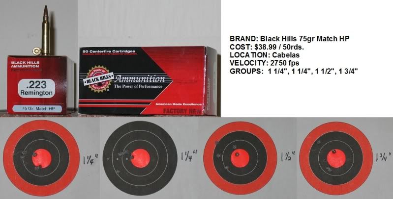

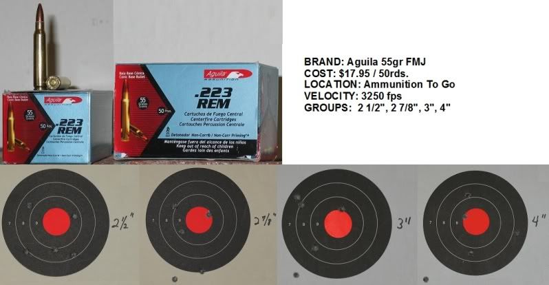

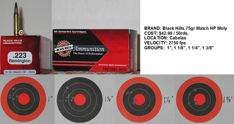

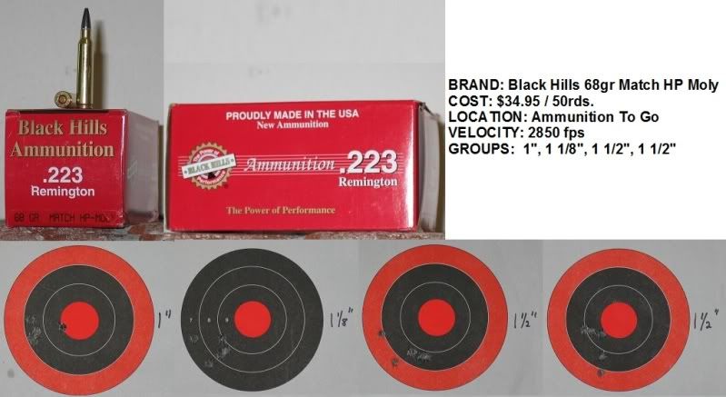

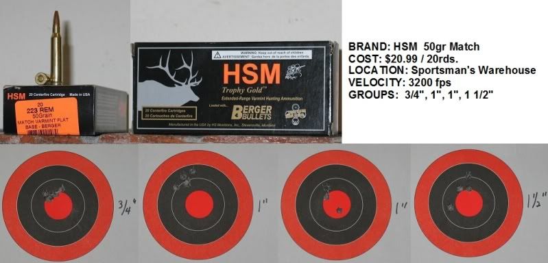

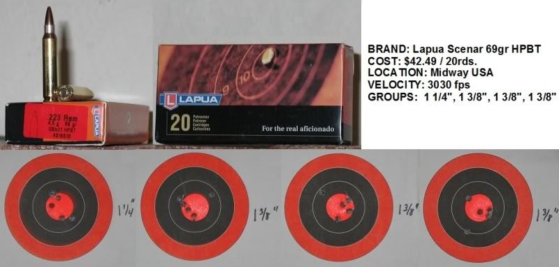

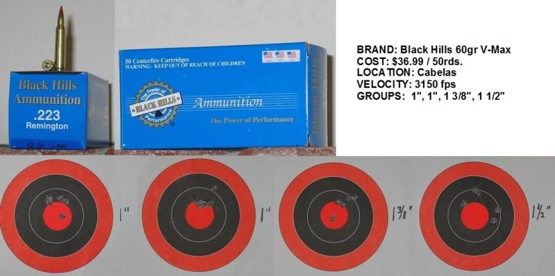

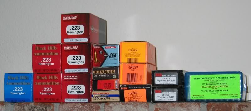

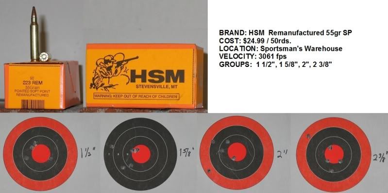

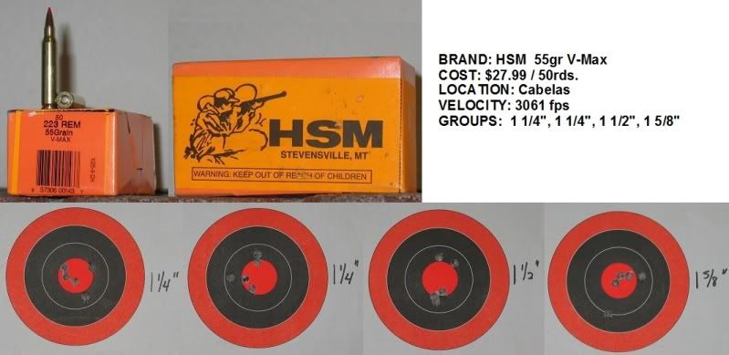

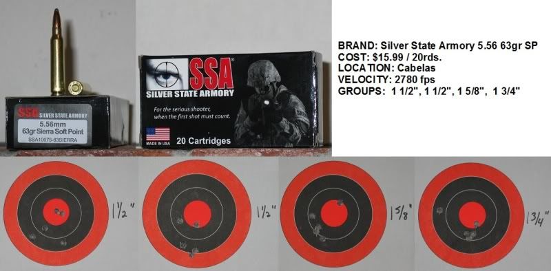

Well I finally received the rest of the ammo I ordered from last year (it'd been on backorder for months). I was also able to find some new ammo along the way.
Now that the weather has calmed down I have finally completed testing them. Below is a test of another 16 different types of .223/5.56 ammo.

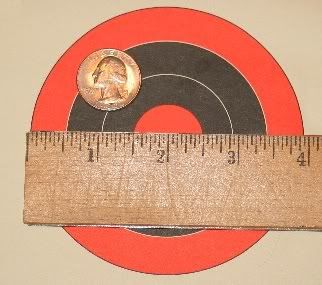

If you missed my original test of 60 different types of .223 / 5.56 ammo go HERE The targets I used are the Hoppes S-12 50-Yard Small Bore Rifle targets that come 5 to a page. Each target measures 4 inches across. I placed 1" orange dot stickers in the middle of the targets for easier target centering while aiming.
All shots were fired from 100 yards. Five shot groups were fired from each bullet type and repeated 4 times for consistency checking. The groups are displayed from smallest to largest and not in order of firing. Wind was less than 10mph each day of shooting. The rifle used is as follows: Rock River Arms Upper 24 inch stainless Bull barrel in .223 Wylde chamber with 1:8 twist Spike’s Tactical Lower Rock River Arms 2-stage trigger. Vortex 6-24X50mm scope
I apologize as I don't have a chronograph so the velocities listed are stated and not actual.

Great report! Once again, Black Hills shows to be consistently accurate ammo. I need to buy more. Three questions:
1. Are the results in order, top to bottom, as your testing went on that day? 2. Did you adjust your optics as the day went on? Seems like your groups slowly moved toward center as the tests continued. 3. How do you like the Vortex scope? Not to get off topic, but, I'm considering a Vortex Viper PST 6-24x50 FFP for my RRA LAR-8 Varmint. |

looks like my rifle is not the only one that likes Black Hills |

Great report! Once again, Black Hills shows to be consistently accurate ammo. I need to buy more. Three questions: 1. Are the results in order, top to bottom, as your testing went on that day? 2. Did you adjust your optics as the day went on? Seems like your groups slowly moved toward center as the tests continued. 3. How do you like the Vortex scope? Not to get off topic, but, I'm considering a Vortex Viper PST 6-24x50 FFP for my RRA LAR-8 Varmint. No doubt, Black Hills makes quality ammo. A1). The posted results are not in order shot. In fact these different ammo brands were shot over several days. A2). I didn't adjust my scope but I did have to change my point of impact I was aiming for with the Winchester Ranger ammo.The last target shown was actually my first target shot. The shots were unexpectedly high in the first test and I had to aim lower to keep the remaining 3 groups on target. A3). I love the Vortex scope. People at the range often ask to look through it and are amazed. The customer service at Vortex is unparalleled. -Cody |

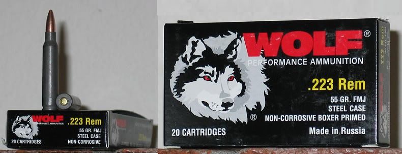

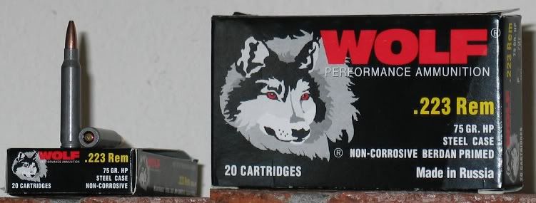

Thanks again guys. The only problems I had were with Wolf steel cased ammo. It wouldn't cycle and the cases got stuck so i never completed testing them.

Originally Posted By Cody47: Thanks again guys. The only problems I had were with Wolf steel cased ammo. It wouldn't cycle and the cases got stuck so i never completed testing them. i did start testing in a 1/7 twist chrome lined BCM 16" barrel but the results were so poor it wasn't worth posting. Maybe one of these days I'll get another stainless barrel but in 1/7 or 1/9 and test it. I know every barrel shoots different but I'm just trying to show what the ammo is capable of in general. -Cody Was the wolf Polymer or Lacquer coated? |

Awesome. The Black Hills did well
But...I think all of the ammo proved to be sufficiently accurate for most applications. I work in a small urban town, and don't ever see myself taking a 100 yard shot while on duty because that would be an almost two block long shot. I don't think I need to spend the money on the BH because we have to supply our own. I am using the AE Tactical 5.56. Thanks for the research. |
