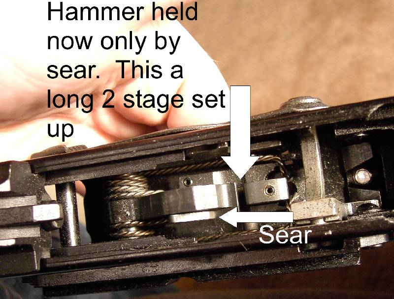

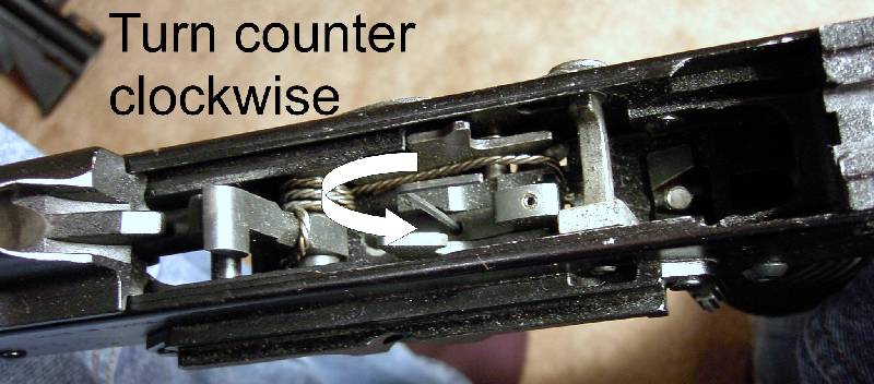

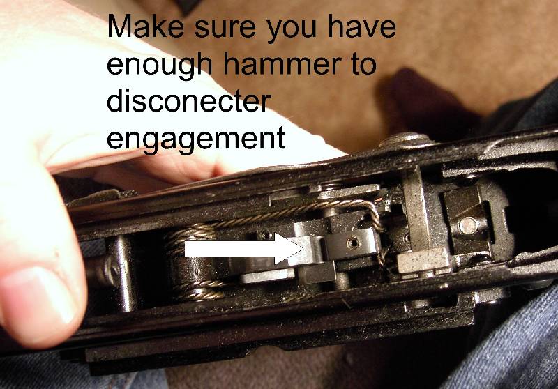

[Last Edit: 1/23/2006 3:43:07 PM EST by KenR_RedStarArms]
Link Posted: 1/23/2006 4:12:10 PM EST
As I don't have an RSA FCG, I can see now that the profile is such that hangups should not really occur, that RSA hammer profile is totally superior to the G2, so the adjustments should work.
