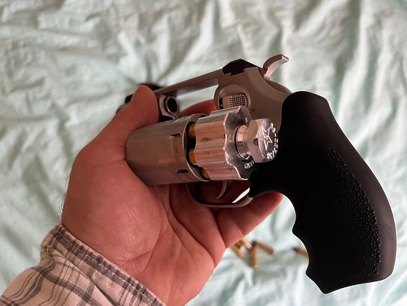

45 win mag brass in .45ACP moon clips in a .45 coltAttachment Attached File

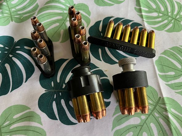

3) There are lots of speed loader and speed strip options and they all have pros and cons.  I have four different brands of speed loaders for various revolvers plus speed strips and the K-Pak variant on the speed strip.  They all have their place and their specific uses, and one isn’t best for everything.
Some hold the bullets snugger than others while some are looser. What works best can depend on the revolver, the caliber and bullets being used and the grips.

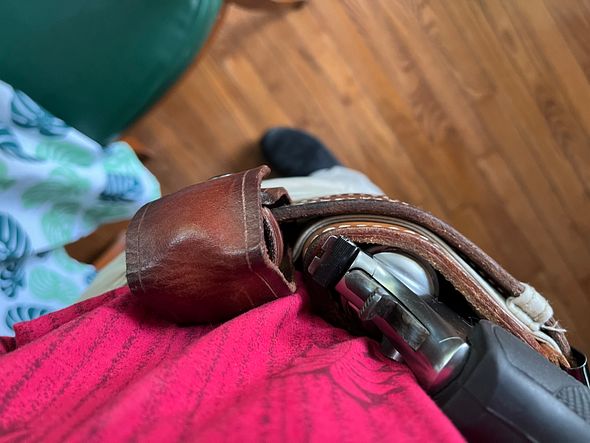

Speed loaders can be carried pretty low profile with a slip over speed loader carrier:
But sometimes a speed strip can be a better choice, and I like the K-Pack speed strip as you can load six rounds in not much more time than a speed loader with practice.
