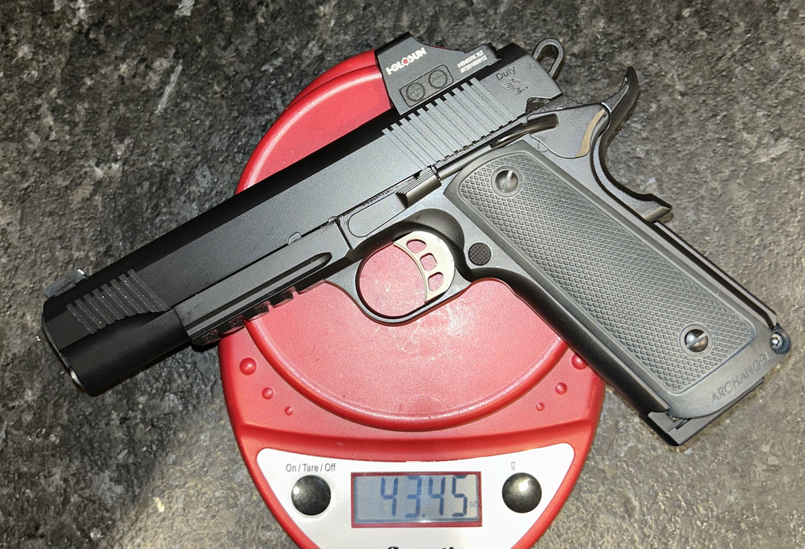

Shot a few pics and reassembled.  Visually the product is very nice.  I chose Graphite Black Cerakote which seems to match the Tisas finish.  The Cerakote job by Green Tick looks perfect.  Milling also looks perfect.  I did not send in my optic with the slide and I literally had to lubricate the optic cut to fit my optic.  I did opt for a 407k vs the EPS because I will never carry this and I saved $100.  Slide cut included mounting screws which I used.
Total cost $144 milled/coated/returned plus $10.50 outgoing Priority Mail.  Sight in soon.  I forgot to mention, included is sight removal and reinstallation.
Looks good. Still waiting on mine.

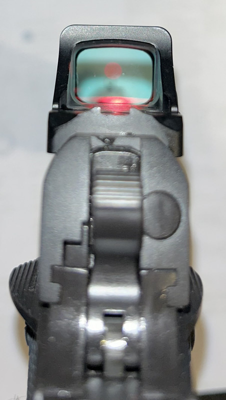

Looks great, I wonder if there is a way to keep your rear sight?
Link Posted: 10/17/2023 2:19:54 PM EST
[Last Edit: dogtired] [#24]
I chose the Holosun as it has a rudimentary rear sight built in.

Please post how the POA and POI works out (elevation, with the 407 integrated rear sight).
Link Posted: 10/26/2023 11:26:56 AM EST
That was the first thing I tested.  Using existing sights it shot a hair low, using front sight in middle of window it was slightly high.  Not enough for me to alter height of front sight.
