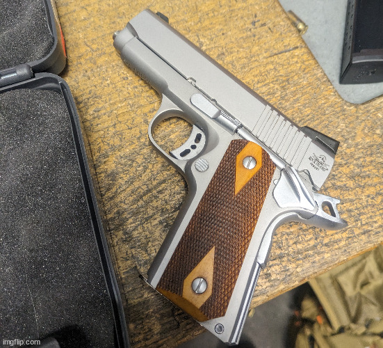

I took my new 9mm RIA to the range today and was left disappointed. I had a great .45 from them a decade ago and was hoping that this was gonna be a great little carry gun, but right now it's looking more like a good looking paperweight.
I put about 150 rounds of Winchester 115gr through it, and in the probably 20 mags I forced through it, not a single one was problem free. If it wasn't double feeding, it was failing to eject, and much more commonly it wasn't returning to battery. You could kind of flick your wrist forward and the slide would then close all the way, but that's just ridiculous to me. Even the thumb safety was sticking so bad that it was almost unusable. You could engage it, but it was almost impossible to disengage it though it got a little better after using it for a while, but its still not in what I consider a working condition.
I used the factory mag, and nothing else. I do plan on buying more but now I'm unsure if the mag was part of the problem or not. If someone has better mag suggestions then the MM ones that came with it I'm all ears.
Here's a few pics of the most common issues I had today. I'm guessing that the recoil spring could be part of the problem? The 3rd pic shows it out of battery, and for the majority of shots it was giving me this issue.
My brother was already trying to convince me to return it for service for the thumb safety being so bad, but I thought if that was the only issue then fuck it I'll just replace it with a better one anyways. But with the rest of the issues I'm wondering if I should just send it back and let them sort it out.

First pic is a failure to extract.
Most likely you have a ill fitted extractor Steves Extractor Guide thats FANTASTIC
the problem you describe on the flicking your wrist sounds like a sticking or ill fit disconnector catching the slide. Could be a too light recoil spring.
If you are going to start throwing money at it to fix it without knowing whats wrong I would suggest you send it back.
Your Safety problem is probably easily fixed with a little sandpaper but thats a delicate job and sand the wrong area and you ruin the safety and create an unsafe firearm.
1911s are NOT like polymer guns, you cant just change whatever you want, nearly every part on the gun Normally WILL need fitting for proper function. At the top of that list beyond the normal Slide to frame and Barrel fitting is the Extractor, Safety and Trigger and every part that engages with them.
Yes your recoil spring my be too heavy or too light but you have an extractor problem which is all but guarenteed by the (assumed) fired round still in the chamber in your first pic.
wouldnt surprise me if you have a mag problem too but you need to start with the extractor fitting.
THese are NOT crazy hard jobs but you have to decide if you have the mechanical ability and time to fix it, or if you just want to take the easy route and send it back.
if you decide to do it yourself just realize you will spend some time Learning and may screw up something in the process but when youre done youll have a much better understanding of the 1911 and how it works and how to fix it to keep it running.
The other side to that is since you seem to have multiple problems you might find more problems as you get into it.

I think we need to define terms
A failure to "Eject" can be many things but normally its involving a case that has been fired and has been removed from the chamber not finding its way out of the port. in a 1911 this will most commonly be Ammo, Springs, extractor, ejector
A failure to "Extract" is a fired case that has not been removed from the chamber, which I believe is what you show in the picture.  I would like you to explain the too light recoil spring causing that please. (the extractor doesnt LOSE tension because the recoil spring is too light)  Also explain a Mag causing this please.
Too HEAVY a spring might cause it by not letting the slide operate, HOWEVER if that happens and your Extractor is set up correctly it will extract the case when you manually operate the slide.  (slide will most likely not move rearward enough to TRY to chamber a new round either) Too light will eject the case with more force.
a "Double feed" is two UNFIRED rounds trying to occupy the chamber at the same time, That generally is a Mag issue.

Your chamber likely needs finish reamed and your extractor tuned.
If you’re unable to do those things I would send it back with photos to be repaired.
Also, Winchester WB 115 gr is about the worst commercial ammo available. I would suggest some higher quality 124 gr fmj for your next go around (after repairs are made) and a couple different magazine brands to try out.
Once you get a couple hundred problem free rounds through it you can fine tune recoil spring rates etc, with the ammo you choose.

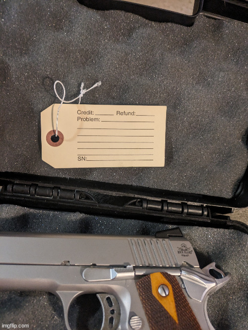

Gotcha, Ya so It would usually eject so I guess it would be more of a failure to extract. I didn't take pictures of every failure for obvious reasons but most of the time I had to take the mag out, cycle the slide to fix the issue and then reload.
The mag issue is a bit harder because I'm really not entirely sure what options I have because of the type of mag it is. I got lucky and found another RIA branded mag at the range and bought it, but I'm unsure of what mags will work with this because its a 8 round, 9mm mag. Hopefully someone else makes some so I can compare.
Here's a gif that shows the biggest issue. (I apologize for my disgusting hands, I'm a welder and the dirt is ingrained in my pores now lol)
After firing, and then flicking it forward it would fire again assuming that it didn't double feed or otherwise jam.

You may not need to mess with the recoil spring at all. I think you have a tight chamber / extractor issue / ammo issue in that order. I’d wager that if RIA finish reams your chamber, tunes your extractor and you feed it some 124 gr fmj it will run like a top.
Keep in mind however that the shorter the barrel length the more finicky a 1911 platform pistol can be to tune so some patience and trial and error may be necessary.
Also, when you get new magazines load them a few days before you go to the range to let the springs take a set.

you have an extractor problem, and possibly a mag problem. You are seeing the extractor nose contacting the rim of the case, its tension is bad because all it takes is a flick of your wrist to close the slide.
2nd problem is your mag is allowing it to push feed in front of the extractor rather than being controlled by it. You could install a stronger recoil spring and it may solve the problem until you snap the tip off of your extractor which will happen if you keep doing that.
unfortunately I have no Idea about mags, the gold standard in a full size (IMO) is the MecGar and there is a knockoff out there that LOOKS like it but is not on close inspection. Tisas ships them... they LOOK like it until you put them side by side and then .... THEY DONT.  They should work with your gun but they are 10 round and will obviously stick out of the bottom of the gun.
They may also make a shorter mag, someone does, I have seen some place where they actually mod the mags to fit correctly but I dont remember who or where or how much.
Its a short 9mm though and as noted above its going to be more sensitive to everything being correct to work right and be reliable. A full size is easier to tune.
And dont applolgize for working for a living, EVER!
my personal advise to you, Send it back.
If not, I would buy another extractor and practice fitting the stock one but I wouldnt trust it to be right. Then when you understand how its done work on the new one (EGW IMO is the place to go here and for the stop) . I would also replace the Firing pin stop with a fitted one (it controls the extractor fitting). I would do some research on mags and buy good ones. baring that for a quick learning experience buy a MecGar - you can find them online for less than $20 and see if that makes it work. I think your springs are fine at the moment.
Last you should check the breachface and make sure it is SMOOTH and has no irregularities, thats a common issue with 1911s and as the price goes down the likelyhood of that exsisting goes up. especially look in the corner on the Opposite side of the ejection port.  If you see something wrong there, SEND IT BACK and note it when you do. not that you cant fix it but thats a pretty touchy place to start learning on.
Good luck.
edited to add, its a 1911, ride the thumb safety with your thumb, it helps with control AND it MAKES you get as high on the gun as you can.

Ok to here's the latest pictures and an update from RIA's RMA ticket.
I'm now a bit pissed to be honest. My brother had convinced me that it would be nice and easy to send it back for repairs. Well they finally got back to me yesterday. I have to go find an FFL thats open super late or deal with the odd hours/take off time from work to go to the one I used to do the original transfer AND I get to pay for the transfer back to them, because they no longer allow you to just pop it in the mail/have it repaired and returned to your home. They won't even issue a return mail sticker until the dealer sends them their FFL paperwork.
Attachment Attached File
I waited to respond until I could get by the range today to try both the new mag and the 124gr ammo.
The issue with the gun not returning to battery was still going on and the number one issue, followed closely by what I was able to get a few pictures of. As soon as it had a malfunction I immediately set it down and took a pic to show exactly how it was failing. Whats interesting is the round in the chamber shown in these is live. It seemed to eject the spent casing this time but whatever the hell is going on, it would then fail to finish chamber a new round all the way.
I used a box of 124gr Blazer and a mag of Norma 124gr before I gave up trying to get it to run. I was able to get a whole 5 rounds off without failure once before it had another failure that required me to drop the mag and clear it.
One thing that is abundantly clear, is the factory mag is definitely an issue. In the first pic, I was able to show the malfunction and what the seated round looked like in the magazine after I dropped it. Its clearly not seated all the way back and I'm sure that some of the issues are related to these trash ass mags. I marked the factory mag, and noticed no difference between that one and the one I bought (same manufacturer, RIA branded mag)

I still think you're going to be really happy with it when all is said and done & it's running reliably.
I thought about updating it, but I have honestly been so pissed with the whole situation I figured I would wait until there was some positive resolution.
But the reality is it's now October and I still have a broken gun, and am still waiting for RIA to send the fucking return mailing info to the FFL.
After going back and forth with them, I was finally able to get them to agree to the return, and I took time out of my day to go to my FFL and have him send his paperwork copy. After waiting about 3-4 days with no updates I finally get an email telling me they are going to close the complaint because they didn't get the info. So I explain I watched him send the email while I was there, and then they say no problem we'll reach out directly. Another week goes by and they said they couldn't reach him, and were going to close the complaint again. I say fuck it, I'll go by again and this time I write down every single bit of info for my FFL to include in his email and now its been over a week and they went ghost. I emailed to find out if they got it and they just never responded.
I'm bewildered at what to do at this point, and beyond irritated. I'm at the point now of giving up, and ordering the parts and paying someone to install them locally or something. Its been a joke.

Link Posted: 12/2/2023 9:57:32 AM EST
Well guys I got a nice surprise this morning, the FFL texted me my gun was back and ready to get picked up!
Which worked out great because I had already planned to go to the range so my wife and get a bit of time shooting her Christmas present (Xmacro) so I'll be able to put some rounds through it this time
Now I just pray that its fixed and not in need a anything else. (besides what I want to upgrade myself)
Link Posted: 12/2/2023 11:50:54 PM EST
And now for the range report.
First round was a malfunction I put one mag through it and the same slide not returning to battery happened with every round. So exactly the same problems as before and of course the RMA tag from the armorer who "looked at it" was blank.
I have absolutely no clue if they even did a single thing.
I'll be honest I'm so pissed at RIA that I can't even stand to look at it right now. They never even emailed me they received it, and wrote nothing on the card. Just absolute piss poor customer service.

Link Posted: Yesterday 10:58:53 PM EST
[Last Edit: stiglitz_actual] [#48]
Edit: I misread your earlier posts, the pictures are of malfunctions
Sorry you're having so many troubles with this thing
It doesn't look like you've tried swapping out the recoil spring yet, think that is worth trying
Factory spring is 16lb on the RIA cs/officer models
A stronger string might help with cycling during breakin along w/ hotter 124gr NATO ammo, but could mask a deeper issue too
Wolff has varying weights for Colt officer models, EGW makes flatwire springs but they require a different guiderod
