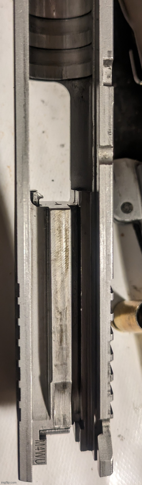

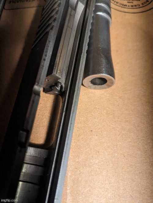

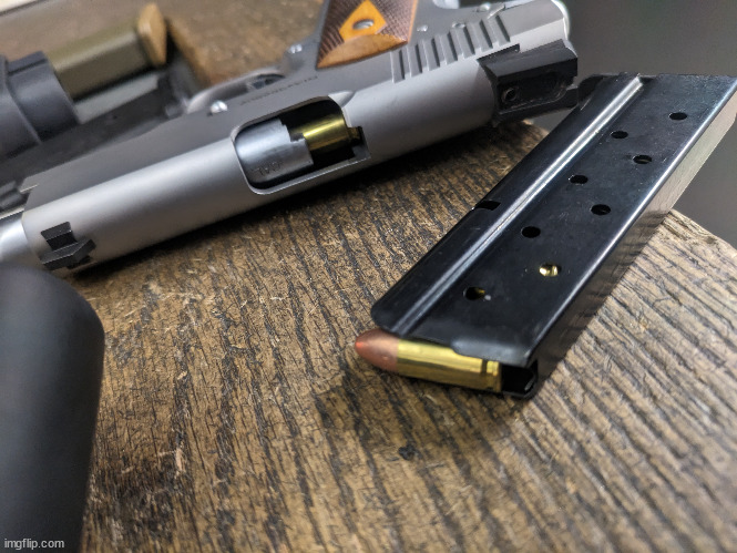

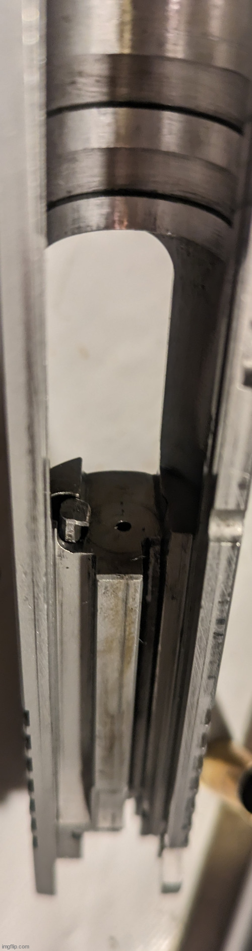

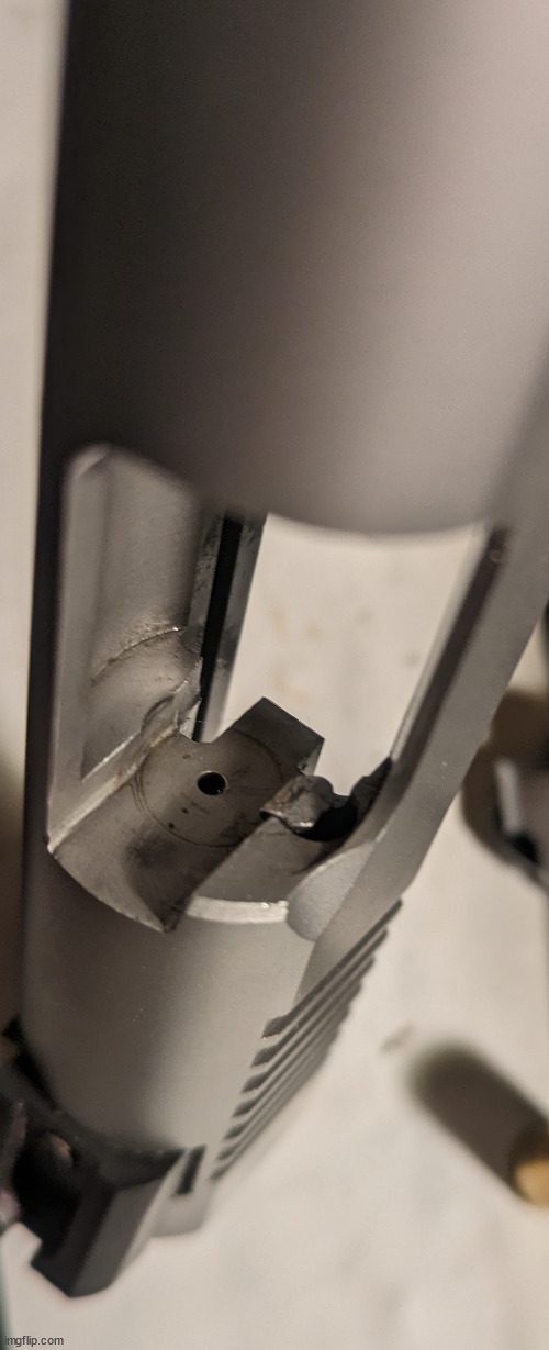

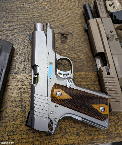

I took my new 9mm RIA to the range today and was left disappointed. I had a great .45 from them a decade ago and was hoping that this was gonna be a great little carry gun, but right now it's looking more like a good looking paperweight.
I put about 150 rounds of Winchester 115gr through it, and in the probably 20 mags I forced through it, not a single one was problem free. If it wasn't double feeding, it was failing to eject, and much more commonly it wasn't returning to battery. You could kind of flick your wrist forward and the slide would then close all the way, but that's just ridiculous to me. Even the thumb safety was sticking so bad that it was almost unusable. You could engage it, but it was almost impossible to disengage it though it got a little better after using it for a while, but its still not in what I consider a working condition.
I used the factory mag, and nothing else. I do plan on buying more but now I'm unsure if the mag was part of the problem or not. If someone has better mag suggestions then the MM ones that came with it I'm all ears.

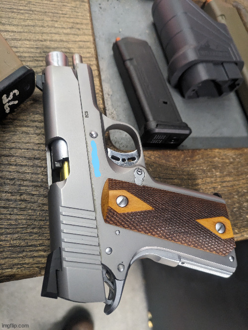

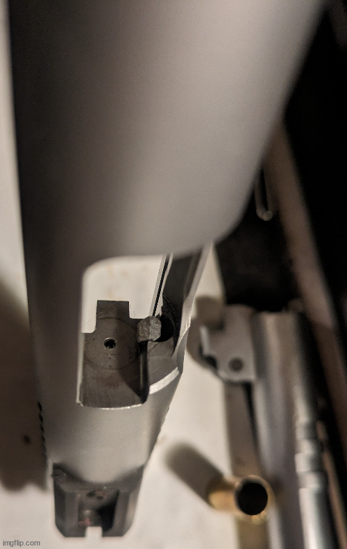

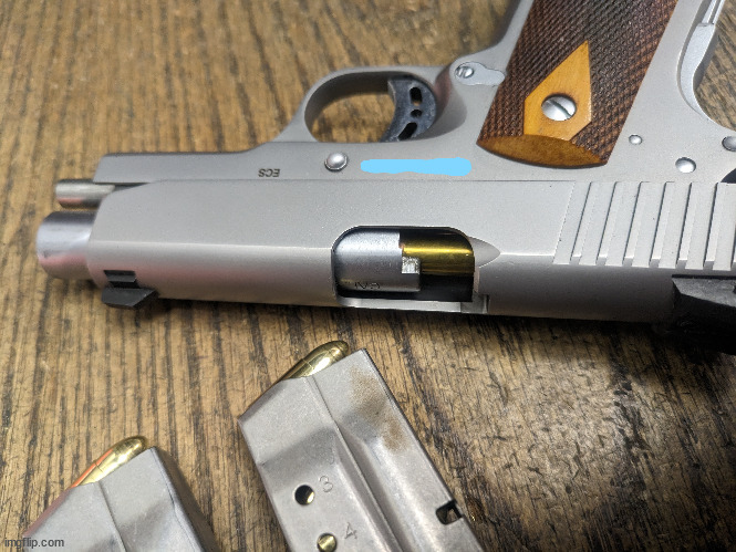

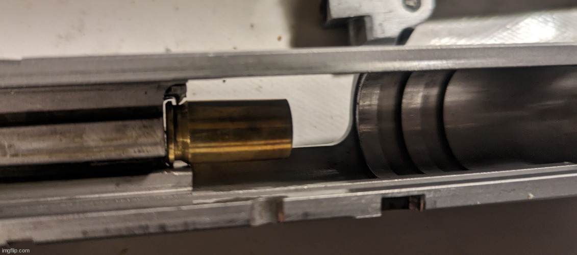

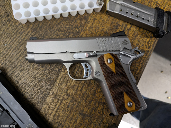

Here's a few pics of the most common issues I had today. I'm guessing that the recoil spring could be part of the problem? The 3rd pic shows it out of battery, and for the majority of shots it was giving me this issue.
My brother was already trying to convince me to return it for service for the thumb safety being so bad, but I thought if that was the only issue then fuck it I'll just replace it with a better one anyways. But with the rest of the issues I'm wondering if I should just send it back and let them sort it out.

First pic is a failure to extract.
Most likely you have a ill fitted extractor Steves Extractor Guide thats FANTASTIC
the problem you describe on the flicking your wrist sounds like a sticking or ill fit disconnector catching the slide. Could be a too light recoil spring.
If you are going to start throwing money at it to fix it without knowing whats wrong I would suggest you send it back.
Your Safety problem is probably easily fixed with a little sandpaper but thats a delicate job and sand the wrong area and you ruin the safety and create an unsafe firearm.
1911s are NOT like polymer guns, you cant just change whatever you want, nearly every part on the gun Normally WILL need fitting for proper function. At the top of that list beyond the normal Slide to frame and Barrel fitting is the Extractor, Safety and Trigger and every part that engages with them.
Yes your recoil spring my be too heavy or too light but you have an extractor problem which is all but guarenteed by the (assumed) fired round still in the chamber in your first pic.
wouldnt surprise me if you have a mag problem too but you need to start with the extractor fitting.
THese are NOT crazy hard jobs but you have to decide if you have the mechanical ability and time to fix it, or if you just want to take the easy route and send it back.
if you decide to do it yourself just realize you will spend some time Learning and may screw up something in the process but when youre done youll have a much better understanding of the 1911 and how it works and how to fix it to keep it running.
The other side to that is since you seem to have multiple problems you might find more problems as you get into it.

I think we need to define terms
A failure to "Eject" can be many things but normally its involving a case that has been fired and has been removed from the chamber not finding its way out of the port. in a 1911 this will most commonly be Ammo, Springs, extractor, ejector
A failure to "Extract" is a fired case that has not been removed from the chamber, which I believe is what you show in the picture.  I would like you to explain the too light recoil spring causing that please. (the extractor doesnt LOSE tension because the recoil spring is too light)  Also explain a Mag causing this please.
Too HEAVY a spring might cause it by not letting the slide operate, HOWEVER if that happens and your Extractor is set up correctly it will extract the case when you manually operate the slide.  (slide will most likely not move rearward enough to TRY to chamber a new round either) Too light will eject the case with more force.
a "Double feed" is two UNFIRED rounds trying to occupy the chamber at the same time, That generally is a Mag issue.

Your chamber likely needs finish reamed and your extractor tuned.
If you’re unable to do those things I would send it back with photos to be repaired.
Also, Winchester WB 115 gr is about the worst commercial ammo available. I would suggest some higher quality 124 gr fmj for your next go around (after repairs are made) and a couple different magazine brands to try out.
Once you get a couple hundred problem free rounds through it you can fine tune recoil spring rates etc, with the ammo you choose.

Gotcha, Ya so It would usually eject so I guess it would be more of a failure to extract. I didn't take pictures of every failure for obvious reasons but most of the time I had to take the mag out, cycle the slide to fix the issue and then reload.
The mag issue is a bit harder because I'm really not entirely sure what options I have because of the type of mag it is. I got lucky and found another RIA branded mag at the range and bought it, but I'm unsure of what mags will work with this because its a 8 round, 9mm mag. Hopefully someone else makes some so I can compare.
Here's a gif that shows the biggest issue. (I apologize for my disgusting hands, I'm a welder and the dirt is ingrained in my pores now lol)
After firing, and then flicking it forward it would fire again assuming that it didn't double feed or otherwise jam.

You may not need to mess with the recoil spring at all. I think you have a tight chamber / extractor issue / ammo issue in that order. I’d wager that if RIA finish reams your chamber, tunes your extractor and you feed it some 124 gr fmj it will run like a top.
Keep in mind however that the shorter the barrel length the more finicky a 1911 platform pistol can be to tune so some patience and trial and error may be necessary.
Also, when you get new magazines load them a few days before you go to the range to let the springs take a set.

you have an extractor problem, and possibly a mag problem. You are seeing the extractor nose contacting the rim of the case, its tension is bad because all it takes is a flick of your wrist to close the slide.
2nd problem is your mag is allowing it to push feed in front of the extractor rather than being controlled by it. You could install a stronger recoil spring and it may solve the problem until you snap the tip off of your extractor which will happen if you keep doing that.
unfortunately I have no Idea about mags, the gold standard in a full size (IMO) is the MecGar and there is a knockoff out there that LOOKS like it but is not on close inspection. Tisas ships them... they LOOK like it until you put them side by side and then .... THEY DONT.  They should work with your gun but they are 10 round and will obviously stick out of the bottom of the gun.
They may also make a shorter mag, someone does, I have seen some place where they actually mod the mags to fit correctly but I dont remember who or where or how much.
Its a short 9mm though and as noted above its going to be more sensitive to everything being correct to work right and be reliable. A full size is easier to tune.
And dont applolgize for working for a living, EVER!
my personal advise to you, Send it back.
If not, I would buy another extractor and practice fitting the stock one but I wouldnt trust it to be right. Then when you understand how its done work on the new one (EGW IMO is the place to go here and for the stop) . I would also replace the Firing pin stop with a fitted one (it controls the extractor fitting). I would do some research on mags and buy good ones. baring that for a quick learning experience buy a MecGar - you can find them online for less than $20 and see if that makes it work. I think your springs are fine at the moment.
Last you should check the breachface and make sure it is SMOOTH and has no irregularities, thats a common issue with 1911s and as the price goes down the likelyhood of that exsisting goes up. especially look in the corner on the Opposite side of the ejection port.  If you see something wrong there, SEND IT BACK and note it when you do. not that you cant fix it but thats a pretty touchy place to start learning on.

I grabbed a few pics, I can't tell if its chamfered enough personally. Let me know if I need better pics.

Ok to here's the latest pictures and an update from RIA's RMA ticket.
I'm now a bit pissed to be honest. My brother had convinced me that it would be nice and easy to send it back for repairs. Well they finally got back to me yesterday. I have to go find an FFL thats open super late or deal with the odd hours/take off time from work to go to the one I used to do the original transfer AND I get to pay for the transfer back to them, because they no longer allow you to just pop it in the mail/have it repaired and returned to your home. They won't even issue a return mail sticker until the dealer sends them their FFL paperwork.
Attachment Attached File
I waited to respond until I could get by the range today to try both the new mag and the 124gr ammo.
The issue with the gun not returning to battery was still going on and the number one issue, followed closely by what I was able to get a few pictures of. As soon as it had a malfunction I immediately set it down and took a pic to show exactly how it was failing. Whats interesting is the round in the chamber shown in these is live. It seemed to eject the spent casing this time but whatever the hell is going on, it would then fail to finish chamber a new round all the way.
I used a box of 124gr Blazer and a mag of Norma 124gr before I gave up trying to get it to run. I was able to get a whole 5 rounds off without failure once before it had another failure that required me to drop the mag and clear it.
One thing that is abundantly clear, is the factory mag is definitely an issue. In the first pic, I was able to show the malfunction and what the seated round looked like in the magazine after I dropped it. Its clearly not seated all the way back and I'm sure that some of the issues are related to these trash ass mags. I marked the factory mag, and noticed no difference between that one and the one I bought (same manufacturer, RIA branded mag)
Link Posted: 8/30/2023 9:09:00 AM EST
out of curiosity, have you checked the chamber to see if its on the tight side?
easy and quick way is to remove the barrel and put a round in the chamber, turn it upside down and see if it comes out freely.  If not, then you should ream the chamber.
if that's fine, then I would look into a new recoil spring, yours might be a bit on the weak side for what you are shooting.

I will agree with Larrys1911 assessment: you have missfitted extractor. On your video, it is clearly shown that it severely clocked to the left, and from the last post it seems that the claw bended to much. Try to tune it per instructions in Larry's post. And maybe  replace with better part from Wilson or such.
Link Posted: 8/30/2023 7:29:56 PM EST
Extractor and shitty mags. Double feeds [NOT fail to extract and feed another live round from the mag] are because the mag is letting two go one right after the other.
It doesn't help you have an Officer length 1911, they can be problematic to begin with. I can truly say the only Officer length 1911 I'd carry is my Colt Defender and even that gets early mags/springs and recoil spring change outs.

Link Posted: 8/30/2023 8:49:41 PM EST
It does not look like it is to me. See this link to get a better idea of what it should look like.
See this is why I love this place. I now understand exactly what you mean. That thread has some great explanations in it, and gives me such a better understanding of the issues I'm having.
I went ahead and grabbed some pics of a round that I fired yesterday, and sure enough theres claw marks on the case in the same spot as shown in the link just not as deep.

Link Posted: 8/31/2023 6:31:09 PM EST
THat looks like there is a mag in that gun? And there is no empty in the chamber CORRECT? and that round is unfired?
As Stated thats a true Double feed.
Next, when you drop the mag does it chamber that round ? If So before you send it back order a Mec Gar mag before you send it back.
Thats a MAG issue.
Next, It looks like I see a pretty sharp edge on the leading edge of your extractor. Pick up one of your empties and see if you see ANY extractor marks other than where its being pulled out.
BTW your extractor fit is bad. Sorry.  Go through Steves guide and fit an extractor and Firing pin stop
Last - the deal breaker on sending it back for ME.
The breachface OPPOSITE of the ejector looks like there is a burr right where the ctg slides up (looking at the third pic from the top) I wish I could post picks I would circle it but I dont have a Pic account anymore.  Looks to be directly accross from the bottom edge of the extractor.  if thats not a photo thing I would send it back with a note thats what looks to be the problem. (other than the mag)
Dont lose faith in fixing it, and dont think that because you buy a "BRAND" youll get away from this, Do a search on Colt, Kimber, Springfield, Customs and Semi Customs.  I do think it sucks YOU have to pay for it to ship thats BS.  Custom 1911 Gunsmiths made their names on making 1911s "RELIABLE" before they started making 1911s
Fix your mag problem FIRST then lets see what happens.

What part of VA are you in, I have a spare 9mm extractor or two. If close enough you could swing by and we could try one. I live near zip 21158.
Link Posted: 10/4/2023 8:07:35 AM EST
One thing to remember about RIA 1911 9mm pistols. The same slide is used for their 38 Super pistols. I had issues of occasional failures to extract or it would extract enough out of the chamber but then fail to eject.
The issue was that the extractor was tuned for 38 Super which has a bigger rim diameter than 9mm. Once I tuned the extractor for 9mm, my issues went away. I have since bought a 38 Super barrel and stick with either Starline 9mm Largo brass or Starline 38 Super Comp brass since the rims are closer to 9mm in size.
RIA use the same recoil spring for 9mm and 38 Super (at least in full size 1911's). All of the OEM magazines for 9mm and 38 Super are either MecGar or Metalform and I haven't had any issues with them.
When it comes to ammo I have found that Winchester White Box usually has slightly smaller rim diameters compared to other brands. Combine that with an extractor that is tuned for 38 Super can and will cause problems.
Link Posted: 10/4/2023 11:18:45 AM EST
Do you have mechanical skills?
If you can answer that as "YES" you can tune an extractor.  you can also replace and tune an extractor. Hell buy one off EBAY for cheap and learn on it then do the replacement.
Have you tried a different brand of mag yet? (I do believe you have two seperate problems )
Frankly as much as you have gone through already I would have gotten bored and pulled out some files and sandpaper.
But if you can be honest and say yes just buy an extractor from EGW, Follow Steves guide. the worst that happens is you spend 50$ and cant fix it yourself, pull the extractor back out reinstall the original one and work on sending it back.
That would explain a lot actually. I wanted to give them a shot at fixing it but since this has been dragging on if they don't make some progress in the next week I'm going to find a gunsmith who can tune it, and just order the parts.
I was actually about to order a bunch of parts including the new mags last week when the control arm on my car snapped like a little bitch so I have been waiting to see what the damage from the tow and repair is before I blow a bunch of money on parts for this.
As some of you suggested I also may just order some parts and try to do it myself, but I was hesitant to do that because I didn't want to void my warranty.

I think you are correct about it being two separate issues, I hopefully will be able to order the mags in the coming week assuming my car repair isn't over a grand.
But I'm not sure I am confident enough in my skills to tune it but I may have to do some research and watch some videos. I have just been really hoping I could get them to fix it as it should never have left the factory like that

Under the assumption that all pictures taken of the slide are directly after use and no cleaning happened I notice, this thing is dry like an old woman. I'm sorry, but 1911 are not designed to run dry at all. New manufacturing tolerances, better materials, yadayadayada, put some grease, mixed with oil on these rails and the barrel tip where the bushing contacts it, and a small dab on the disconnector and run this thing...
Link Posted: 10/27/2023 3:09:35 AM EST
[Last Edit: Seatbelts] [#41]
It may look like that, but it came soaked from the factory in oil and I actually added some Lucas Extreme Duty to the internals before I shot it because I knew there was a supposed break in period.
I did get the MecGar mags in, bought 4 nickle ones and went shooting Friday. It didn't make any difference, the same malfunctions occurred.
