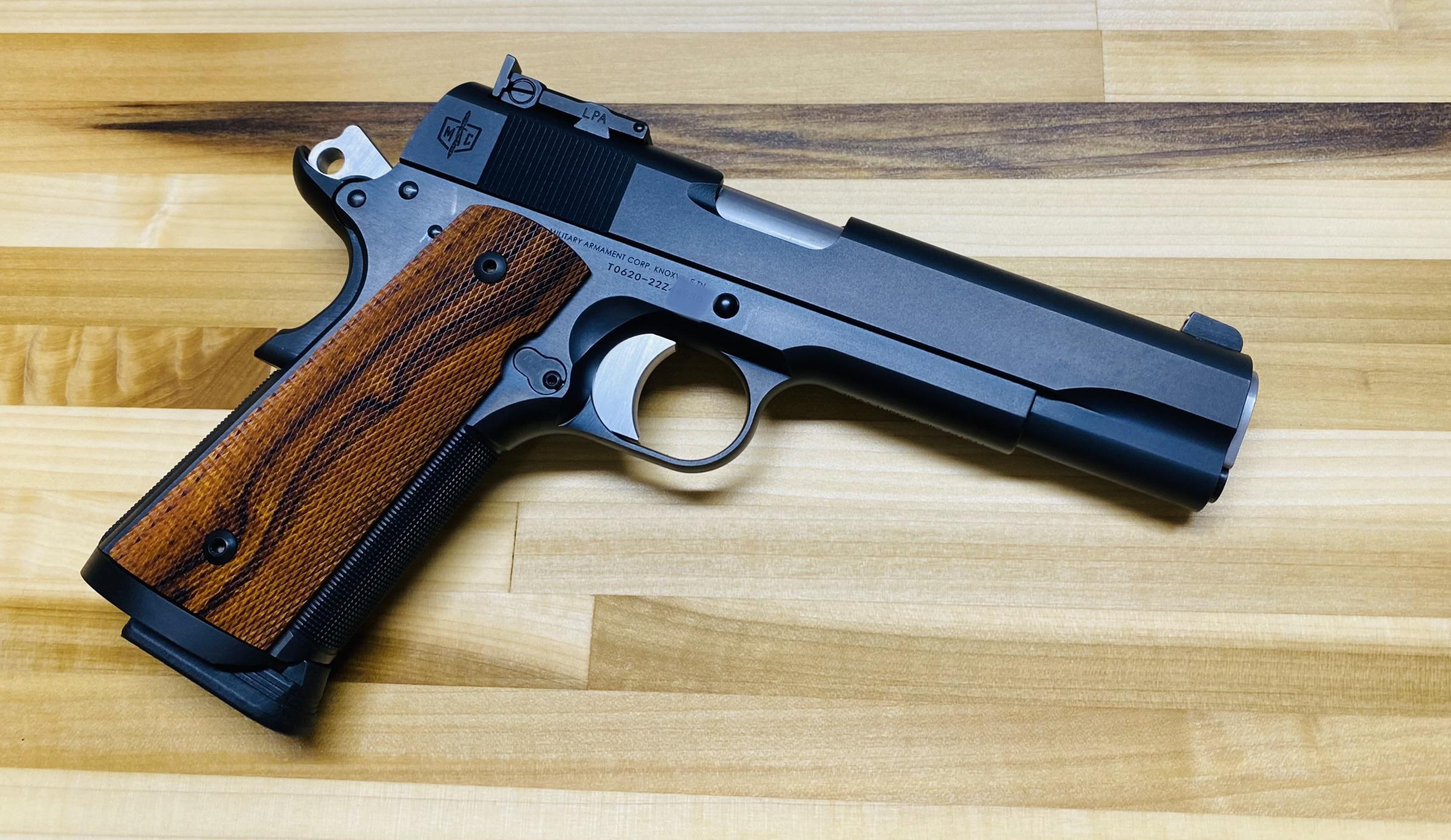

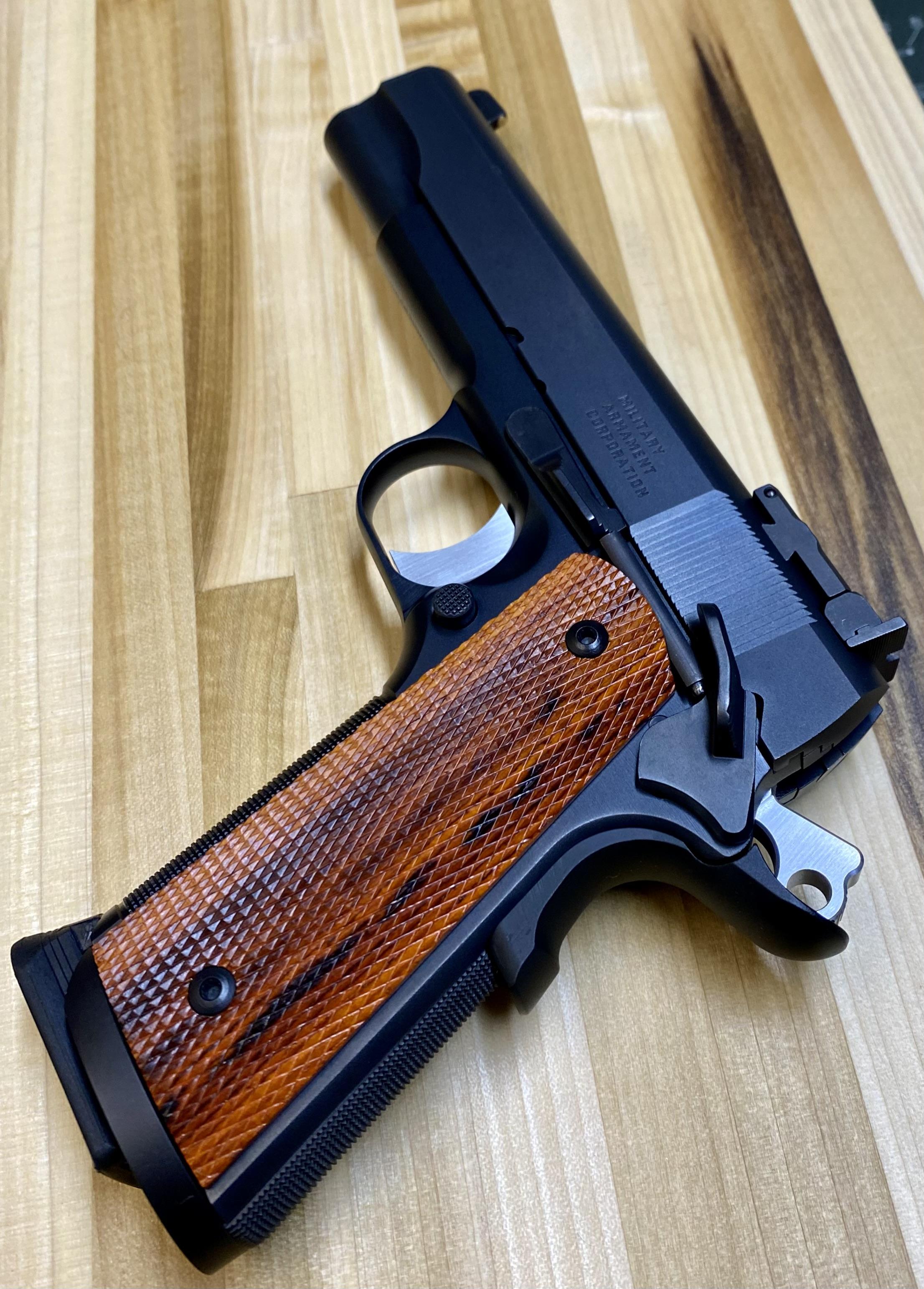

I just purchased a JSOC pistol and after a little rough start by the trigger over travel set screw being set to the point that the trigger was disengaged but after a detailed stripping took the trigger out and fixed it.
I liked what you did with you pistol and I would like to know everything you did to yours internally. |

Originally Posted By af22raptor: I just purchased a JSOC pistol and after a little rough start by the trigger over travel set screw being set to the point that the trigger was disengaged but after a detailed stripping took the trigger out and fixed it. I liked what you did with you pistol and I would like to know everything you did to yours internally. View Quote No problem: Harrison medium trigger, fitted, permanent over travel file fit. Trigger track stoned / cleaned up. Extreme Engineering sear, disco and hammer all modified, hammer slot stoned. EGW thumb safety contoured and fit, EGW magazine release tuned, EGW barrel bushing fit, EGW spring plug. 10-8 Performance guide rod and slide stop fitted. Breach face and disco track polished. Wilson Combat extractor with geometry corrected, tension set to 30 oz and fit with a Harrison FPS. Harrison hard pin and small part kit. Barrel fit / lock up checked. Main spring housing internal honed. Barrel feed ramp / frame feed ramp polished. Barrel finish reamed and break over angle polished. Basically went through the entire Hilton Yam 1911 duty tune video minus the exterior mods. It has 1200 rounds through it now and runs like a sewing machine. Hope that helps. |
