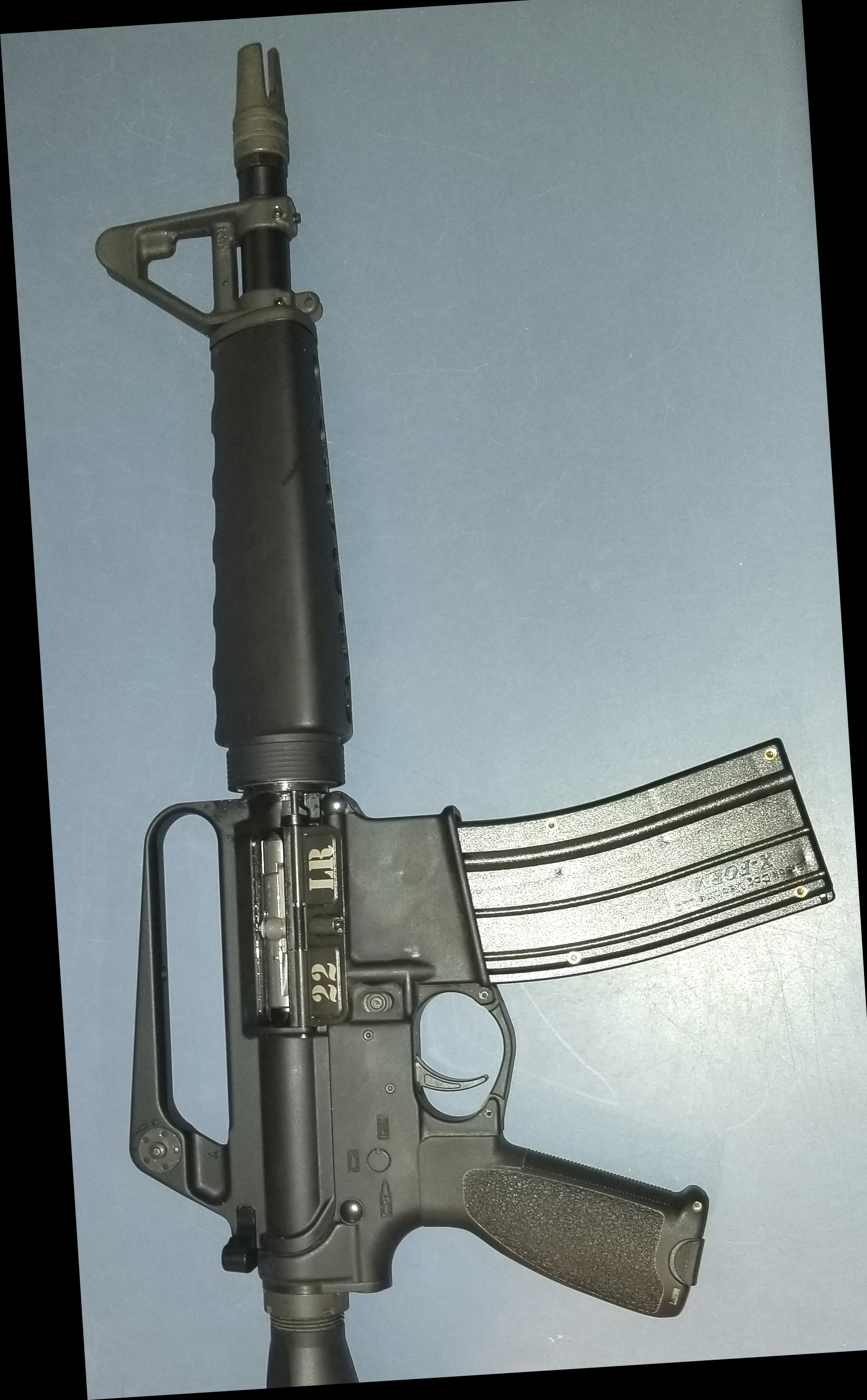

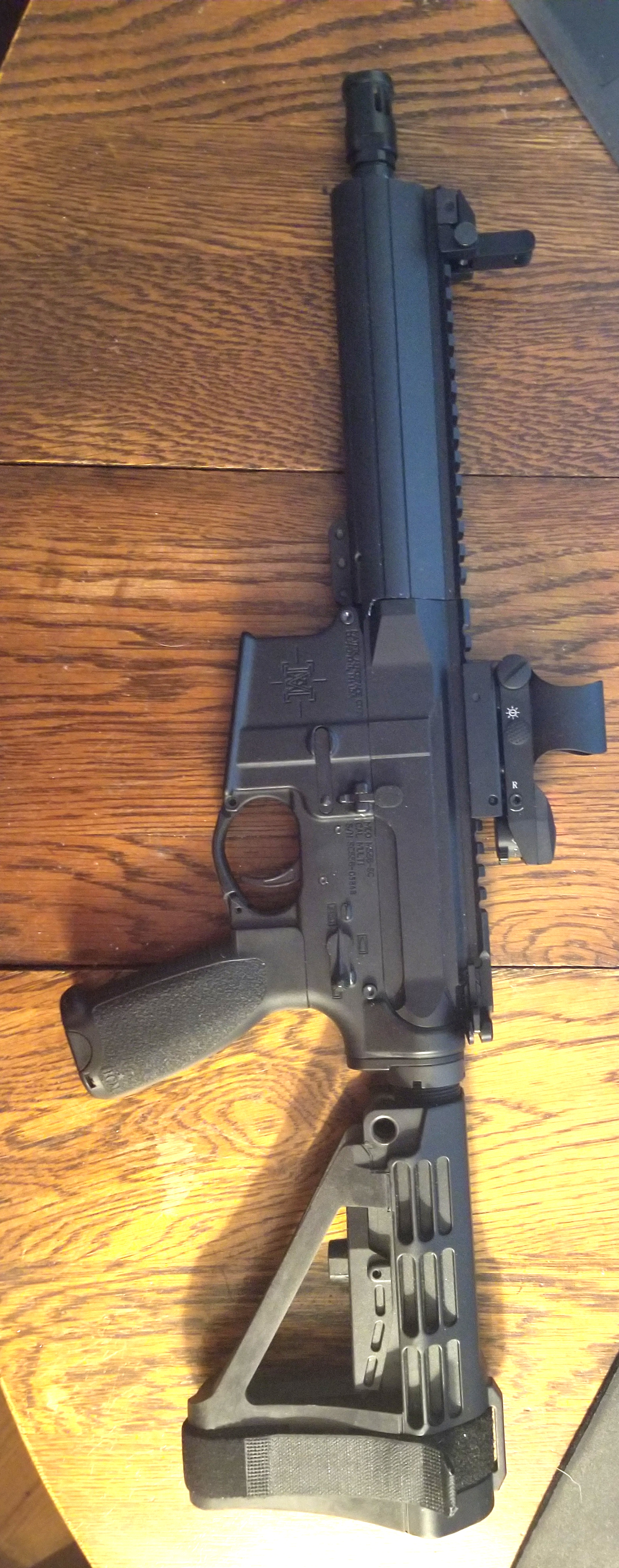

Originally Posted By GrimEReaper: Rtb bolts and barrels are great. I use Black Dogv mags however and the McFadden speed loader. I can load a 25 round mag in seconds. I love my 2 RTB .22s Never mind the scary braces. I melted them down into prophylactics. https://u.cubeupload.com/Jpatnorman77/IMG20230121102833.jpg https://u.cubeupload.com/Jpatnorman77/IMG20230215162847.jpg View Quote Beautiful pieces! We appreciate your trust and confidence in choosing our parts for your builds. We have a lineup of new .22LR Uppers scheduled to roll out before the end of the year. One of our main goals is to make the .22LR platform more accessible to the average AR user without sacrificing quality. |
