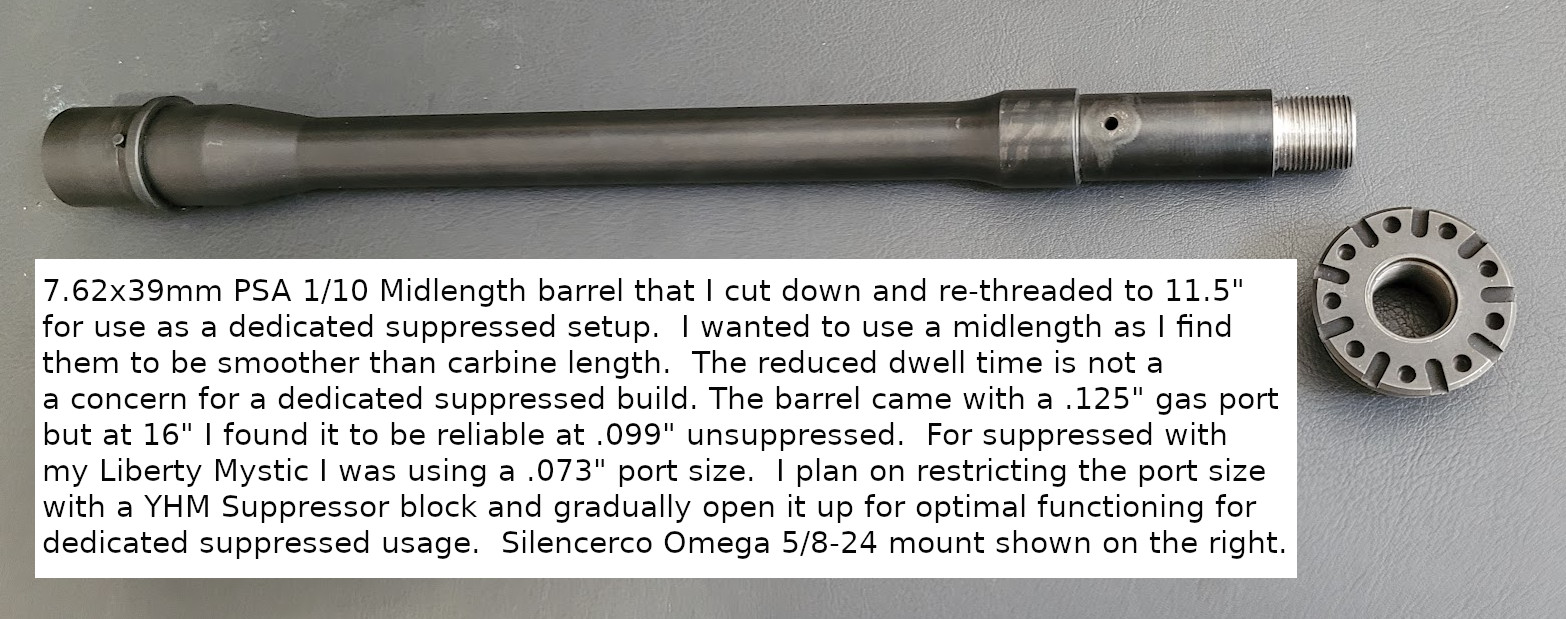

I coincidentally just did this a few days ago:
Haven't shot it yet but I'm sure it will be fine.  It may not run without a can but don't really care as I plan on using it 100% suppressed.
If you want a 10.5" PSA has them.
https://palmettostatearmory.com/psa-gen2-ks-47-10-5-carbine-length-7-62x39-1-10-nitride-barrel.html
I'm sure it will be overgassed for a dedicated suppressed build though.  Some people don't care if their gun is overgassed as long as it is reliable so maybe you don't do anything.  I personally like my stuff tuned and to run as smooth as possible.
