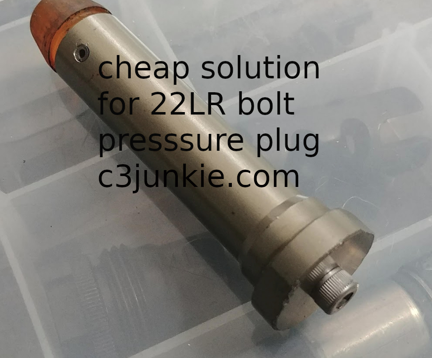

My cheap solution:
Link Posted: 4/21/2023 10:58:44 AM EST
I used a piece of oak dowel.

I've broken two end plates... I lathe turned a rebated step in the edge of the buffer, so that the center of the buffer protrudes slightly past the retainer pin, into the lower... no problems since , and I can switch uppers on the SBR without messing with the buffer

Lots of good solutions.  Keep ‘em coming guys.  I especially like the suggestion of turning a ledge on the front of a stock buffer.  Took my offending dedicated lower to the woods this morning with the $.26 solution and Shot 80 rounds +/- thru the 22.  No misfires. Before would misfire one or two every magazine. 👍👍
