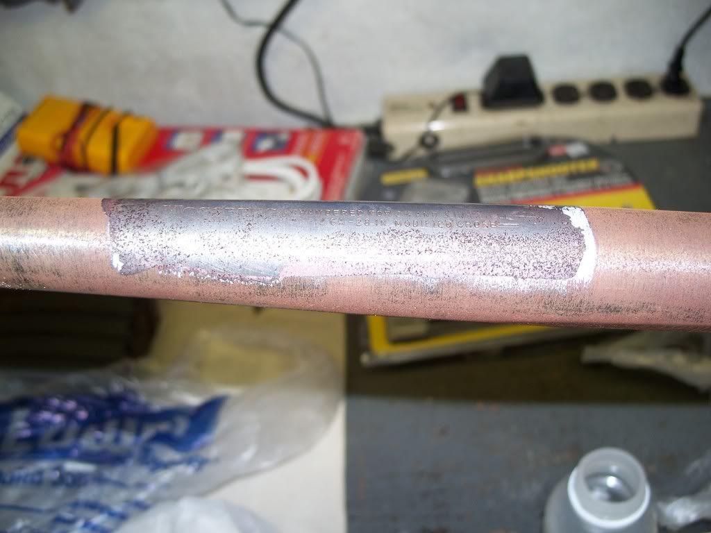

it looks like Naval jelly works too .
That gets anything off of everything. I did a shotgun a little while back in Colt Gray. I want to change it and do the broom straw effect that is Tacked (that's bad ass). This is the old barrel when I pulled the shot gun out of my uncle's attic from years of storage. Naval jelly cleaned it right off. I did the 28 inch barrel and the 18 inch barrel.
Here (middle) its refinished with some parts from Havlin Gun Parts (trigger assembly and some others.
It's been coated about 8 months. I just did a little patch as a test a few days ago and it came right off.
If you try it later, Just remember to wear a respirator those fumes will kill you (seriously)
perimedik  [Member]
I'm gonna strip the both barrels and the receiver this weekend so I'll post pics maybe it can help others.
Check these out (BTW the logo looks like a Bolt Face )
A little bit of elbow grease with a nylon bristle brush in the tough parts, then the Carb cleaner to degrease at the end and presto...
Hope it helps someone...
