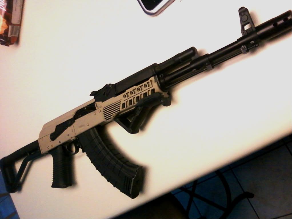

Still need to weld up the holes and to a complete refinish but here's my 5.45 Saiga:

kar98k  [Life Member]
Nice job.
