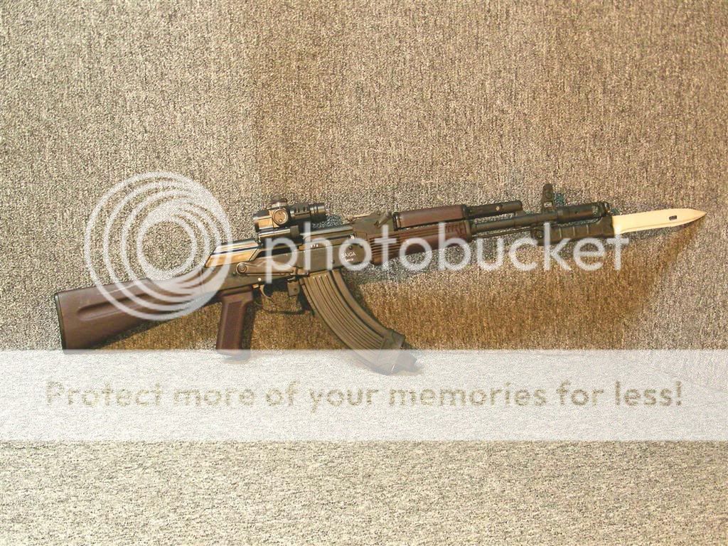

Restored Saiga x39. Actually my favorite AK in the safe right now. Spent about 2 weeks on the restorations and modifications.
