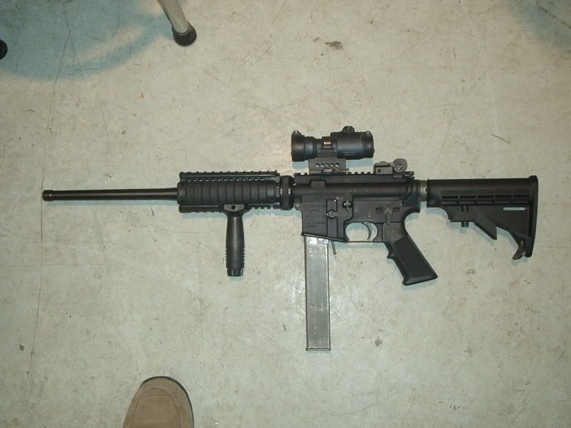

Here are two more spin offs. First is a .45 GAP upper receiver I made last year using a Thompson SMG barrel. I had a local machinist take a few thousandths off the chamber end till the chamber was the correct depth for the .45 GAP round and the cut new threads to match an Oly barrel extension.
Fire from a Sten mag like a raped ape.
Here is a prototype of a lower that uses WWII Reising SMG magazines. Concept works and I am having a dedicated lower made from a forging for Reising mags. Only real issue is the cost of mags. About $60-$80 a piece. Factory mags are 20 rounds but a guy named Ken Christie made a limited run of 30rd stainless steel mags.

.45 ACP Hollow points can be fired from Sten mags in a pinch. FMJ are too long without modifying the mag. Just needs a Sten magwell block and open up the feed lips a little.

Hmmmmm......... .45GAP using STEN mags, huh? great idea. If I didn't get one of the first CNC/Khalan AR45's and now having 17 GG mags, I'd have you set up an upper to go that route.
