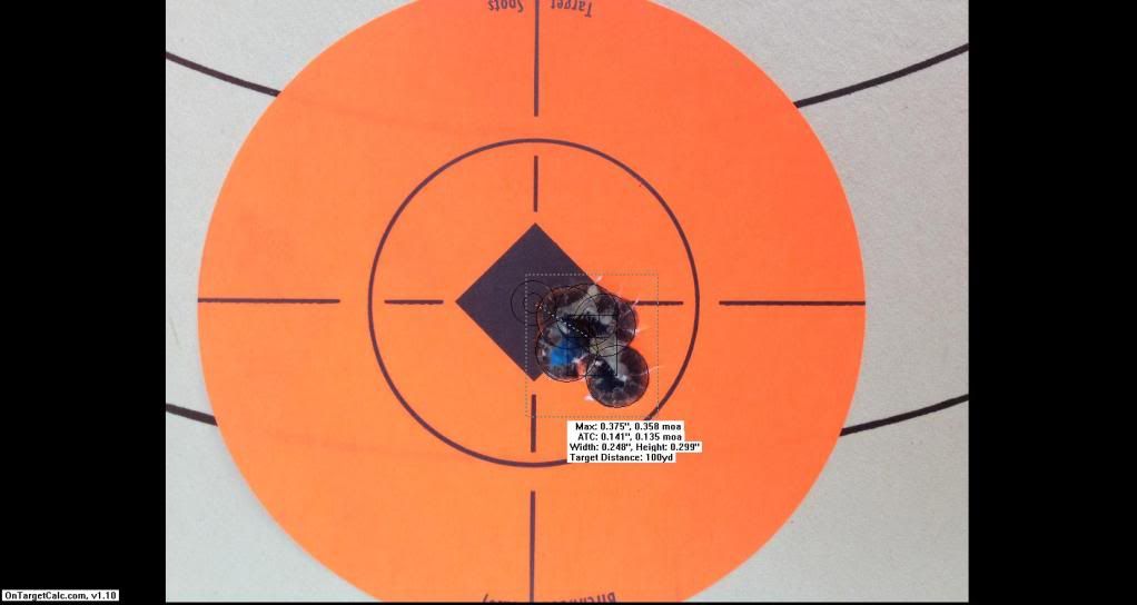

Update. Best group so far. sub moa every group but heres my best.

Finally got to shoot mine today. The gun is capable of much better, it seems that I am not however. Guess I need to shoot more.
100y shooting 168 FGMM. Prone from a bipod.

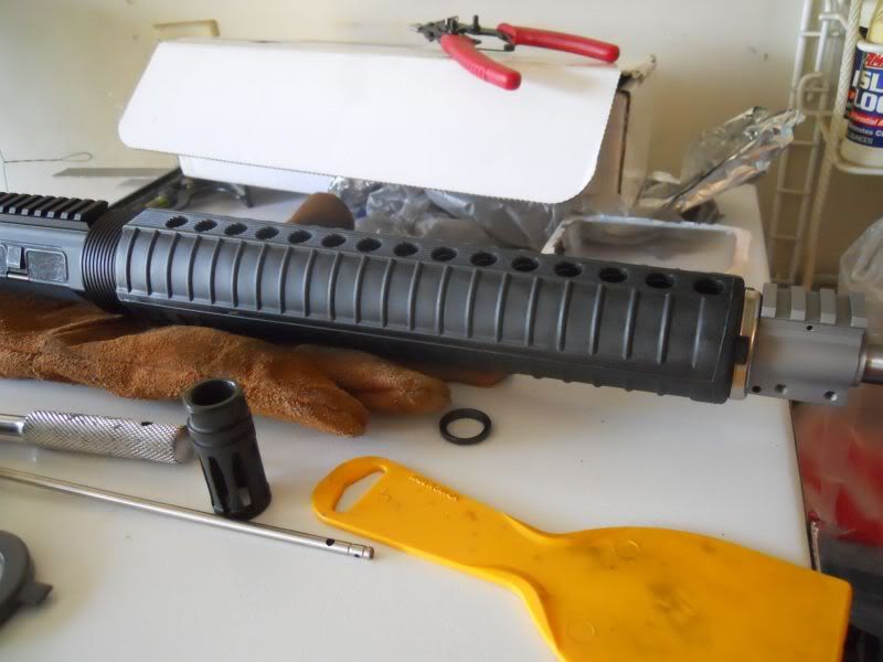

Thanks to everyone for all of the information and tips, very helpful thus far but I am having gas tube insertion issues. I purchased an AR-10 gas tube from Armalite and neither end will go through the upper's hole. I already have the barrel seated (incredible how tight the fit is) so drilling it is going to require a long bit that I do not have. I'd prefer not to drill. Do I need to purchase a special tube or what?? Thanks in advance.
Brahmzy  [Team Member]
Pictures? Do not drill anything. Gas tubes should fit fine, if they don't you're doing something wrong. Need more info.
QwikKotaTx  [Team Member]
I can take some later but the problem is pretty straight forward. The delta ring and barrel nut all line up fine, I can get the tube past them and up to the hole at the front of the upper receiver but it will not go through from either end. I've put several AR-15's together and it is always pretty loose there.

I spoke with Jason at Mega and he states he has not heard of the issue with a gas tube not fitting but to try tapping it in. I'd prefer a non-interference fit but after the head of it goes past it will be a smaller diameter. He also states not to put the upper in an oven but to use a heat gun on the barrel nut thread area. Armalite barrel extensions are apparently the hardest to fit but even a hair dryer worked for him. I had the upper in a 250° oven for 20 minutes and barely got the barrel in. A lot of tapping with a rubber mallet. Scary.
Edit: It went in fine today for some reason. I doubt it had anything to do with the upper being hot or the barrel being cold yesterday but after a little rotation (no tapping) the gas tube went in with minimal force. Also installed the SSA-E trigger into the lower. Should be functional by the weekend.
I confirmed that a standard handguard set will work with the Mega upper in case it needs to be added to the FAQ. Using the Armalite delta ring set, handguards and gas block with front handguard cap mating a DPMS barrel nut will adapt it all to the Mega billet upper. Most will ask why use this low end setup on a high end upper and I give the same reason for owning lots of guns, why not. That and this gives you the chance to shoot while you wait for LaRue to make a rail setup that WILL fit.
Parts:
Mega Ma-Ten Upper
Armalite 20" NM SS Barrel
Armalite Delta Ring/Spring/Slip Ring
DPMS Barrel Nut
Armalite Rifle Length Handguards
Armalite Handguard Cap
Armalite Gas Block and Gas Tube
